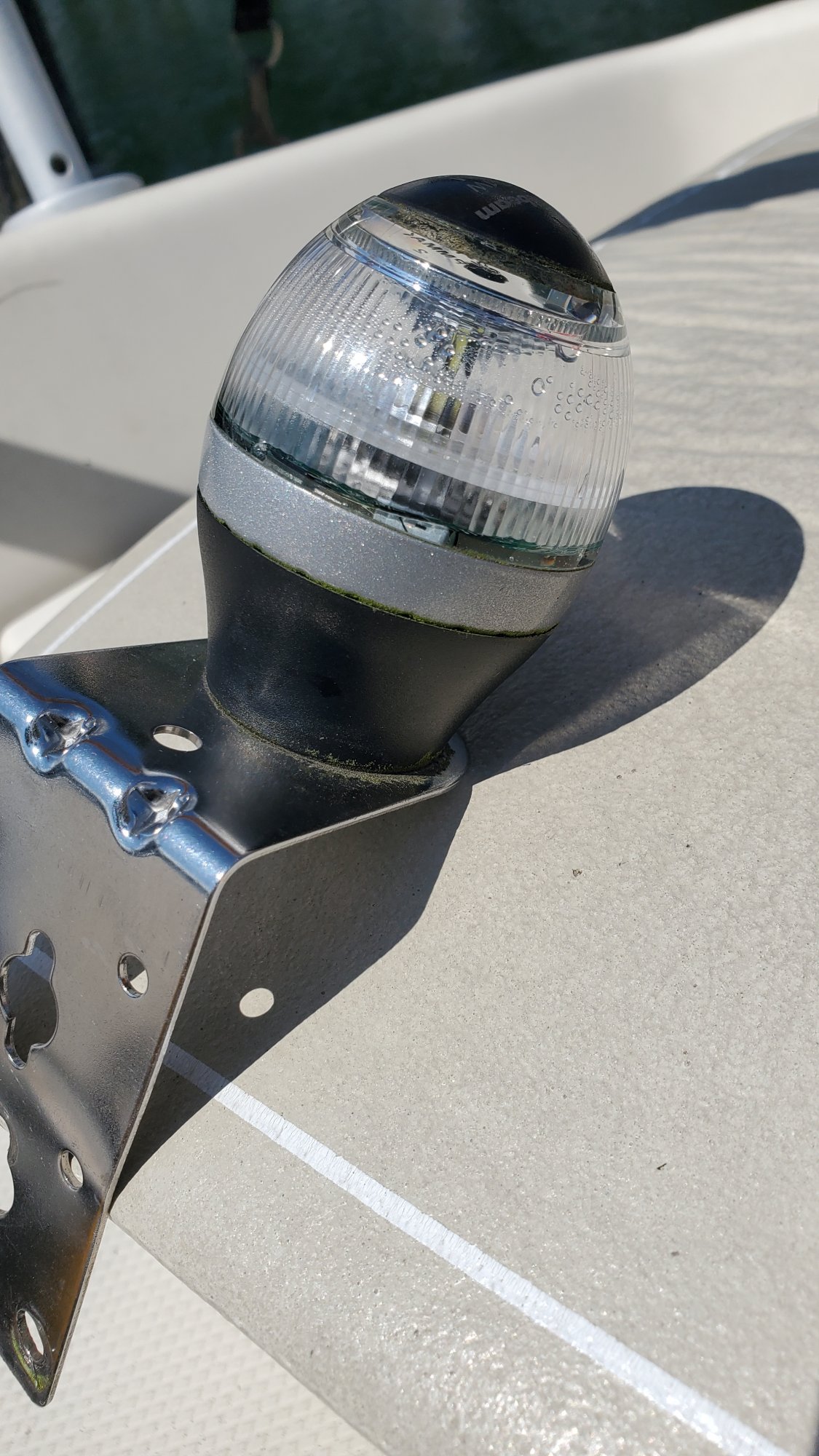

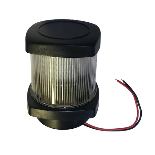

Marine beam, that is a reputable company, offers one that is sealed & USCG approved as well as an economy series that is comparable to Hella & Aqua Signal and at a significant discount as compared to Beneteau.Anchor_2_AA__30976(2).jpgAnchor_Light_Black__10682(2).jpg

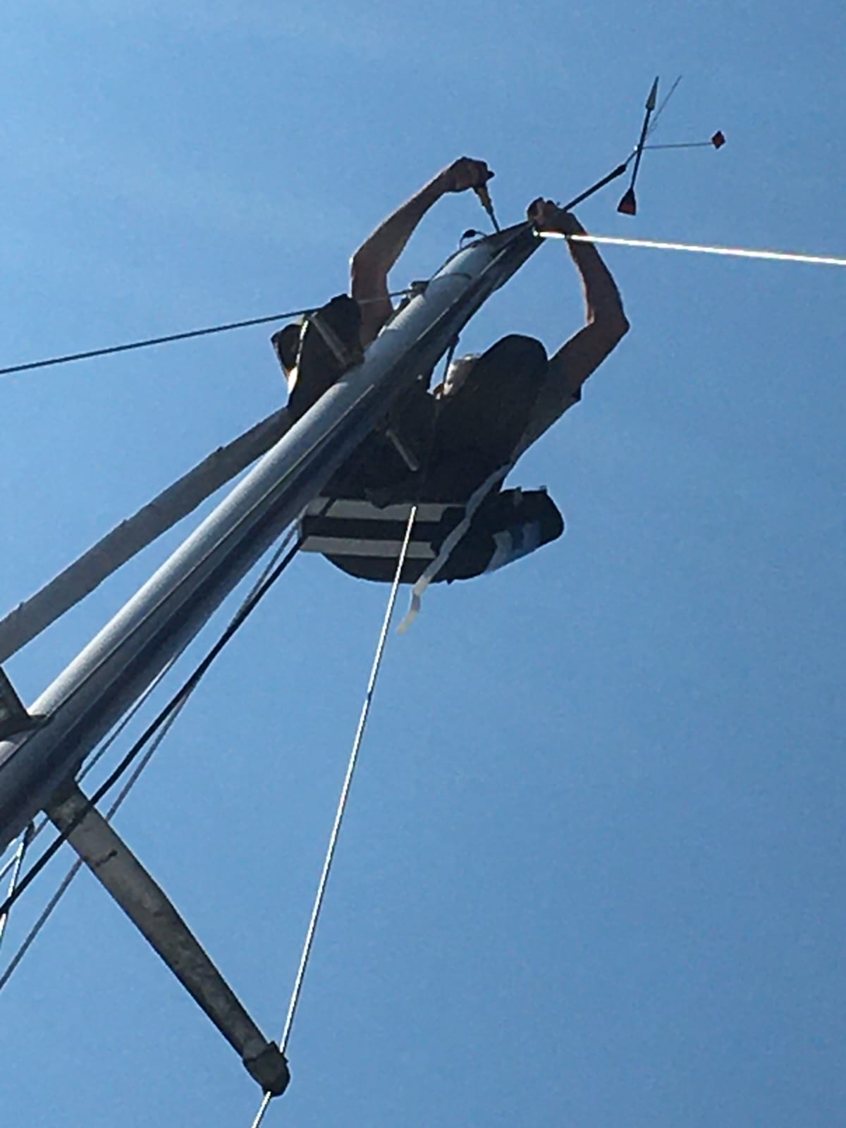

A word of warning on Marinebeam. I've had 2 of 3 fail now. The bicolor bow light failed last fall. I was wondering why all those boats were honking at us as we approached Bell Harbor just after nightfall :biggrin:. The second was the anchor light, which I found as we anchored the first night out on a 3 week trip earlier this month. My steaming/deck light is still working.
I figured the first was perhaps my fault. There was water ingress. Maybe I whacked it with the anchor or something? Then I climbed the mast last week to replace the anchor light. There was a little bit of condensation inside, but no visible damage.
Both lights were installed in the spring of 2019. 5 years of service for LED lights at $100 a pop is well below my expectations. It's not like the lights get daily use. Since they are sealed units, it's pitch and replace.
I contacted Marinebeam and this is what they said, in part: "Overall we've had very good longevity in that series of navigation lights but have found that over the years some northern climates have tended to cause failure due to temperature swings."
They asked if I bench tested the light. I did and reported back. I requested a replacement. Crickets since then. If I do hear back, I'll post an update.
Regarding tools, since I was just up the mast, it's fresh in my mind. Here's what I used:
screwdrivers - flat and phillips
small Crescent wrench
dykes
wire stripper
crimper
heat shrink butt splices
heat shrink tubing
small butane torch
electrical tape

As @Davidasailor26 mentioned, you can check on the spare parts sight to determine what fixture was used & purchase an LED bulb only.
On my vintage (2006), Beneteau used Hella incandescent fixtures & festoon shaped bulb ends. If you are set on replacing the entire fixture, there are multiple options to consider depending on price & quality.
Marine beam, that is a reputable company, offers one that is sealed & USCG approved as well as an economy series that is comparable to Hella & Aqua Signal and at a significant discount as compared to Beneteau.View attachment 226691View attachment 226693

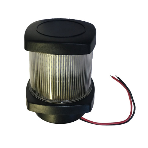

Something to consider. I recently replaced my Aqua Signal (25 size) fixture with the Marinebeam fixture pictured here. I found that the masthead casting on my 92 First 310 was cast with precast and tapped holes in the pattern that fits the Aqua Signal 25. The Marinebeam fixture pictured here has a pattern that is "wider" than the Aqua signal 25 fixture. So, I had to fabricate a plate to bolt to the masthead casting and then bolt the Marinebeam fixture to the plate. It was a PITA. As my mast was down, this was not a terrible problem but I can't imagine doing it at the top of the stick. If your Aqua Signal fixture is sound, I'd recommend just replacing the bulb with the festoon end LED equivalent. Marinebeam has those and can supply. Or, find a replacement fixture that matches the bolt pattern of the OEM Aqua Signal 25 - I could not find one. Picture of mine after replacement attached.
