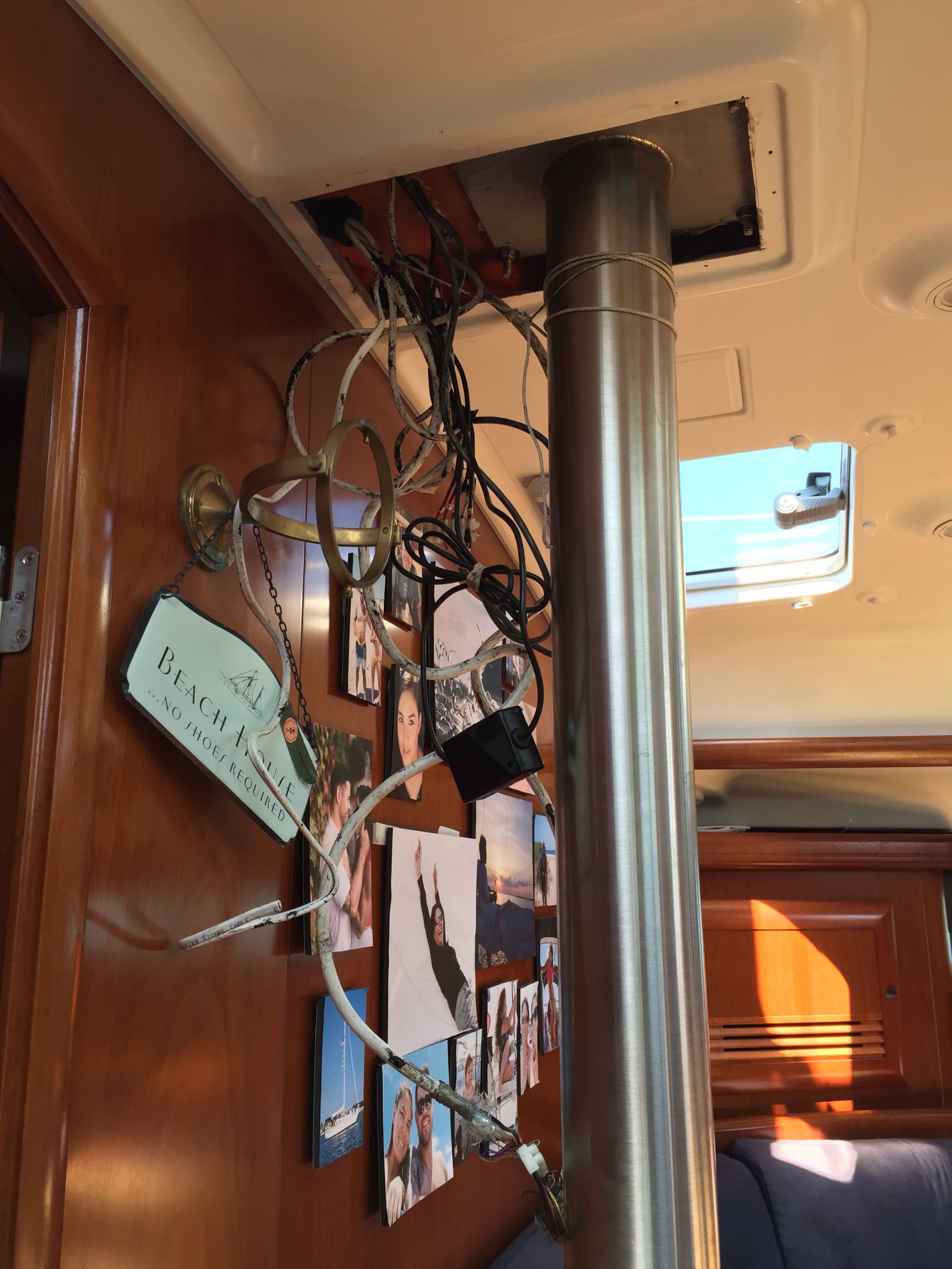

so my bulb was burned out..... climb up and find I'm getting no power..... have power at the breaker. question: is there any electric buss for wires going up mast? Inside boat, the wires are all jumbled and no buss other than the wind instrument. Haven't pulled wires out of mast yet. Would think there would be incase one wanted to remove mast.

Yea there is no junction box for electric wires.... for wind there is. Would o lay be logical to have a junction box. It is actually a mess..... looks like someone with little patients or pride did the work wiring the mast.

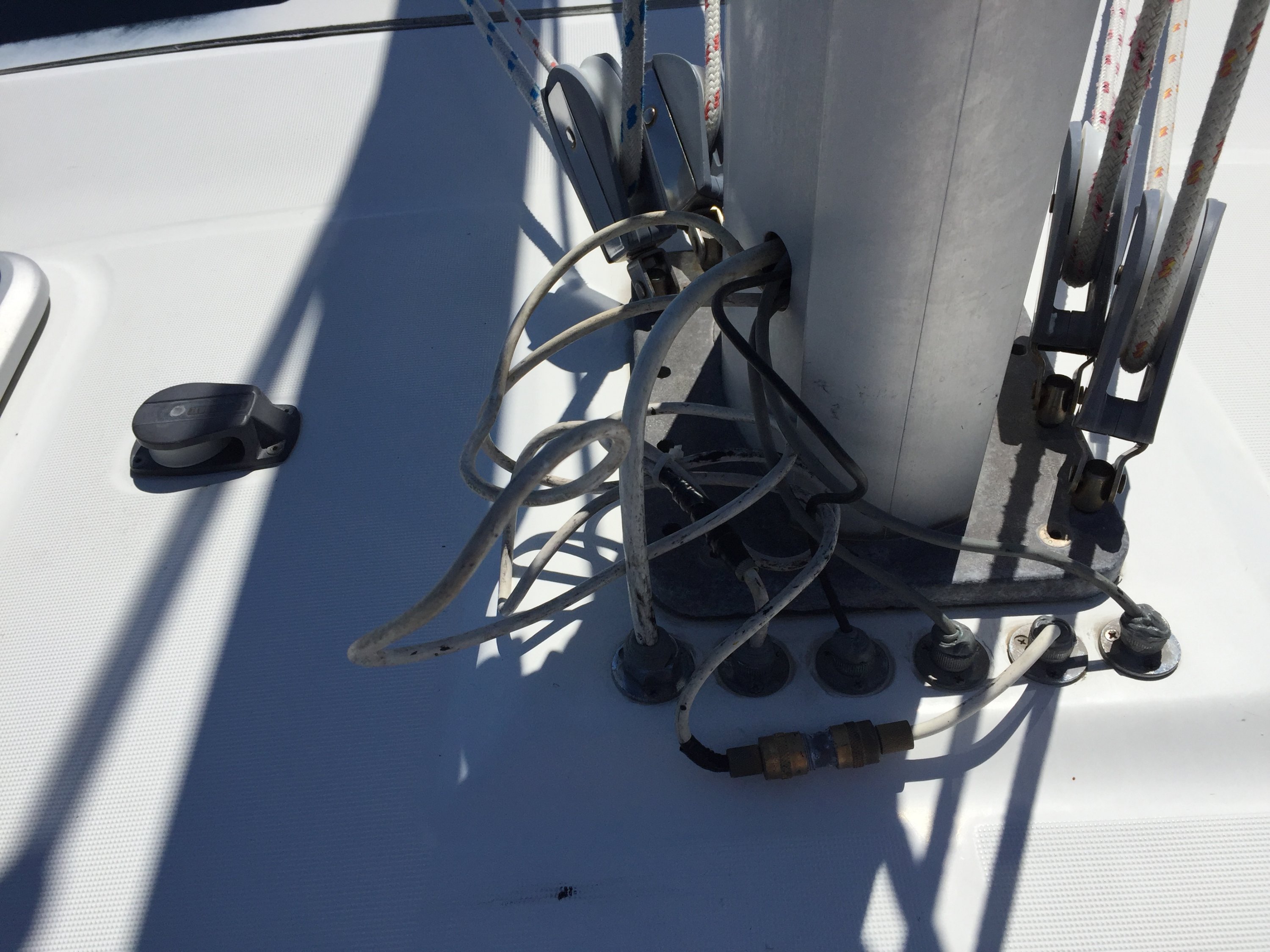

NYsail, Really? no junction box? what do you have to do when you drop the Mast? Cut the wires? All my mast wiring is routed so that it exits the mast above the deck and goes below through weatherproof fittings. Simple matter to disconnect when the mast cones down. Just a few minutes to re connect when it goes back up.

Doug... tell me about it. Very strange indeed. Guess none of the previous owners (2) dropped the mast?? Unless everything is cut outside at the deck and tucked in the mast...... that would be nuts. My vhf radio connection and tv antenna connect outside. I am planning on a full excavation of the wires this weekend. Boat is new to me this season and finding all the hidden little gremlins keeps me awake at night reading. Also, I have to replace the weatherproof fittings as a couple of them leak. One other crazy thing, not only the wires a jumbled mess in the cabin top before going through the deck, the wires are covered with a black tar like goo that is real nasty. I'm going to have some fun this weekend!!

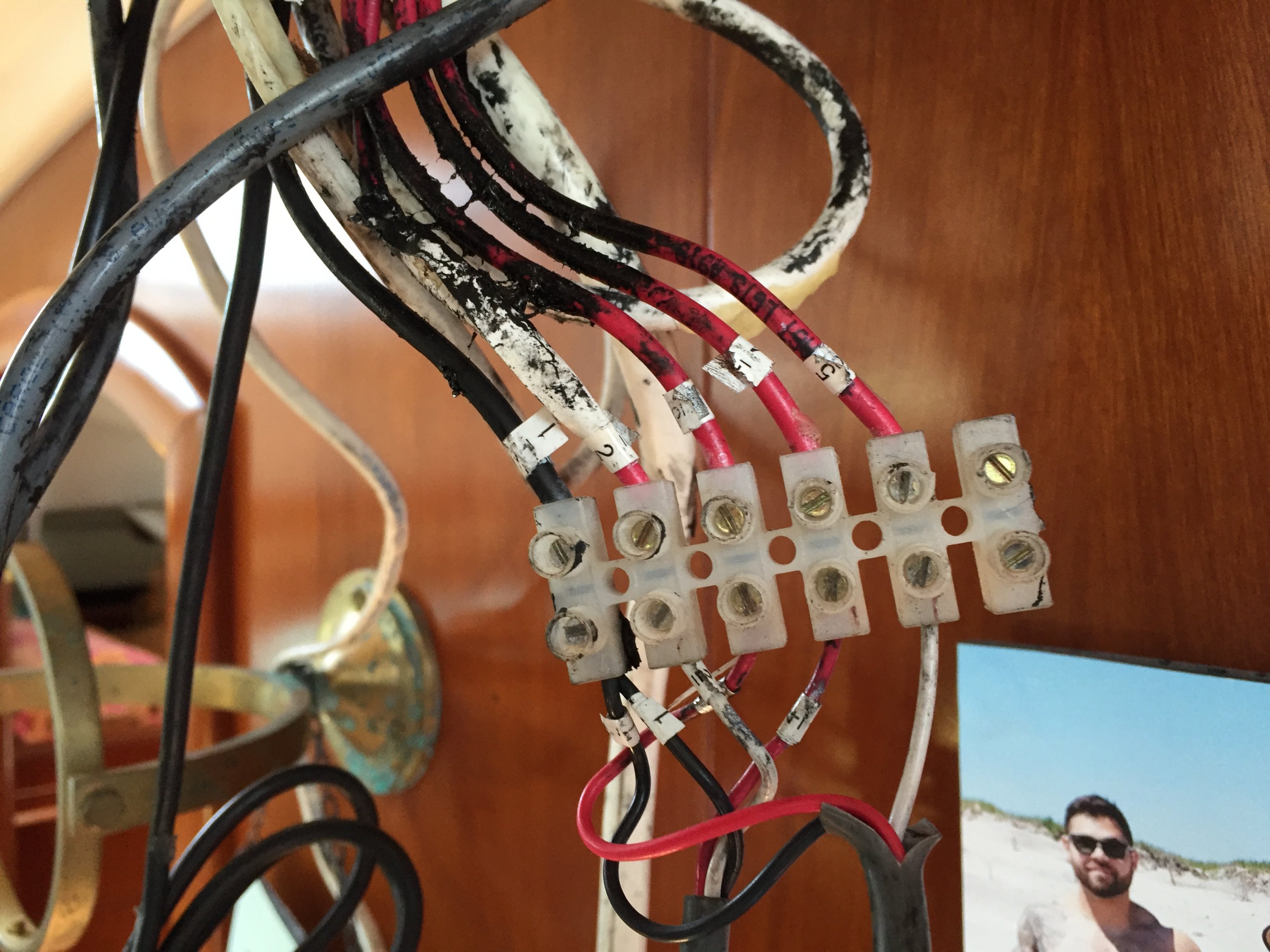

Ok so found the splices.... in cabin. A complete mess with a tat like stuff all over the wires. I started splicing and cleaning wires this weekend. And untangling..... Don't need all this wire so will trim some off. And also found my anchor light..... had corroded off. Replaced. However there are two hot wires that go up that I can't trace or figure out yet.... one has a constant voltage of .3 even when I turn off D.C. Panel. Not good I don't think

I can deal with the connectors (change them)...... it's the black tar like stuff stuck all over the wires. It's like a bad joke.

Have the same gooey mess on my boat. Looks like the factory tried to use liquid electrical tape to stick the wires to the cabin top when the liner was assembled to it.
That junction block in the photo contains the common ground. look at the red and the white to the right of the common. It almost looks like they are touching, and there could be a wire "whisker" there that is the source of the voltage trickle.

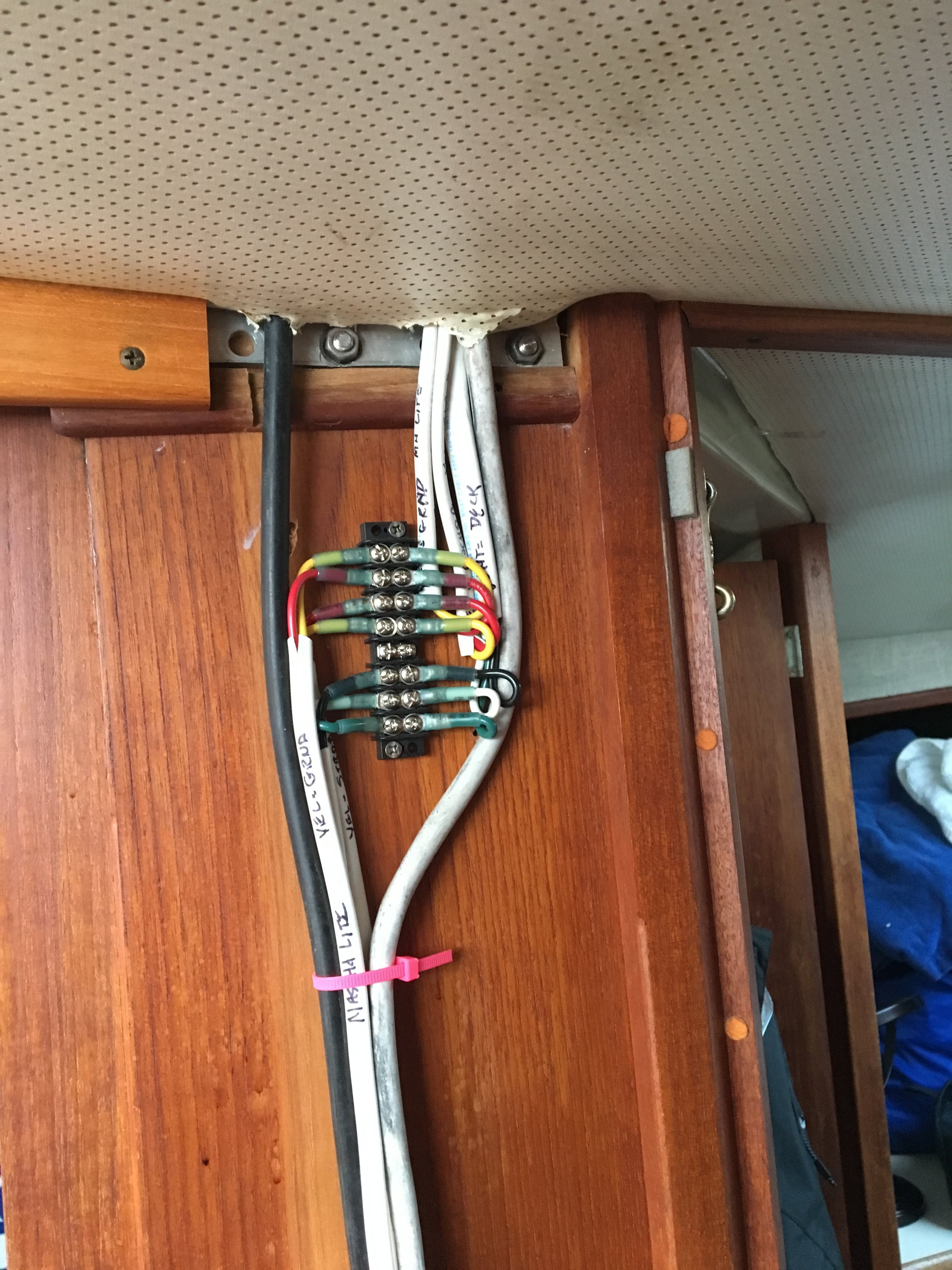

NYSail. Here is the finished wiring on my compression post after the mast refit last year.

Now that's pretty! I plan to rewire my mast over the winter. My antenna is just twisted together with a piece of black tape over it.... the deck connections for my vhf and antenna look just as shabby...
