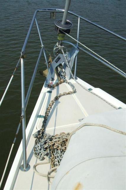

The picture shows our old Bruce with 1/4 in. chain and the new Rocna with 5/16 in. chain. Bad picture, but the Rocna has the cleaner chain and the old smaller chain is tucking into the anchor locker. They are visually diffetrent in size even with this poor picture.
With our anchor SYSTEM designed for 42 kts., 1/4 in. is all we needed and I subsequently removed the 5/16 and used new 1/4 in. on the new Rocna.
