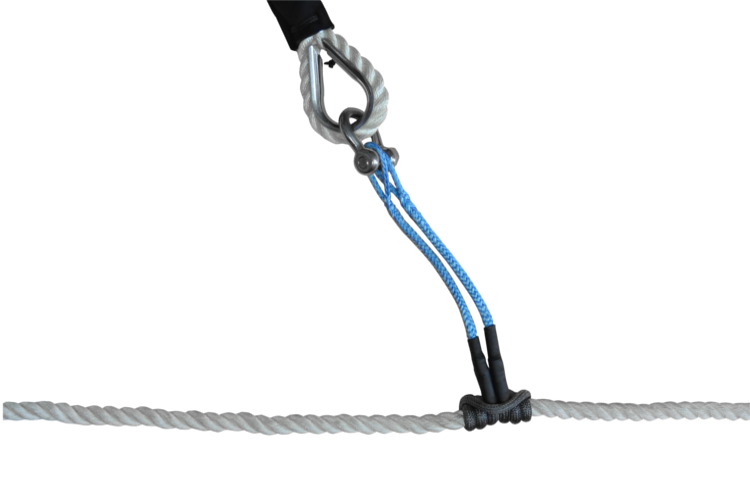

Wondering what people use for an anchor bridle for the 310 with all chain anchoring? I have a one-piece Y shaped braided bridle that is 5 ft long with a mantus chain hook that I have used for a few years with good success. It is 5 ft long because that is the length that Jesse recommended based upon his experience. Have been anchored in 40 knot winds with no problems. Just wondering if the bridle shouldn't be longer than 5 ft to provide more stretch and in case we get caught in winds >40 knots? Have seen commercially available bridles from 14-24 ft in length and even longer than that. Having a bridle almost as long as the boat does not seem to make sense to me and sounds unwieldy to handle when setting and retrieving. Maybe this is just a solution looking for a problem?

Mine is the middle size. For your boat I suspect the Small will be fine.
Their lines are 3 strand nylon. Plenty of stretch my boat handled an overnight with the storm blowing 30-50 knots. I was on a hundred ft of chain plus the 26 ft of bridal a year ago. Nylon 3 strand has 20% stretch.

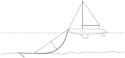

Will is absolutely correct. The all chain rode you get a catenary effect. The challenge comes as the winds build and the chain lifts off the sea floor. Then with each gust you get the chain stretched to the end and a tug against the boat. You need something to protect the boat so the chain doesn't yank a cleat off the bow or worse the windlass where the chain is wrapped. That something is a snubber or a bridal. The snubber is connected to the chain and then tied to a secure fitting on the boat. (Cleat of Samson Post)
Catenary Effect
Because of its weight a chain rode will sag in light to medium winds requiring significant energy to straighten it out. This catenary effect provides excellent energy absorption.
co4
The energy required to straighten the sag in the chain is called catenary and this in turn provides excellent energy absorption in light winds (up to about 20 knots). The sag in the chain also gives the rode a good angle of pull on the anchor.​

Similar to the above with all 5/16" chain, I use the small Mantus on our 33' boat; but, decided that the Mantus chain hook was just to darn ungainly making it potentially dangerous for our use. I replaced it with the Mantus Snubber Pendant and connect it to the bridle thimble with a 3/8" dyneema soft shackle. If ever needed I will cut the soft shackle and retrieve the bridle much quicker than trying to take the chain hook off.

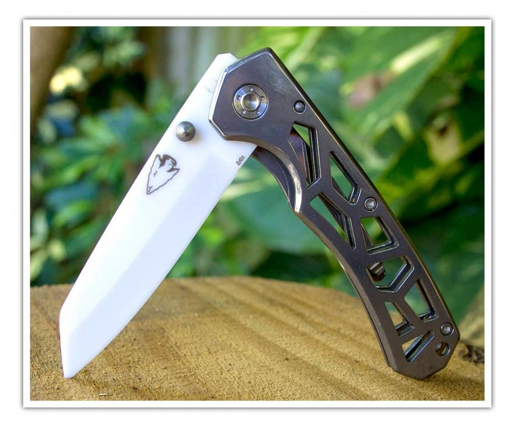

In a hurry, you may need something very sharp and able too withstand the blunting effect of dyneema on steel.
Might I suggest.
A ceramic blade riggers knife
I have found them great on ultra-high molecular weight polyethylene (UHMwPE) fiber.... Dyneema

Thanks all, I just ordered a bridle from 48 North that was on sale and more reasonably priced that the mantus version. I have a second mantus chain hook that I will attach to this. Will still use my 5 ft long bridle since it is so easy to use but this 18 ft long bridle will be handy if the winds pick up beyond 20 or 25 knots.

Yes me too. I got the 5/8" bridle at 18 ft long for $135 + 28 for shipping. Should be perfect for use with my mantus chain hook.

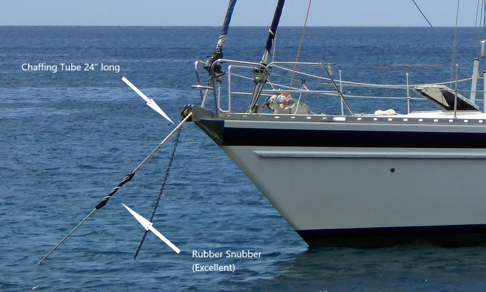

Snubber line for 31Ft boat = 40 Ft X 3/8” (1/2”)
I followed this info and everything worked out really well ...... I'm on the Great Lakes System.
