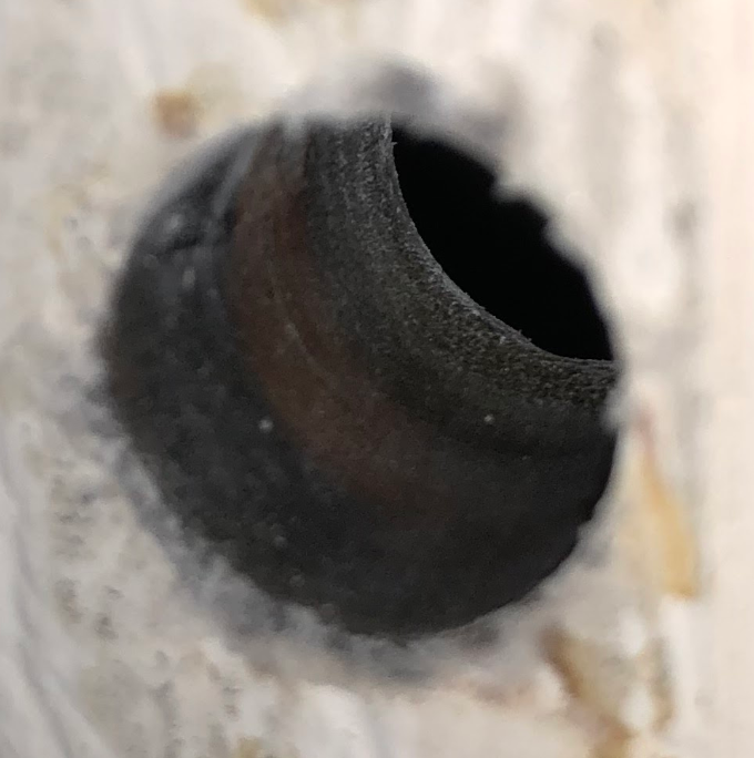

Strange but interesting-- I had asked a question previously about overdrilling/ potting the 1/2" holes for the upgraded chainplate eyebolts. Theoretical concern was you drill a 1/2" hole, you fill it with epoxy-- then you drill it again... what's the point. I decided to expand (hog out) the topside significantly-- but wasn't willing to do that to the deck and below.
I charged ahead willing to see what I ended up with -- 1) hard to take a picture of a hole
2) appears opaque -- aka: a good coat of not wood.
from the liner looking up toward the deck:

indeed- I have attempted to follow @mainesails advice relative to bedding. I have to admit the larger 1/2 holes with a 1/2 bit pretty much took that stopping option out of my hands. I attempted to come up short on the liner but no chance. And with that larger of an opening already I was not a fan of opening up the deck any more than necessary. This was my compromise.....
Typically when potting holes you drill bigger say 3/4 hole fill then redrill your 1/2 into the epoxy filler it is supposed to create a watertight ring around the bolt so water will not soak into the core if your bedding fails.

Makes complete sense, I did both (overkill) overdrill and dremmel fill and drill
