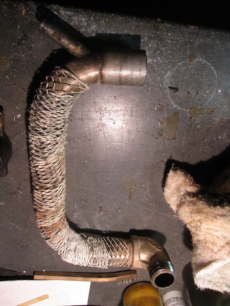

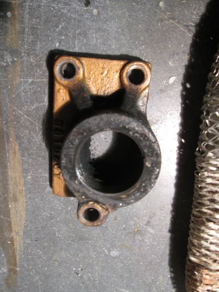

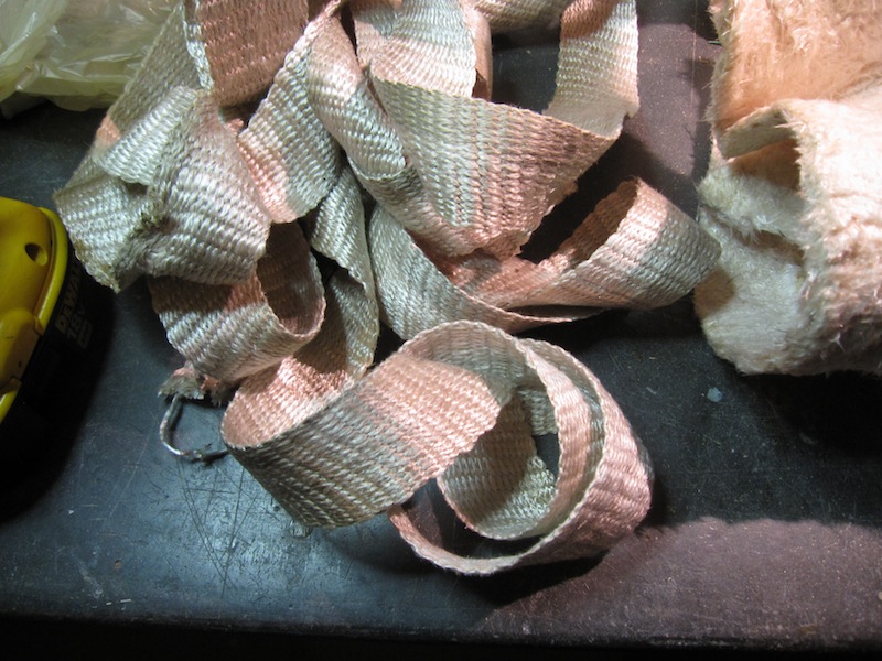

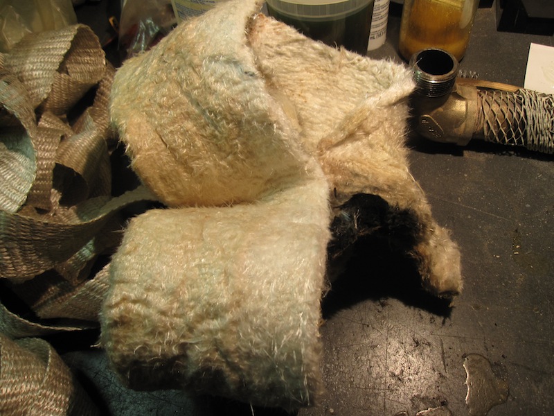

I took off my exhaust riser today due to an exhaust leak. It appears the leak was only at the threaded joint at the manifold flange. It was so fun getting off the hoses as some you already have experienced. The hose the connects the muffler to the riser is just standard exhaust hose, relatively stiff, so I'm thinking on getting the hump hose from CD. The pictures show that my riser is stainless and looks pretty good. The thermal insulation consists of a stiff metal mesh, fiber batting, and then fiberglass mesh on the outside.

Nice work. When you put it back, what are you planning to use on the threads into the flange to avoid future leaks?

A number of years ago I changed to a stainless steel threaded exhaust piping made up of fittings & nipples.
It worked well for about 3 years. I developed a leak at the cast carbon steel flange connector for the exhaust head.
The problem was s.s. vs carbon steel. The nipple ate away at the female threads in the flange because of dissimilar metals. I did some hunting and decided to go with a galvanized hard piped system & a replacement exhaust flange. It's going great for a number of years now. In addition, galv. is much cheaper to change out.

The ABYC specifies that all threaded pipe & fittings used in a marine exhaust system be made of Sched 80 pipe NOT the sched 40 I see most DIY's use. SS is very prone to fatigue cracking especially at the deep part of a thread due to the vibrations associated with engines.. It is also not technically "galvanically compatible" with the engine manifold, which is another ABYC requirement..
I simply use schedule 80 black pipe & fittings. It is relatively inexpensive and last just as long as galvy pipe. SS in sched 80 is going to be very expensive and more prone to failure....
