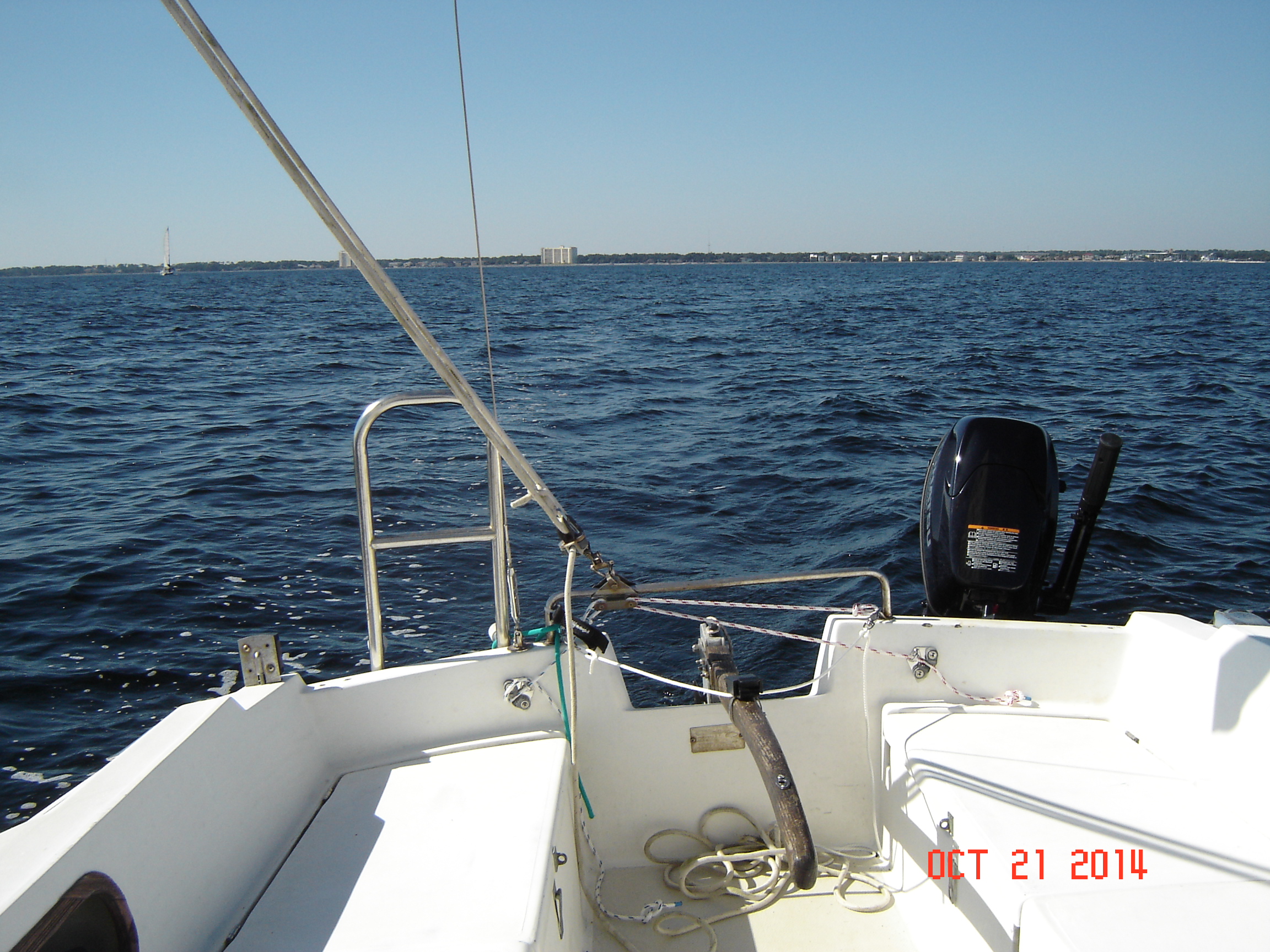

Try a two sheave block with a swivel and a ring around the traveler rod until you get funds. the real thing looks like this in place.
