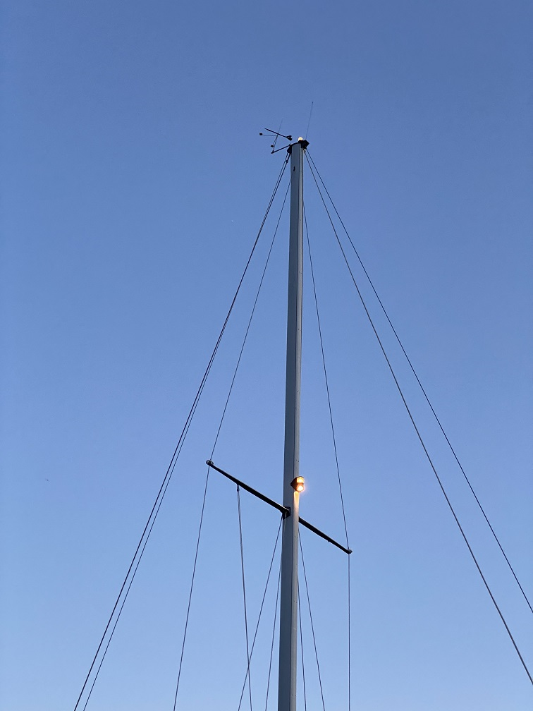

An update. It failed again...
Although playing with the wiring in the panel "seemed" to have fixed the issue, it failed again. Just a little more research and I learn there is a deck plug at the mast. Funny, I have never seen it as long as I have owned the boat. Well, I can only get my finger (singular) on the plug and I pressed it a few time. Now the steaming light is working again. In order to get to the deck plug I will have to lower the mast. It ain't gonna happen unless I take it to a boat yard and have them do it. That's gonna cost. But I guess I will have to eventually.

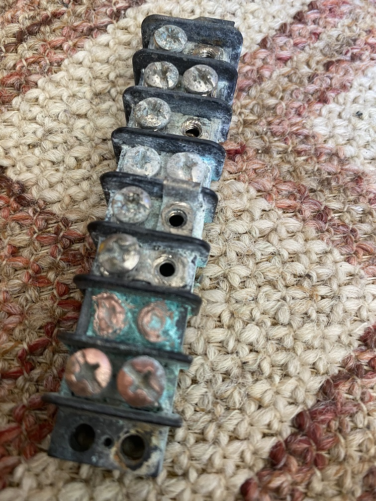

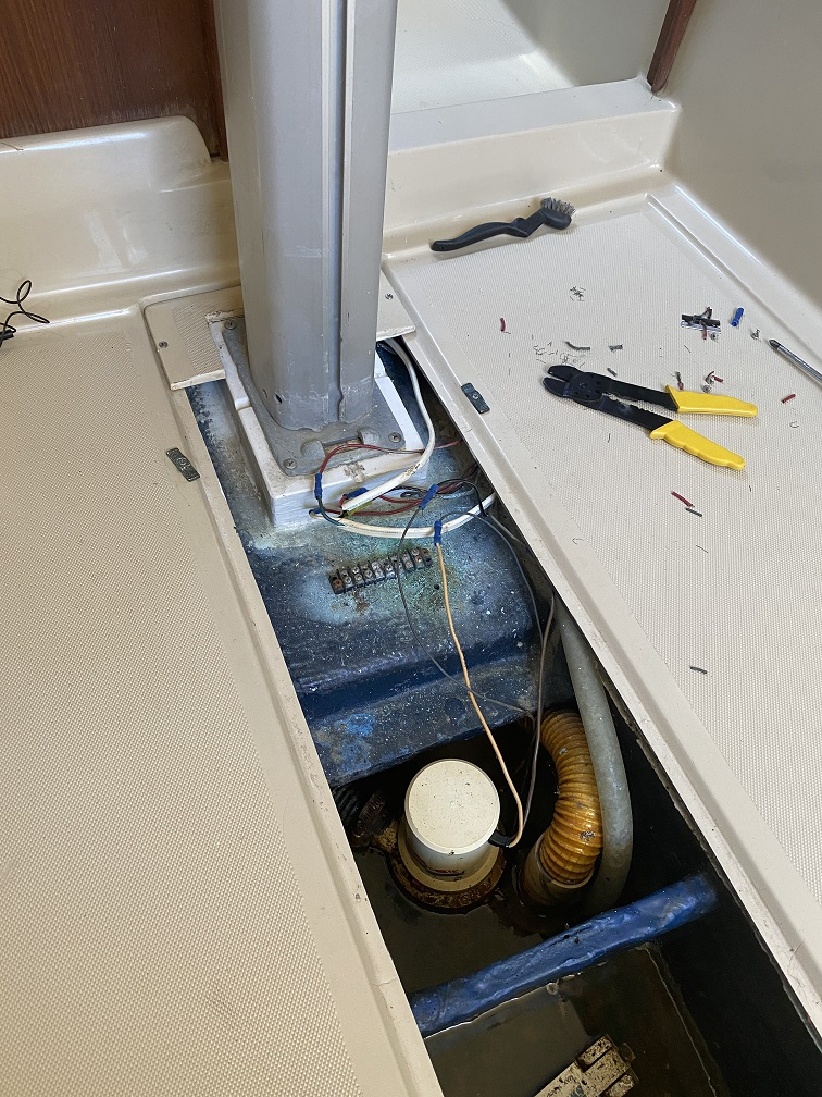

I just fought this fight! Harbormaster threatened everyone to not be out after dark if you don't have ALL working navigation lights. So I checked mine out on the way in in the dark and everything works EXCEPT the masthead light. I got away with it as my steaming light was working fine. I assumed (for reasons I can't explain) that the bulb had given out and I was going to have to go up the mast. I tried to use the mast crane, but it wouldn't reach. I bought a mast climbing rig and got it all setup and ready to go. But I needed someone to run the halyard for the bosun chair and couldn't find anyone for a week. While I was at the boat I cursed the light and then thought, "I haven't checked the connections down here, and that mast light is sealed." So I dug in and found this:
The bus looked like this:
Rewired all the connections with proper connectors that are waterproof and now I have this!
Mast head light, Steaming Light and deck light all working. I did find that dielectric grease helps keep the open socket on the deck light from corroding. And I didn't even have to climb the mast!

Not to be picky... but I think that is a barrier strip with one pair jumpered. A bus bar is one where all of the circuits ride together, like a bus. A ground bus, for example. Important when you go to order parts, although they are often in the same catalog catagory and are often cross listed.
There is also a CRYING need to elevate the strip off the floor about 3/4-inch with a spacer, to help keep it dry. And coat everything with waterproof grease when you are done. Pretty corroded!
