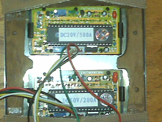

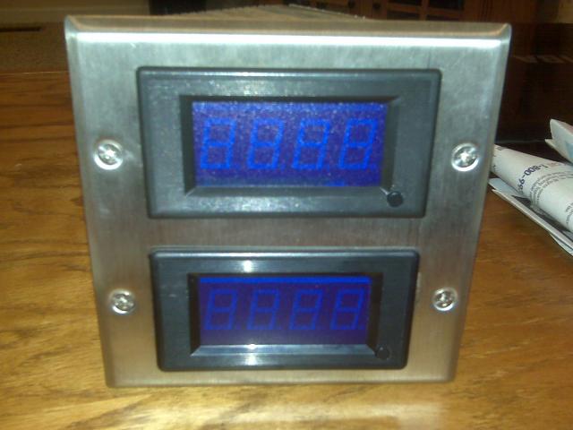

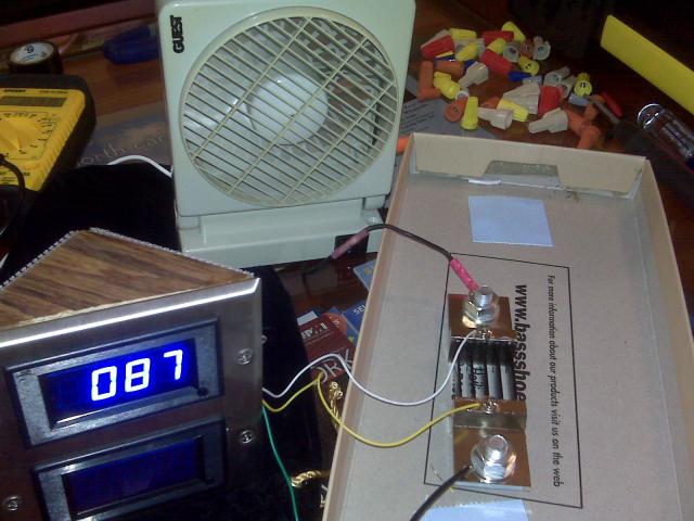

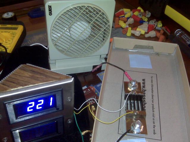

OK - after a weekend on the boat and finding the time for a nice sail the meters are still not working... The readings jump a couple times each second for example - it will read 84 then 134 then 212 then 43 then 172 and on and on... I even brought it home and wired it up trying to track down the issue and still had the same results. Here are a few pictures including on of the shunt on the boat. I am starting to think the Meters are bad. Thanks again!

This may be a red herring but, on reading your original posting, I studied the range of ammeters listed by your e-bayer. I noted there are two types of meter. One requires a separate power source isolated from the current being measured and a second, a more expensive version, which will operate from the same source which is as you are doing.
Again the numbers shown in your photos would appear to be of the second (correct) type but I am just wondering if there has been a mistake in the supplier's product.
You might try asking him.
We presume from the black wires that the shunt is in the negative battery connection.
