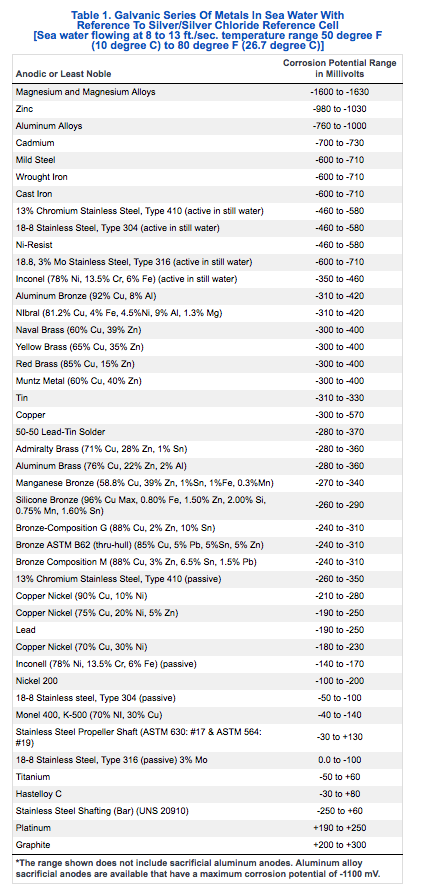

I don't want to spoil the conversation, but Cathodic Protection works by the following electrochemical potentials.
in sea water. Lowering the salinity lowers the potentials, but not the order in the list.
____
Since good sacrificial Anodes require that they sacrifice electrons faster than the protected metals, several factors determine the rate of metal loss of the Anode.
1) Water salinity
2) Water Temperature
3) Exposed Surface Area of the Anode.
4) All submerged metals must be electrically connected to the Anode.
A Zinc Anode and an Aluminum Anode are NOT interchangeable, even in sea water.
You must change the Surface Areas exposed to interchange them!
______
Encrustation of an Anode suggests other effects are in play.
A reputable Anode maker impregnates the pure metals and casts them to allow for surface Oxidation.
My first guess is...
Not enough Surface area of either Anode or you added more submerged metals to your boat.
If you are using a shaft "Egg" Anode, try adding 2 or more.;)

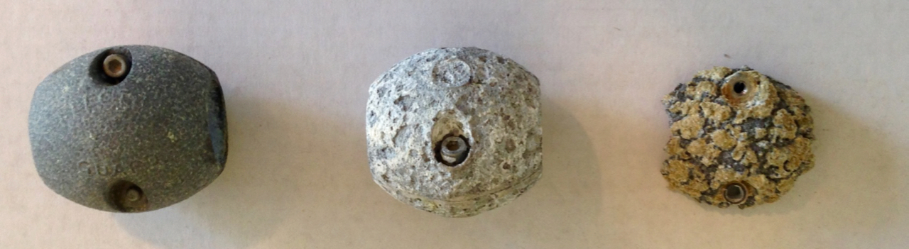

Aluminum anodes tend to be lighter in weight and color than zinc. They are slightly shinier and the gray metallic color is a lighter shade.
In the photo, from left to right zinc, aluminum, and magnesium. The zinc was in the water for more than 1 season, the aluminum for 1 season, and the magnesium 2 seasons.
The best way to determine how much has eroded is a before and after weight.
Edit: All three were in freshwater.
