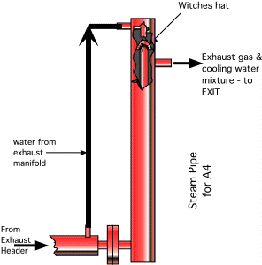

If your water lift is essentially a 'vertical pipe' thats mounted to a bulkhead with the exhaust inlet on the bottom, the water injection on top, and the exhaust exit about 3/4 from the bottom ..... simply remove and take to a fabricator for a rebuild - easy to do.
A fabricator will simply cut it open, inspect the thickness of the plate, reweld/repair .... and IMPORTANT on a Pearson design water lift: replace the 'witches hat' thats inside. The 'Witches Hat' prevents the injection water from spraying down the inlet tube; and, does easily rot out due to the temps and corrosive gases. Without the witches hat you can easily 'backflow' water into the engine / combustion chambers. The typical pearson "Steam Riser Pipe" is a good design ... just need to be sure that the 'witches hat' is intact; once you get the leakey seams repaired.
