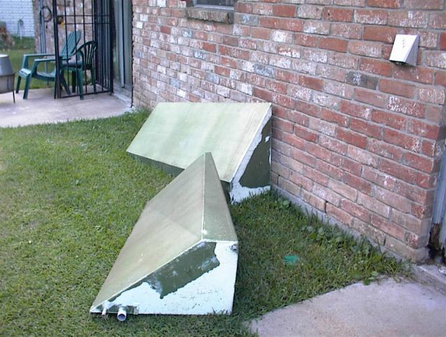

Over the years we have seen much here on HOW about leaking aluminum water tanks. I am wondering if there are any new technologies that I might have missed. Pictured are the two water tanks from an H37C courtesy of Ron Pearson. He did "plastic". Some have inserted bladders while others have sealed the entire tank from the inside. As you can see they are oddly shaped, about forty-five gallons each.
You H37C owners know that these are tabbed in and the inner-liner laid over them. Removing them means some pretty long fiberglas cuts of the two salon seats. I have made nice cuts with my Roto-Zip but never anything that long. What is the best way for getting those tops off? And cutting them so they can be glassed back on?

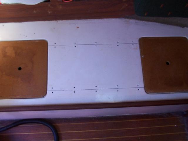

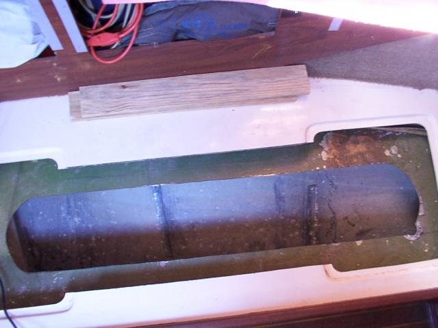

You may remember that I went witht he bladder option. I cut the fiberglass and the aluminum with a sabre saw and a metal cutting blade. As far a resealing, I screwed two boards top and bottom (see photos). That seemed to hold OK. The baldders have also worked well.

I do remember now. And smart because you only had to make those two short cuts. Add to that the ability to easily check and replace them. I like it. Did you get the same capacity with those tanks? Do you recall the brand and supplier?
Opening the tank as you did, does it let you reach every corner? If so then one could coat the entire interior with something? Of course then there is the problem of putting a leak proof top back on the tank.

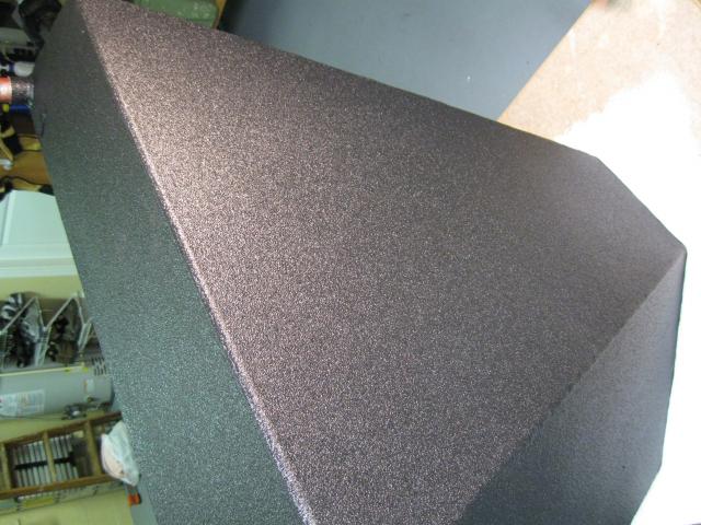

I have a 37 gallon aluminum water tank on my S2 Sailboat which had a leak, than found almost a hundred small pit holes. Rather than replacing it I removed it and had it coated with a coating, potable water approved, which is sprayed on the beds of pickup trucks, boat decks, etc. I used Line-X cost me $250.00, guaranteed for over 10 years, and is about 3/16" thick. Aluminum must first be primed properly. It is very strong and durable. I have heard of it also being used on gasoline fuel tanks.

Oh that's right Richard, there are baffles in there. Don's coating from Line-X is appealing except for having to remove the tanks. I like the ten year warranty part of it. I can purchase Roncos for about the same price though. If only they had something shaped like that. Still learning.

Excellent idea Bill with one exception. First the tanks have to be removed. So I would have to make the decision to NOT repair in place or not use a bladder. Then both tanks would have to come out since they are not mirror images. But the idea joins the list. I may investigate the likely cost of welding up a couple of tanks.
