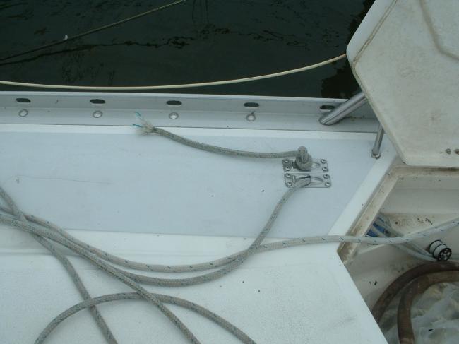

As I attempted to close my furling the line snapped, its no surprise considering it's original equipment to my 1989 30 hunter, and mostly layes on the deck never really drying out. This is a problem because it seems this line needs to be spliced, which seems next to impossible for me. Is there something I'm missing someway the furling comes apart and I could buy the line already spliced. If not who does this kind of work and how much could I expect to pay. Furthermore beside the reasons stated earlier to what lead to the snap I feel that the furling takes a great deal of force to turn, what kind of maintenance is typical for this. If I most splice a line is there one I could use that would be more similar to a dock line with less strands? thank you
