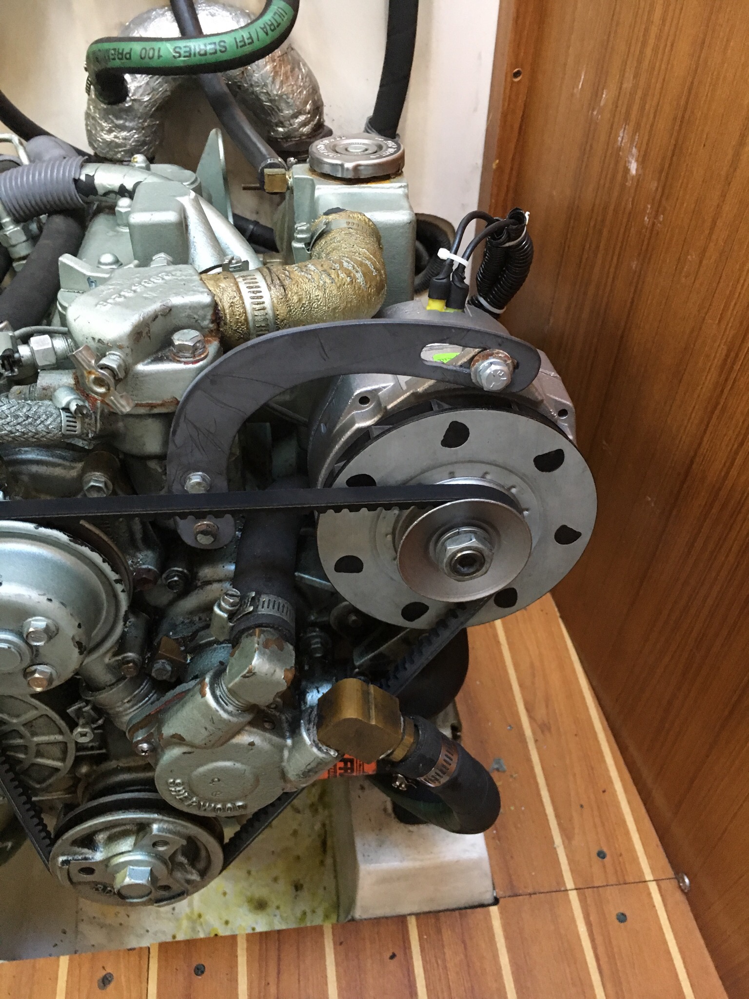

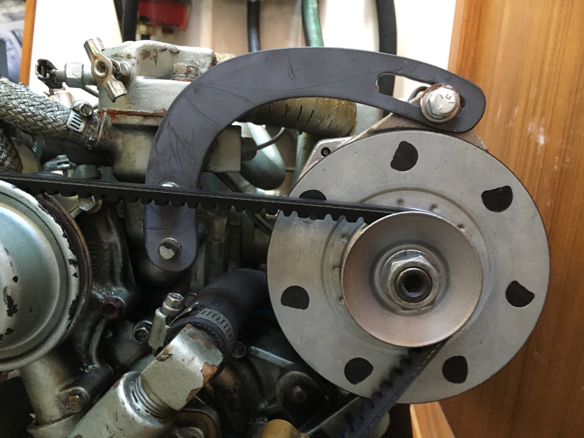

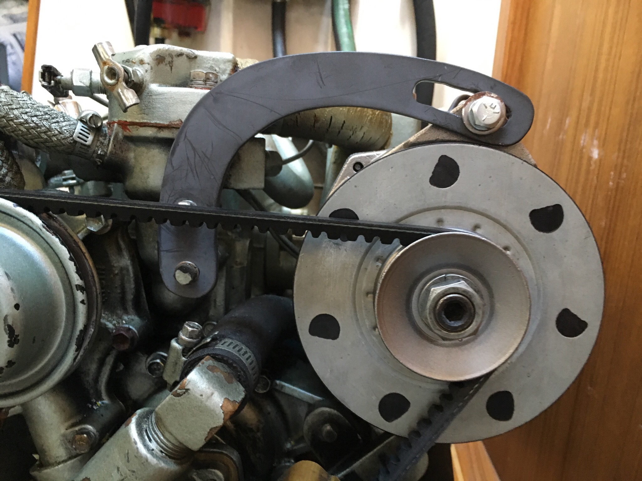

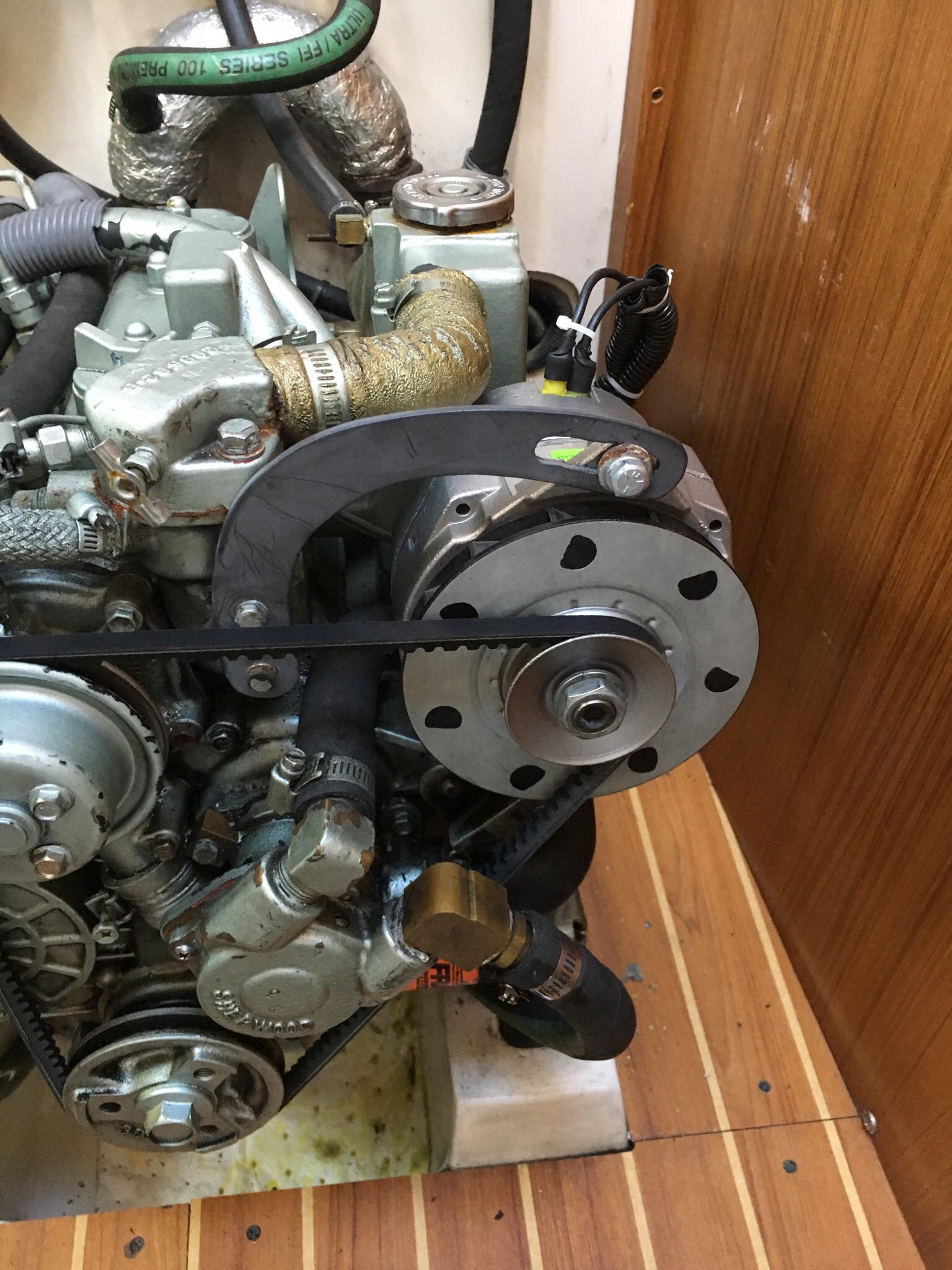

I just replaced an alternator this weekend also, it must be time for these to start failing. Lucky have a well know place in Green Bay WI that rebuilds and builds up units. I ended up with a replacement (95 amp see photos) and my original 40 amp rebuilt to put out 60 amps. 01630c0385118e721dd554e941e4bfe88e447bb454.jpg Only problem was that the 95 amp is a larger case and needed a different belt and bracket. (see Photos) 015d1546a877633505f55bae333c2022b828cd2bb2.jpg Now the big question, as I have not opened up the lower panel at the wheel yet. How do you calibrate the tachometer as it is now off on it's readings from the alternator output.
Thanks
Russ
May 20, 2016
3,015
There is a calibration screw on the back of the tach -- shoot the engine with a optical tach and match settings. Harbor freight has them for about $30 - or you international org may have them to borrow (I know the C36/37 org loans them) I have my own.
Les
Aug 24, 2009
444
Catalina 310 Sturgeon Bay, WI
Thanks Les,
Straight forward enough, the only simple part of this simple project. I found a local auto parts store that will rent me one for $15 for the weekend... not so bad.
Russ
