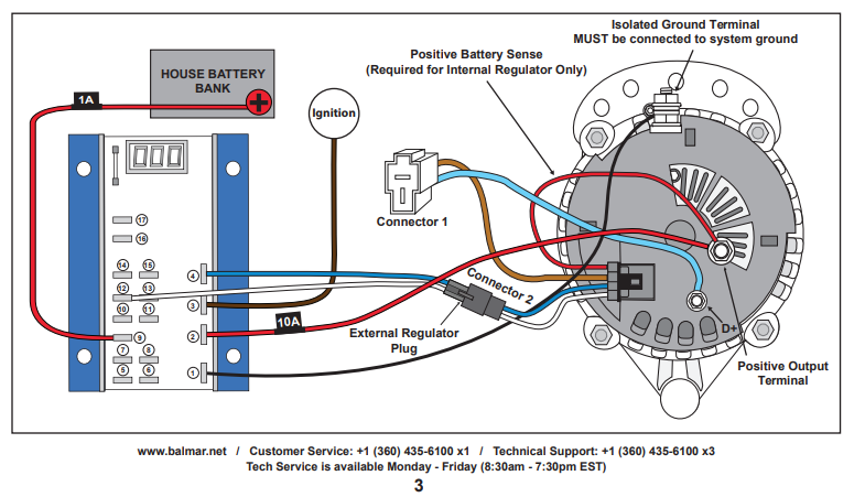

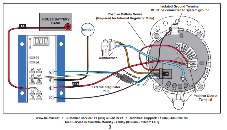

So here's the wiring diagram for a Balmar external alternator regulator from the Balmar manual. Its not clear to me how "...the AO either goes to a switch or directly to a bank". In this diagram it appears to go to the external regulator and then to the house bank (switch is missing in this diagram). Or is that Connector 1??
Genuinely trying to understand here.
That' the diagram for connecting the reg to the alt not alt to the DC system..
23,173
Good question. Here's how to look at it:
1. Understand what connections numbered 2 & 9 actually are. #2 shows a 10A fuse and # 9 shows a 1A fuse. This means that they are signal, not power wires. (#9 is volatge sense [of the battery bank being charged] & #2 is power to the regulator; neither is the AO)
2. Recognize that even OEM alternators are usually a minimum of 30A alternator output (max. cold) and you'll see those wires couldn't possibly handle the actual AO.
3. The AO to the battery bank or switch is NOT shown on the Balmar wiring diagram because it is independent of the signal wires needed to connect a Balmar external regulator.
Likes: tfox2069

tfox2069 , from the Balmar Max Charge MC614 Manual page 3 describing Terminal 9:
"9. POSITIVE VOLTAGE SENSE - Connects to battery being charged. Use RED fused pigtail connector (included) at battery end of user-installed wire. THE SENSE WIRE MUST BE INSTALLED FOR THE REGULATOR TO OPERATE. "

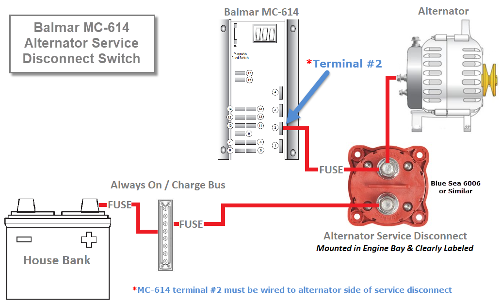

Here is an image from Marine How To (better known as The Bible) that shows the alternator output taken off at the large B+ terminal, through a service disconnect switch to the positive terminal on the battery.
Likes: heritage
