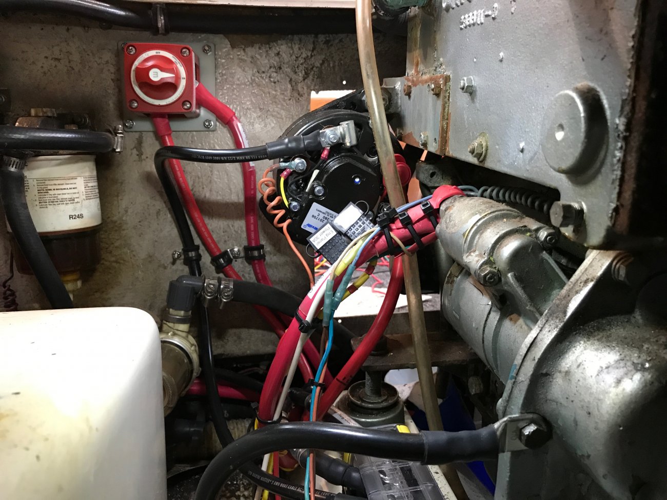

I followed Maine Sail's advice and installed the Alt Service Disconnect switch right next to the alt so I wouldn't forget it or forget to tell the mechanic that the alt is wired direct to the house bank. I could have pulled the fuse when I worked near the alt but with that red switch right in my face I won't forget or take the lazy way out.
Here's a pic.
