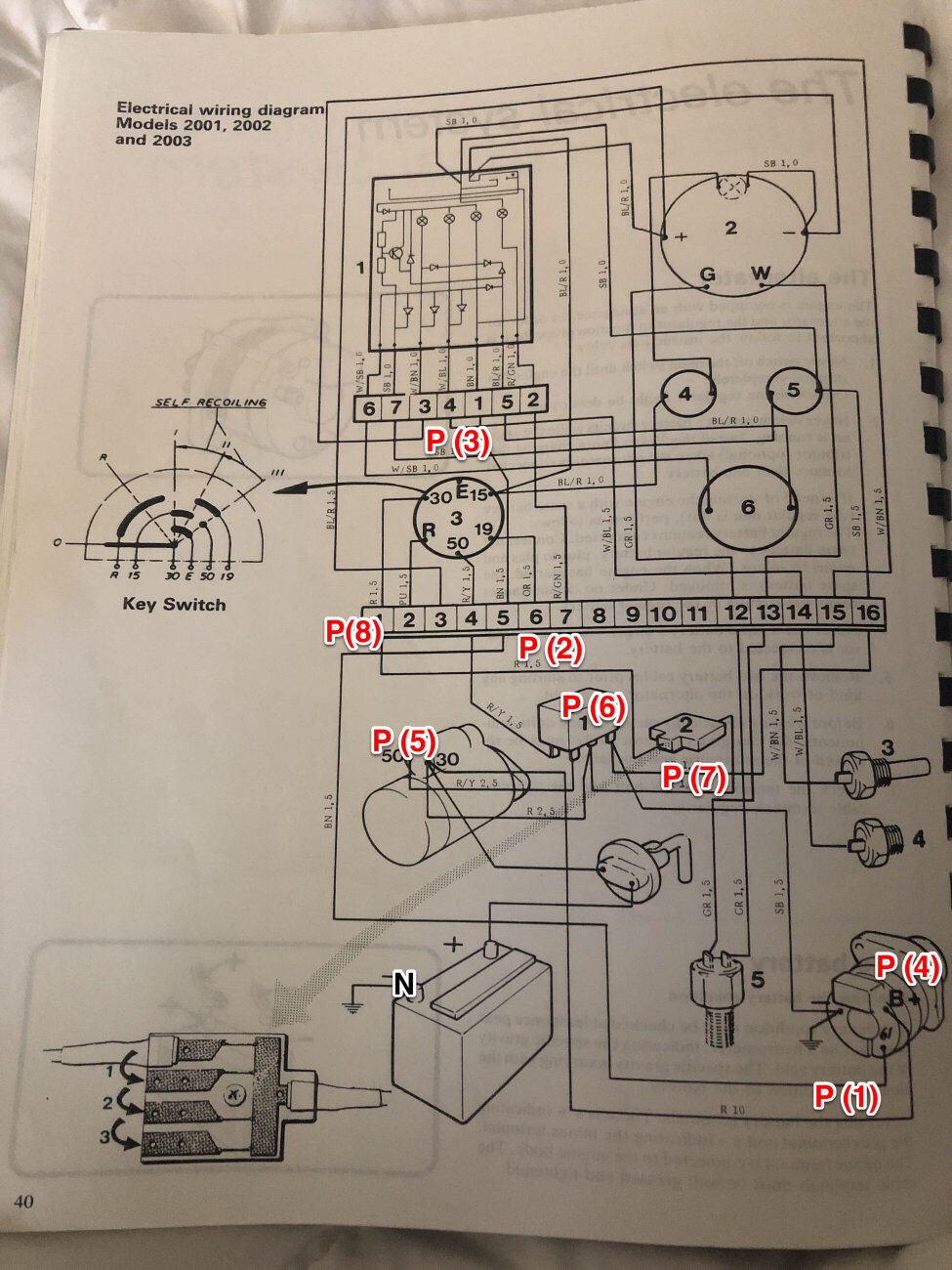

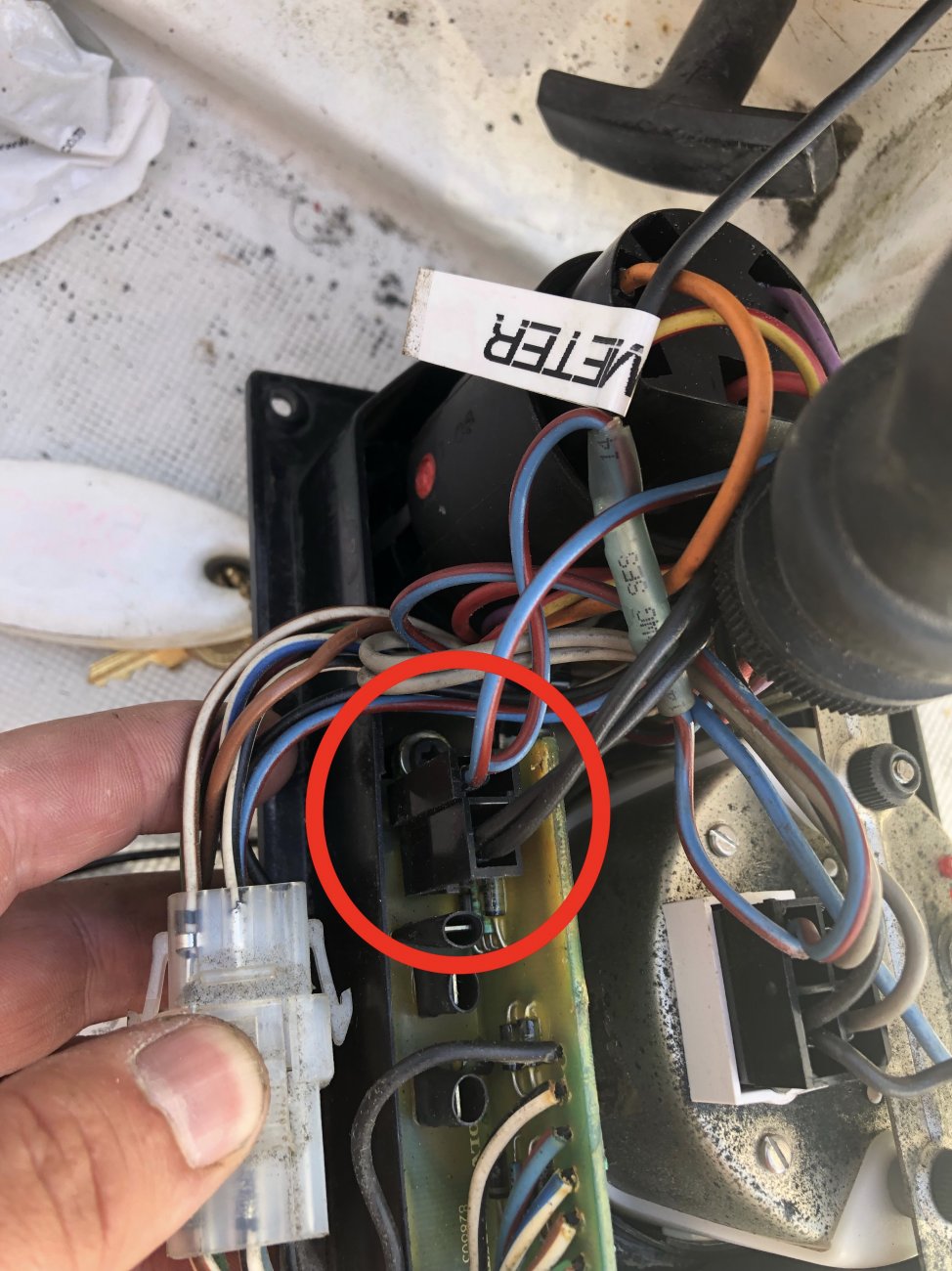

The fuse that feed the instrument panel on my Volvo powered Beneteau failed and caused the previous owner all kinds of problems. When I bought the boat it had a remote start switch and nothing on the engine panel worked. All 4 fuses in the block looked good but the first 2 tested open. Everything started working correctly when I moved the wire to a good spare fuse. Its a fuse with 4 circuits, 1 working and 3 spare. I my case is 2 failed, 1 working and 1 spare. Hope that makes sense.

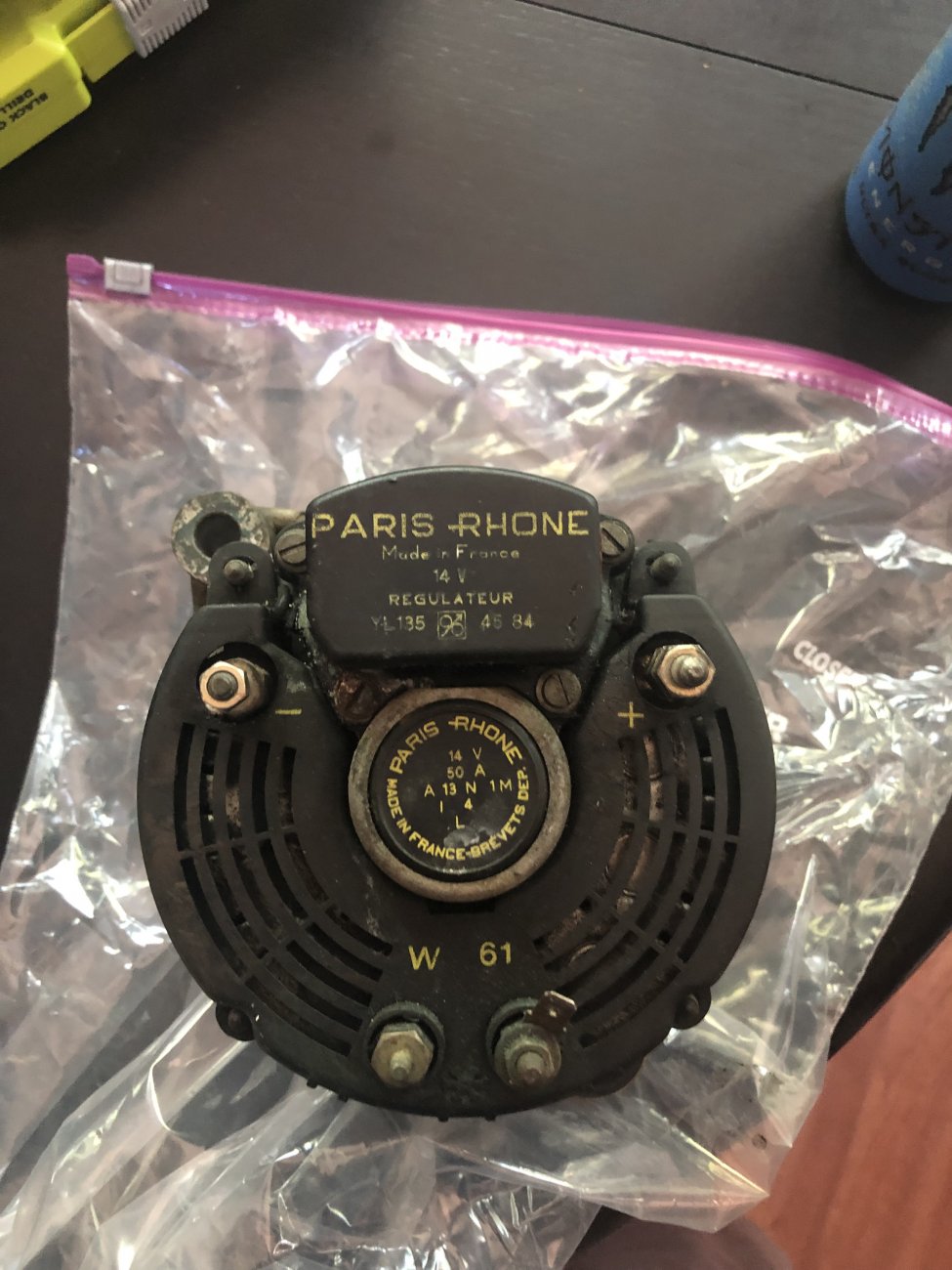

Yeah that is what I’m thinking. That is item #2 right? It has 4 prongs and it is still on the 1st prong. Or maybe 4th??? It is on one of the ends...

Yeah I know we want 14v. That is what started this whole journey. I think I have a few good places to start. I only mention the lower volts because that would confirm everything functions normally and it is the alternator that is bad (still)

The joy of boats again surface. :banghead:
Things rattle and role in a boat. They work their way loose, just to torment the boat owner. Sometimes even we are the cause catching a wire as we turn to crawl out of a confined space. :mad:
What was one of the first suggestions? Follow the wires....:kick:

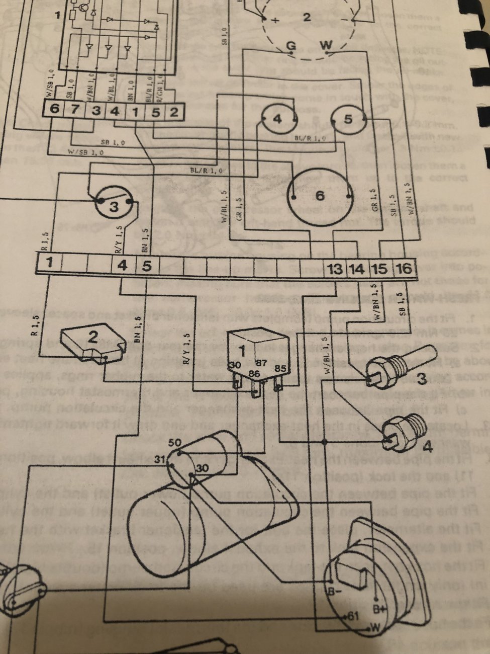

OKOK, old problem separate solution. Whenever I start the motor, I now (almost) always check to see that I’m getting 14v. Well, that happens about half of the time. It is resolved with some cursing and unplugging and plugging the panel a few times. Then the motor bears down and it jumps from 12.5 to 14. Is there any electrical magic that happens through the circuitry between the 61 plug and the panel? Looking at the diagram and following the wires, it looks like it just goes through a series of harness jackets to the panel. Could I just run a wire straight from the alternator to the house battery.
