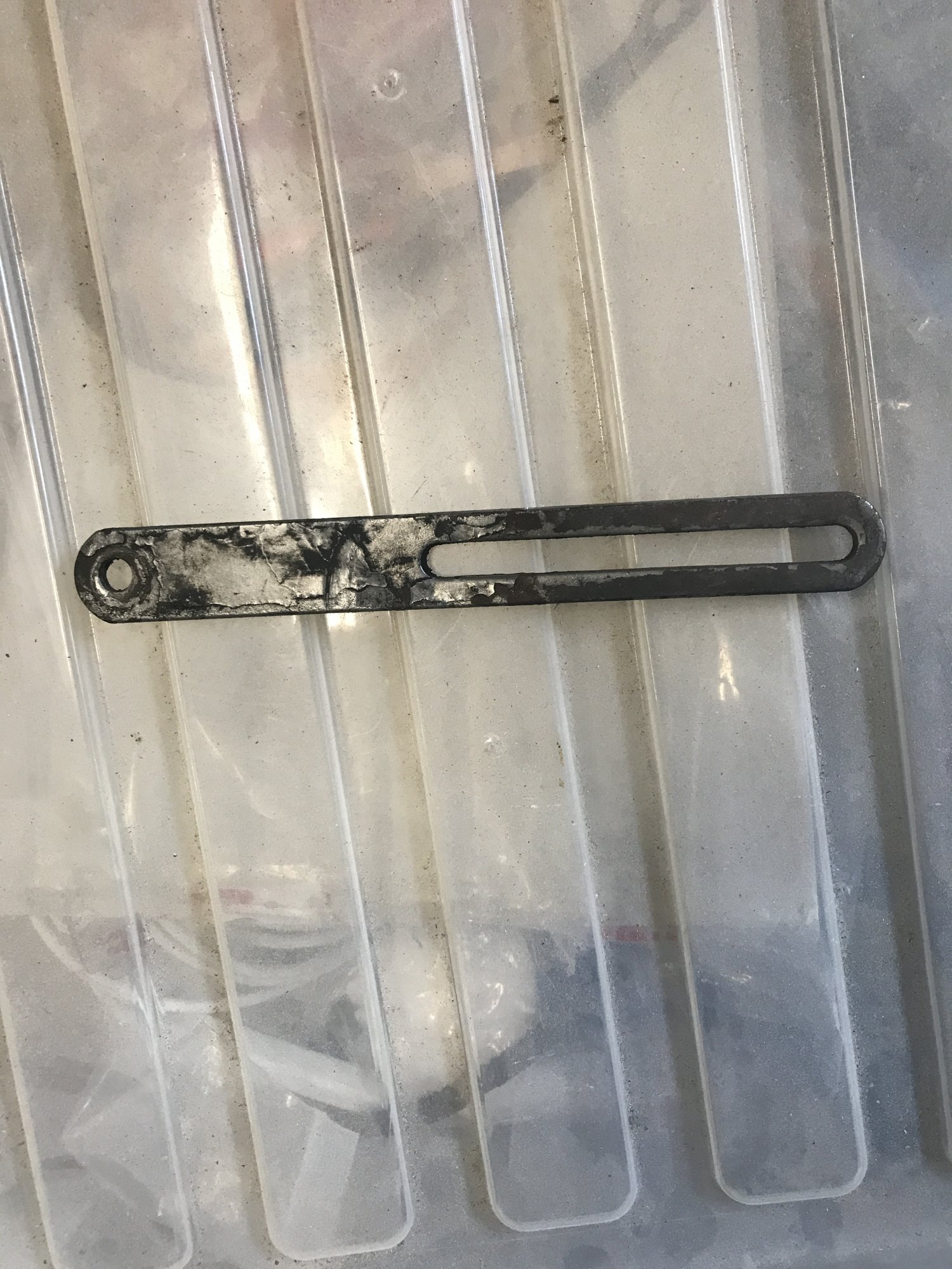

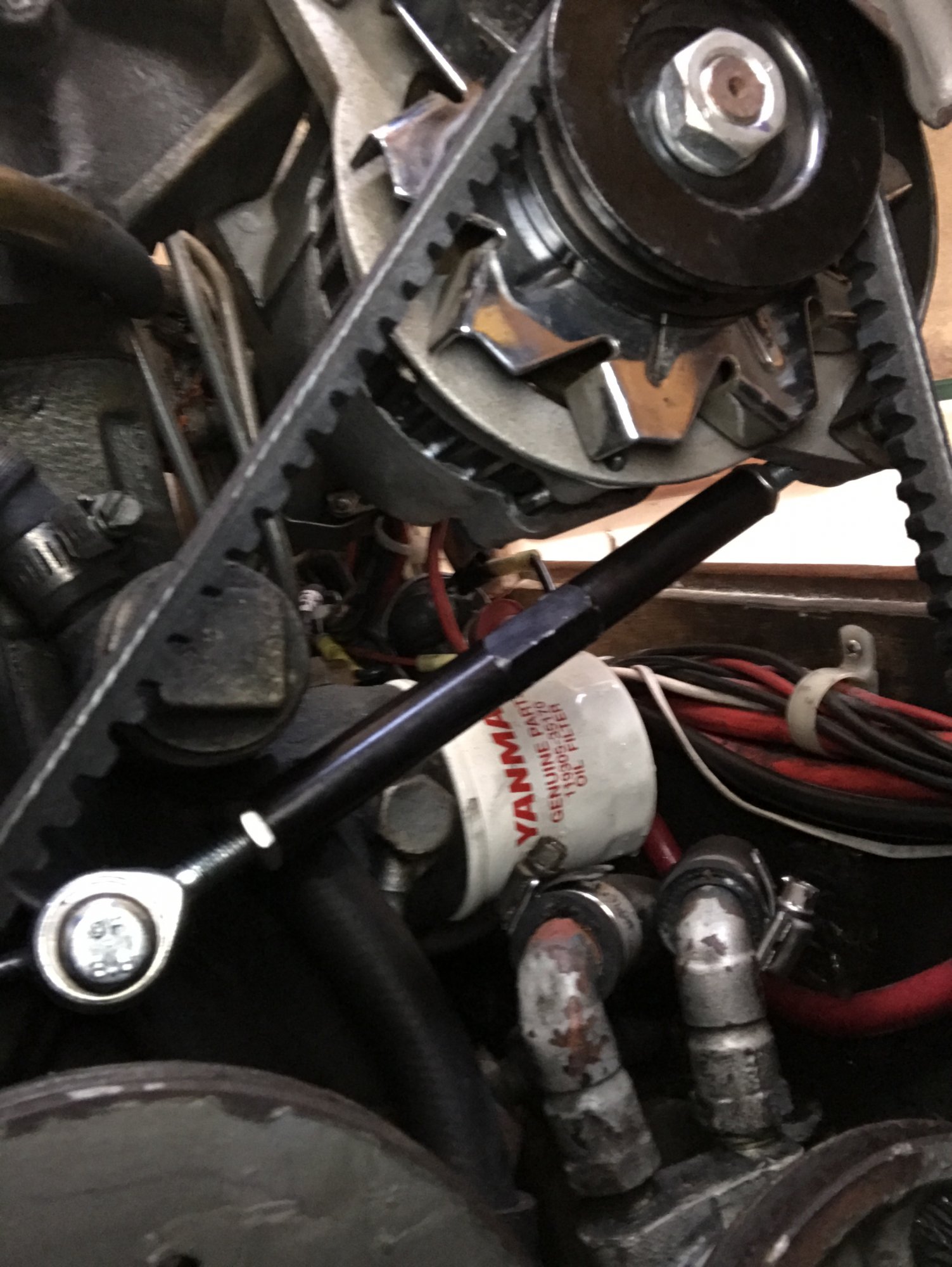

This is my last modification this season. Could not keep my alternator belt tension adjusted. Seemed to always need to be readjusted. No more. Replaced the common contraption used to adjust the belt tension with a far more practical component. In addition to never slipping, this device provides a one hand method for applying tension to the belt. Device is called a Heim joint adjustment rod. Below are the original bracket and the new adjustment rod.

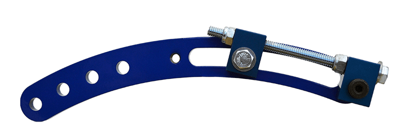

I installed a Balmar Belt Buddy last year and a slipping belt is no longer an issue.

I like your modification. It’s a much more practical device. No rush, but could you tell us the thickness of the bolted ends? My 2000 340 has a bent bracket adjusting arm for the alternator. It holds well, as slippage has never been a problem.
It‘s the adjusting that is an issue. I have to loosen the alternator front top bolt (12 mm), then open the side access panel in the aft compartment, then use a different socket (10 mm) attached to an extension arm, loosen that. Then back to the front of the engine, insert a screw driver in the slot, tension the belt, tighten the top front bolt of the alternator. Go back to the side access panel, switch sockets and tighten that bolt.
It’s a process. And I never get it right on the first try. And really, why 2 different size bolts?
I‘m not sure if your straight bracket would work for me given the thickness of it. But I love the “tie rod” style adjustable aspect of it. That’s for me. Thank you for your help.

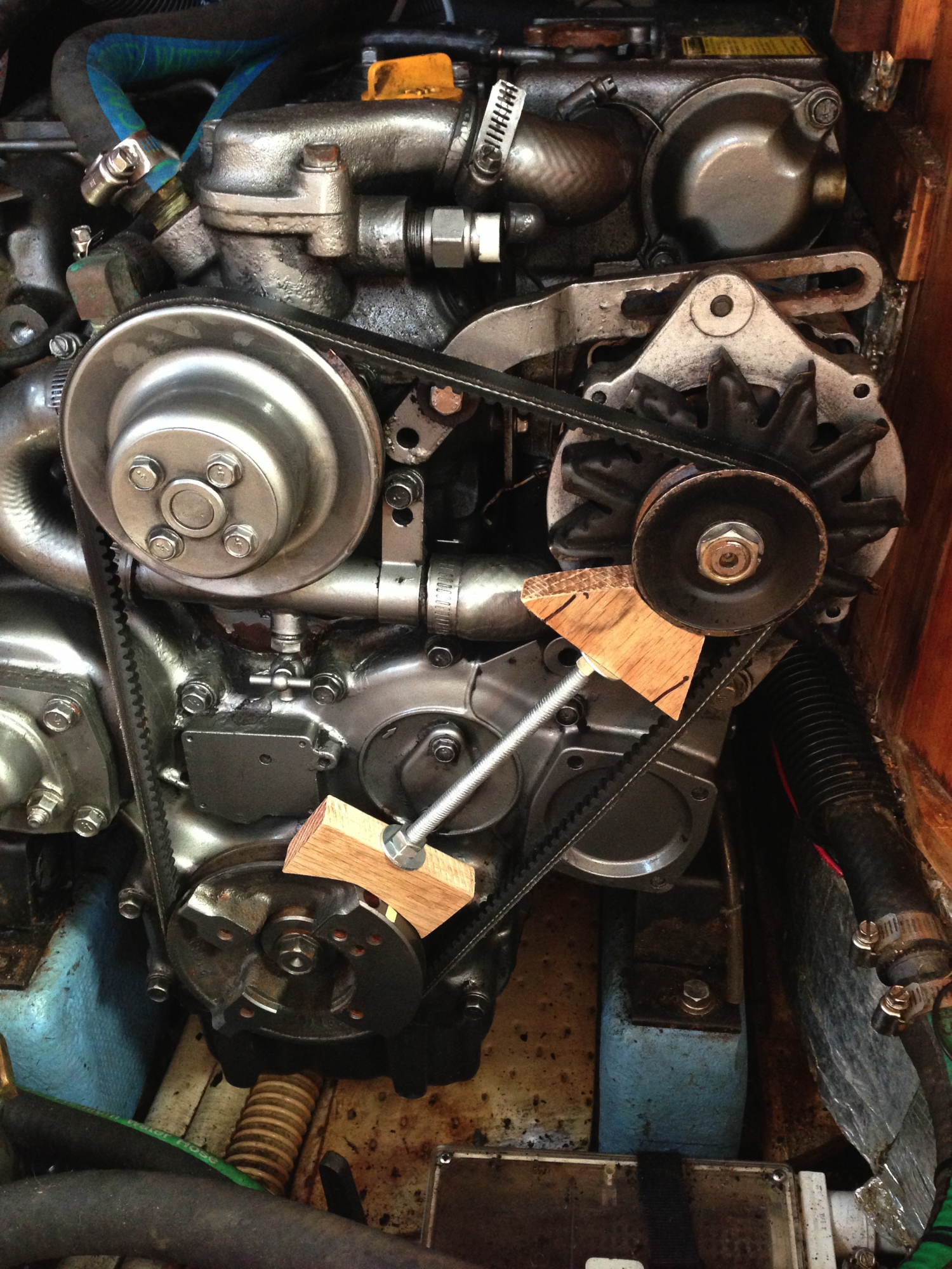

The attached photo shows an alternator jack I built a few years ago. Once the alternator is in close to the correct position, the jack will can increase the tension until it is correct and hold the alternator in position while the bolts are tightened. If the alternator is slipping, try using a double thick fender washer under the adjusting bolt head. This increases the friction and can reduce slippage.
Jack is made from a piece of scrap oak and ⅜" threaded rod. Once tensioned the jack is removed.

That would also work, the washer would keep tension on the threads. When I installed a new high output alternator I added a serpentine kit and the Balmar Belt Buddy. Easy to set the tension and it holds.

It's easy to make your own adjustable link like the one in @RoyS 's picture, if you're so inclined, at least for a link to fit 3/8" bolts. It so happens that the inside diameter of 3/8" x 0.083" wall aluminum tubing is just about exactly the right size for 3/8 UNF thread. So, cut a piece of it to length, tap one end right hand and the other end left hand, thread a 3/8 x 3/8 rod end and jam nut in each end and you're ready to go.
Be sure to file the ends smooth and check perpendicularity to the axis using a square. Perpendicularity is important.
You can get everything you need from McMaster-Carr, including the taps. If you're thrifty, the "Economy Carbon Steel Taps" work fine in aluminum and are much less expensive. Or, you can get the material from Metal Supermarkets and the taps from any industrial supply house.

Yes, remains in place. Secured by same fasteners that old contraption used. Old contraption was approximately 1/4” thick, while this device is 1/2” thick. You may want to use slightly longer fasteners. On my Yanmar all fasteners for the alternator and bracket are m8.

Caution SycloneDriver, your 5/16” fasteners may actually be m8 size as mine were. I searched for a local source but had no luck. Eventually I found a guy in England who supplies custom Heim joint adjustment rods. He has a Facebook page but I am not a user. He has an email address and is easy to work with. Payment through paypal. His email address is oilphiluk@yahoo.co.uk

You are correct, my fasteners are m8. I was just trying to simplify things, 5/16" m8 are very close.
I might just have a friend of mine make me some bushings and live with 3/8.

I measured the distance from center to center today I need to be able to shorten it down to at least 2 & 3/4 inches, max length of 3 & 1/2 should work. That's probably too tight for a 3/8 heim joint, so I'll have to find 5/16" or 8mm.
