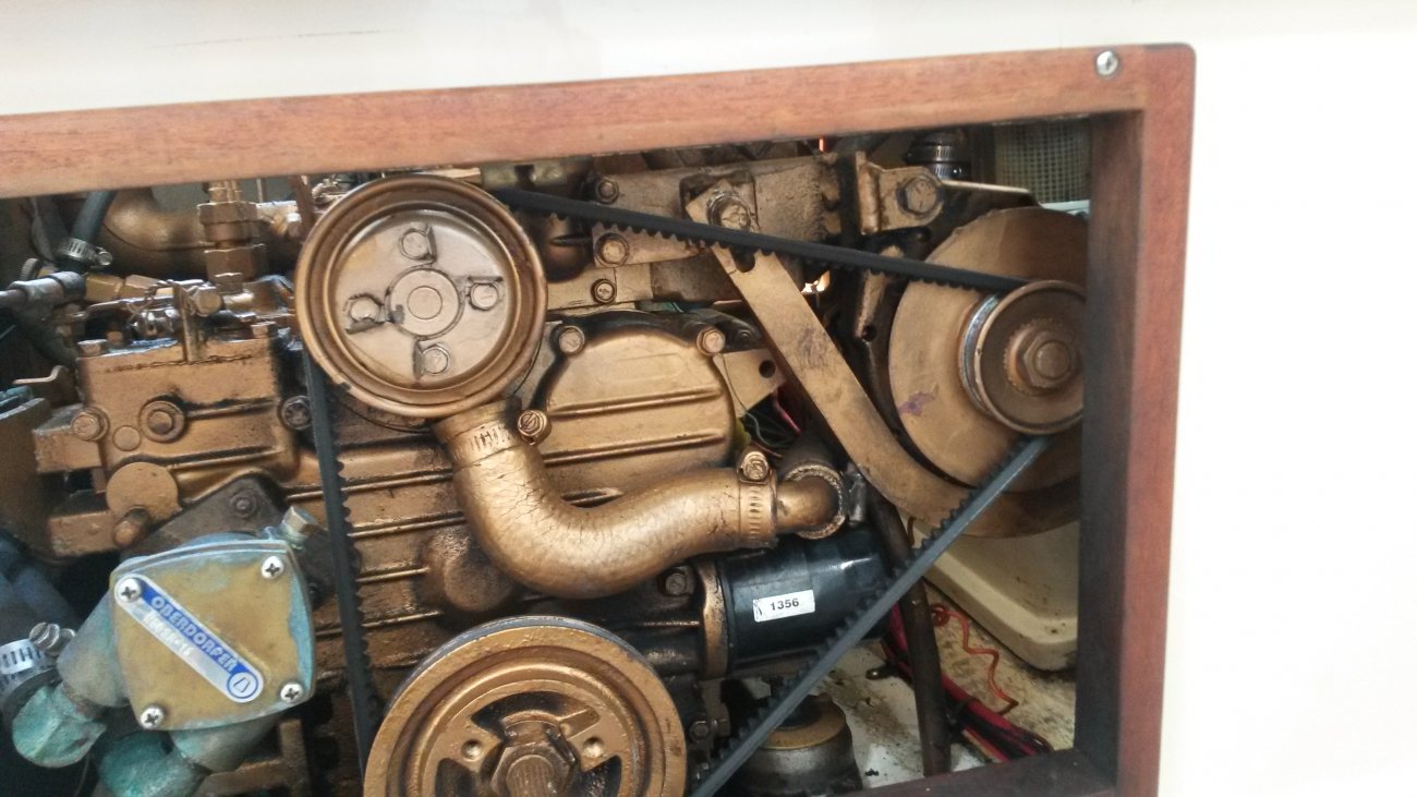

I captured this from another post. My Universal 25XP looks the same (w/Oberdorfer). I see the one bolt mid-span behind the belt on top. Adjusting just this one is not sufficient though correct?
Feb 6, 1998
11,723
You need to loosen the bolts at the alternator foot (the alternator is upside down on that engine, but the the 2" foot is the "foot"), adjuster ear on the alternator and the top bolt where the arm has the short slot. If your belt is worn, as it appears in that photo (sitting way low in the alternator pulley), you may not have any room left on the adjuster arms slot.

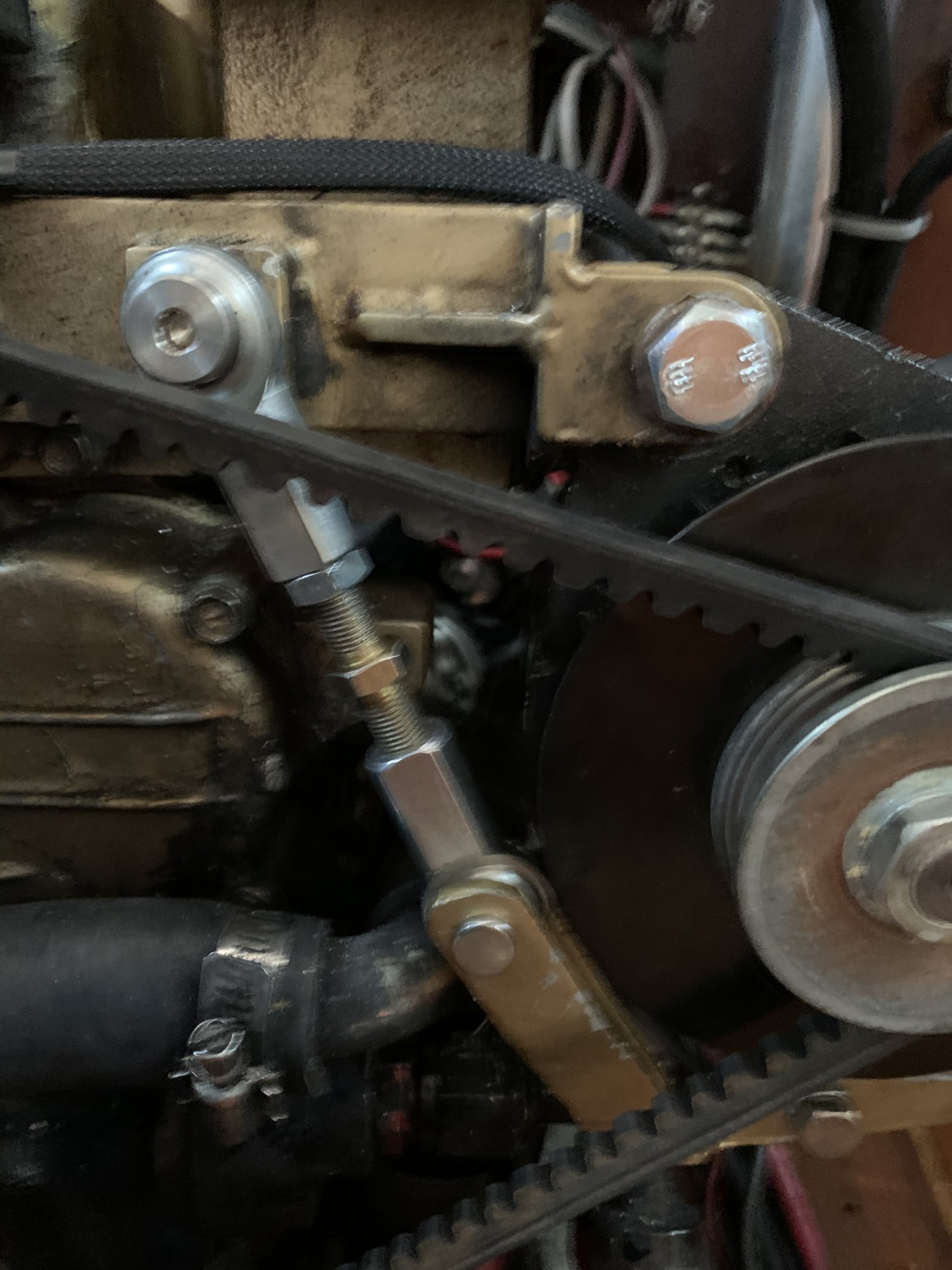

This is my system for a M25. If you get the MainSheet it’s written up in there.

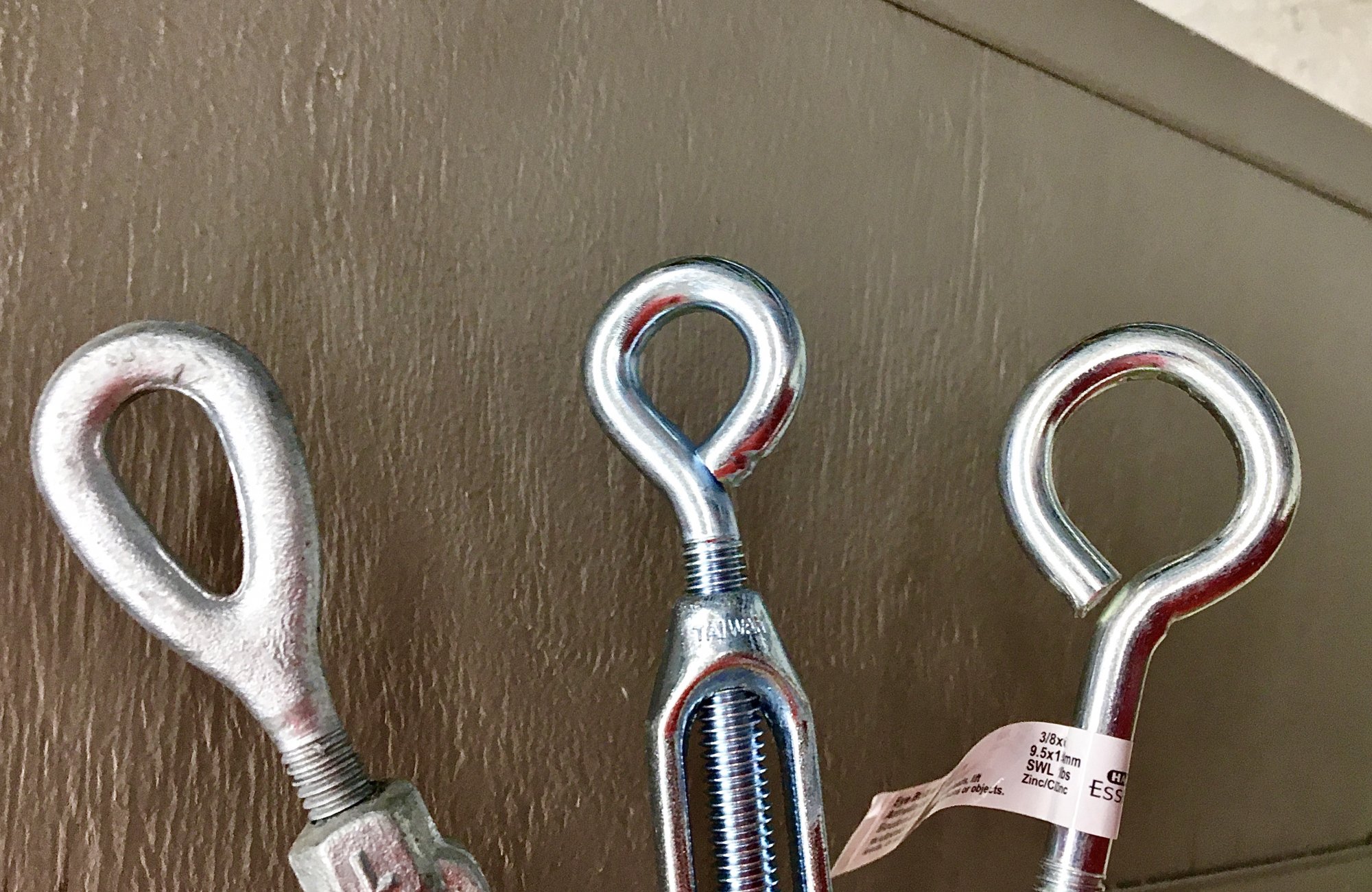

For what it’s worth when at Tractor Supply one day I looked at different ones to see which the best type eye bolt. I hadn’t yet bought one (was 700 mi from the boat that day.).
to improve a little on a great idea and ride against the pulley better my thought was if the eye was welded closed it could be cut and opened up into a fork. Or hammered from round to oval, flat, or maybe concave.
I figured it was worth the cost of a turnbuckle to try it.

The one I use has hiem joints at each end to allow fo misalignment. About $10 on eBay. I welded up the alternator side bracket and shoulder bolt on engine side.
