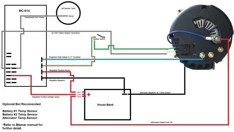

Hi forum.
(Hopefully correct area) I am about to install a M.Grasser 140A Alternator coupled with a Balmar MC-614.
My question is around the 'built-in' harness that comes with the Alt. Instructions are not clear but i think i DO NOT need to use the cables coming off this as they are all pushed from the Balmar instead,?

bThanks for the response and query Maine Sail...
as per attached there are 4 wires on the Alt as shipped.
Blue going to Pos out
Green
Yellow
White -
I am going to use a MC-614 and have twisted up now in my mind if i need to use any of the outputs supplied with the Alt ?

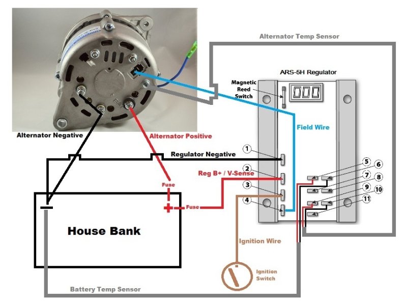

i am kind of looking for something like your illustration of the ARS5

Lenny, here's what I did when I replaced my OEM with an external regulator. You can do it, too.
Alternator Regulator Wiring Diagrams - all three http://c34.org/bbs/index.php/topic,4548.0.html
Instead of dealing with only wire colors, learn what they all mean and do.

Wow and Thanks Maine Sail, crystal clear now, although can i run the Regulator Pos power to the Pos output on the Alt.?
23,131
No, they should be separately fused,as shown. The fuse sizes will be different, because the AO is a heavier gauge of wire.
Feb 6, 1998
11,722
The regulator can pick up power at the back of the alt but not the voltage sensing.. Be sure the regulator power wire is fused and the terminal is stacked on-top of the B+/Output wires lug, not under it...
