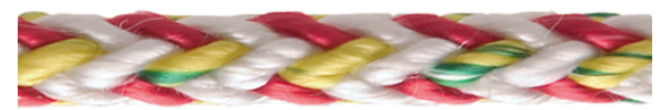

I need to replace my mailsheet on our Catalina 22. It’s very old and swollen, measuring almost ½”.
I’m looking to replace it with a 3/8” (9mm to 10mm) line. My 4 to 1 mailsheet blocks are Harken Carbo Air 57mm. We are not racers, but we like to go fast, well as fast as a Catalina 22 will go.
Every post I read people rave about NER Salsa. I keep reading about how it:
1. Feels great in the hand.
2. Runs well.
3. Won’t hockle.
4. Holds well in a cam cleat.
All things I would love in a new mainsheet. What I don’t care for is the price and the colors.
I’m looking for suggestions of other lines with similar designed/characteristics to Salsa but perhaps 25% - 33% cheaper. The color part will probably take care of itself, I’ve never seen any rope as unattractive as NER Salsa. When I showed it to the wife she said “NO WAY”.
What lines should I be considering? What will give me a similar (or close) feel and performance at a slightly lower price. So far these lines sound interesting:
Samson Control-DPX 3/8"
NER Regatta Braid 10mm
Samson MLX3
Samson Trophy Braid 3/8" – not sure about the fuzzy jacket?
NER Sta-Set 10mm
Unfortunately I'm at least an hour away from a tiny WM, so feeling any of these options before I buy is very unlikely.
(I posted this here as it seems to applies to any small keel boat, not just the Catalina 22)

The big deal about Salsa is the lay (rope talk for how the rope is twisted or braided) is very loose, this allows it to run through the mainsheet blocks quickly and easily and it feels good in the hand. Racers play the mainsheet a lot and this makes a difference, especially when rounding marks and setting or dousing the chute.
Nice but over kill for most of us.
