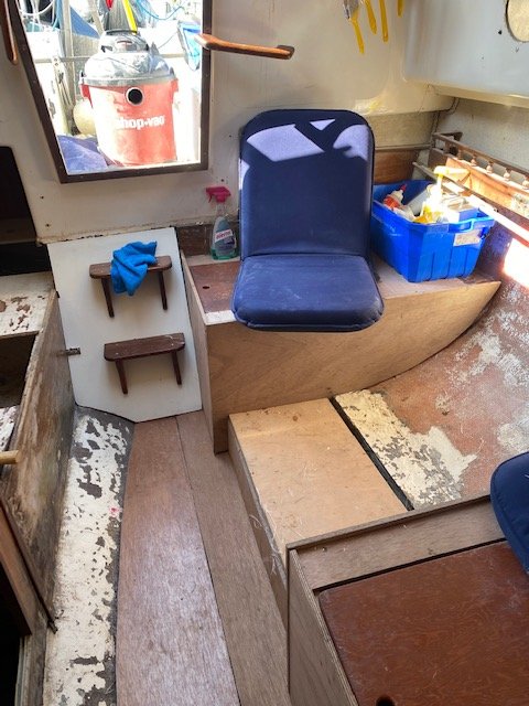

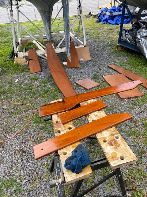

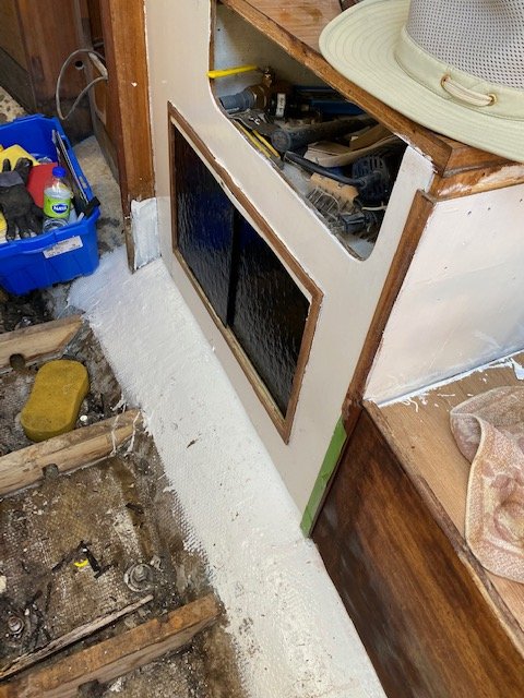

so I spent the morning on the boat, so far the floors have been cut and the mating surface has been ground down, now to clean it up and epoxy (six 10) them in place. While I was working inside my son and his friend were busy sanding the hull, still a bit to do and needs a good cleaning, now it's lunchtime and we took that time for a good shower, after lunch we're going back to clean up the bilge and install the floors. Tomorrow we'll be installing the new settees and glassing them in place.
Pics to come
Aug 17, 2013
1,069
Pearson P30 202 Ottawa/Gatineau

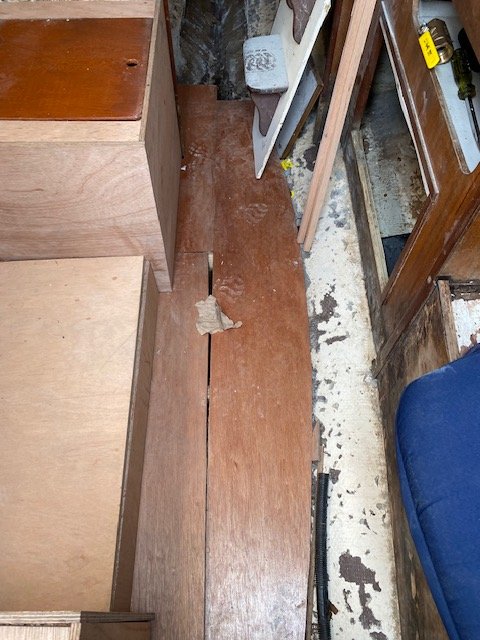

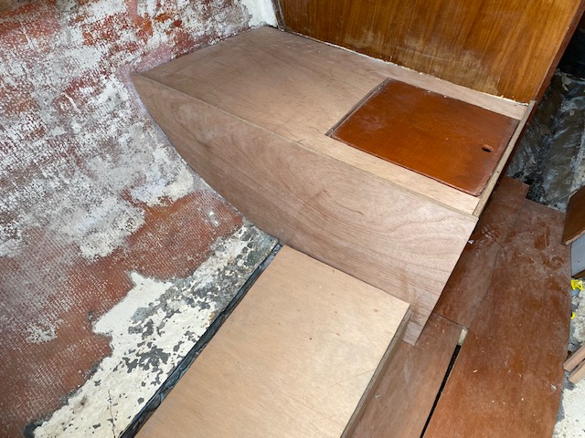

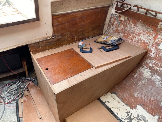

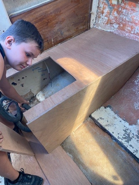

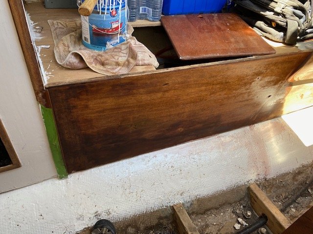

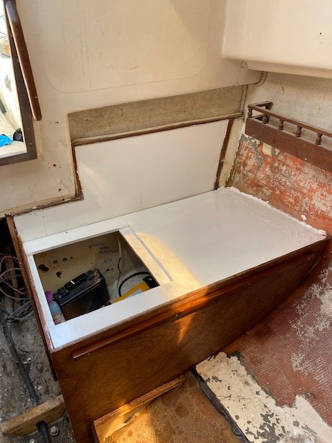

so here's an update, I completed the floors, just need to glass them over, finished the basic layout of the sole and painting the bilge, the settees are done, just waiting on the glue to dry, probably going to stain them teak coloraturas and oil them.
the sole just needs scarfing the edges to mate with the hull shape. then a few coach of oil on the top and epoxy on the bottom.

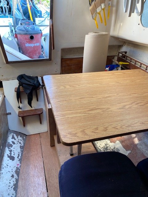

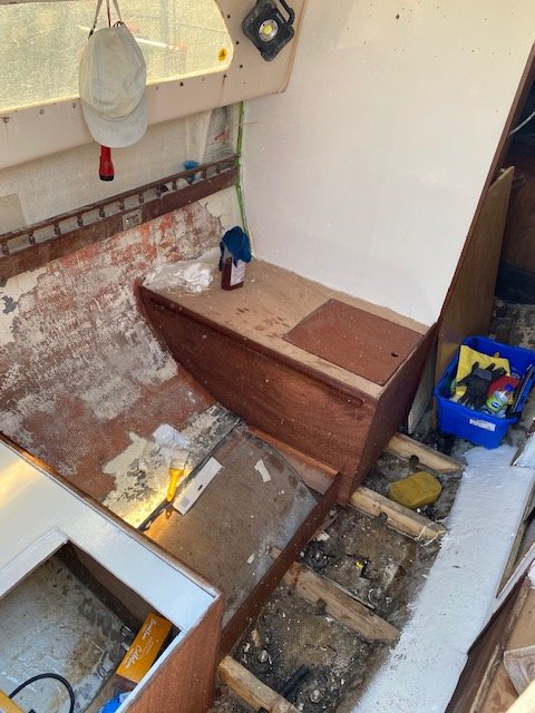

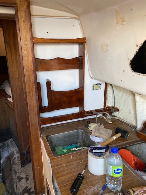

ok so I finally found how to get my pics smaller so here goes

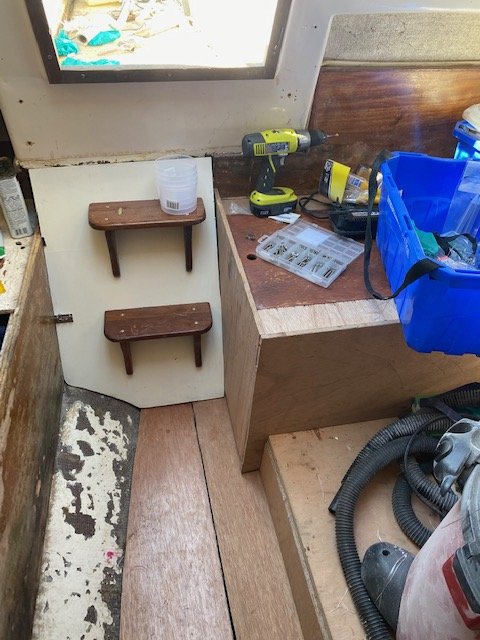

with the table in place:

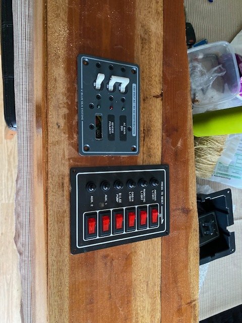

the start of my new electrical panel:
next a good clean up, add some moldings, stain and oil everything and paint the rest.

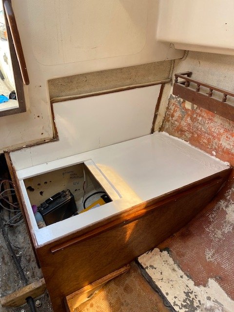

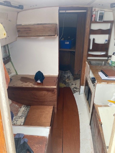

Vacations are over but I still have time to work on the boat, here is what it looks like after a solid weekend of work.
Likes: DArcy
12,652
Looking good Fred. Your first overnight will be epic.
If you are looking for a quick way to spruce up some of the raw fiberglass areas... I like the idea of using carpet tiles.
These are water repellent (exterior grade) and if you alternate the pattern, it looks intentional and you don't have to worry about seems.
