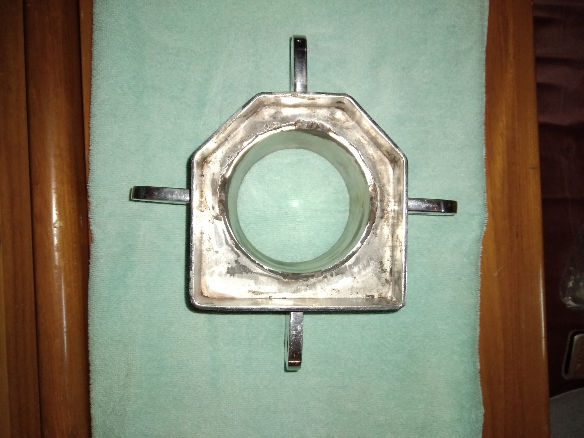

Anyone ever use allied titanium? I'm currently in a not so great situation with them. Starting to wonder if they are actually a legit company. Sent them my money along with my cranse iron and bobstay chainplate to copy and was told it would take 3 weeks. It's now going on 7 weeks with very little communication. I've been assured it was shipping out "soon" several times.

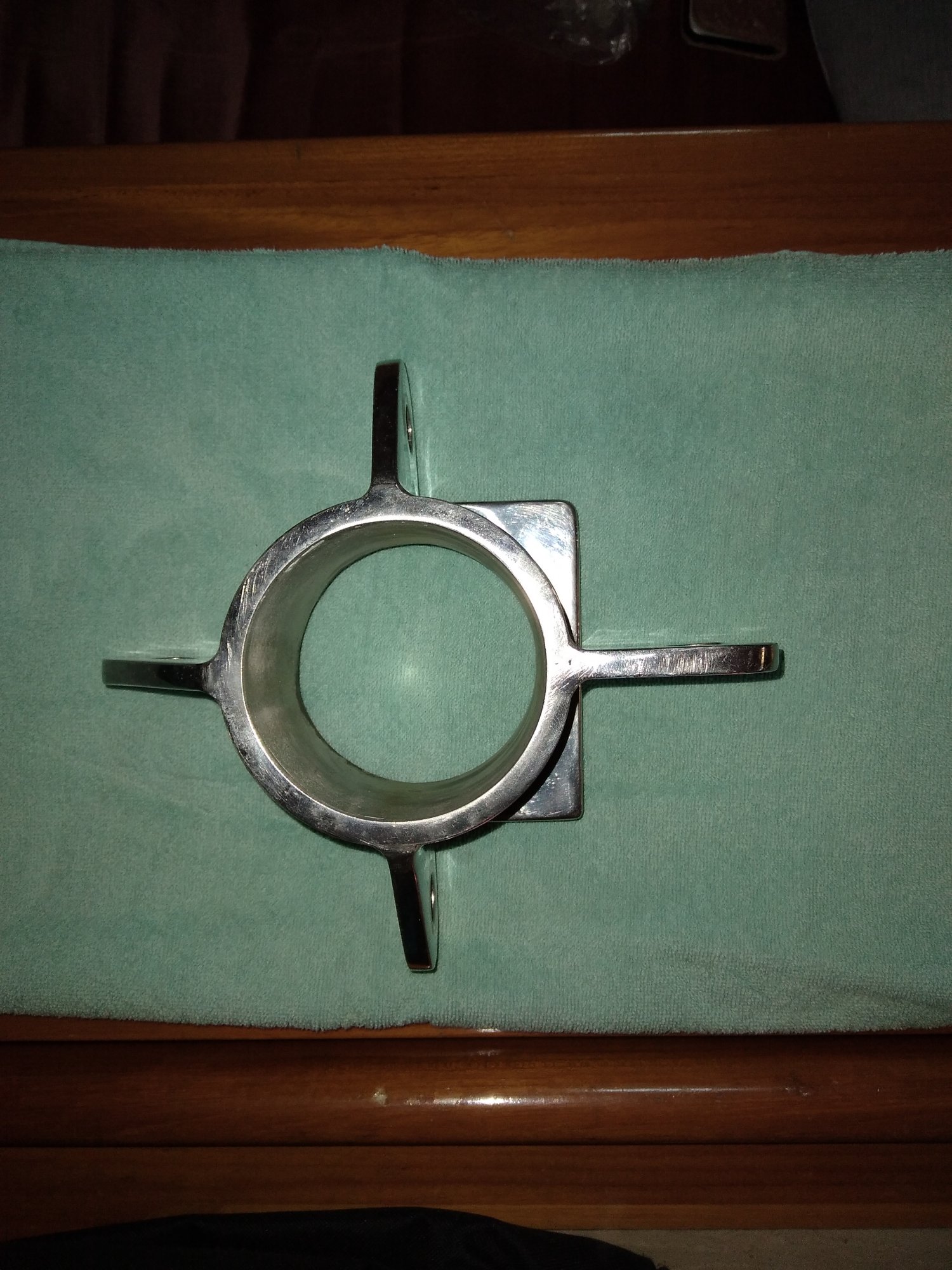

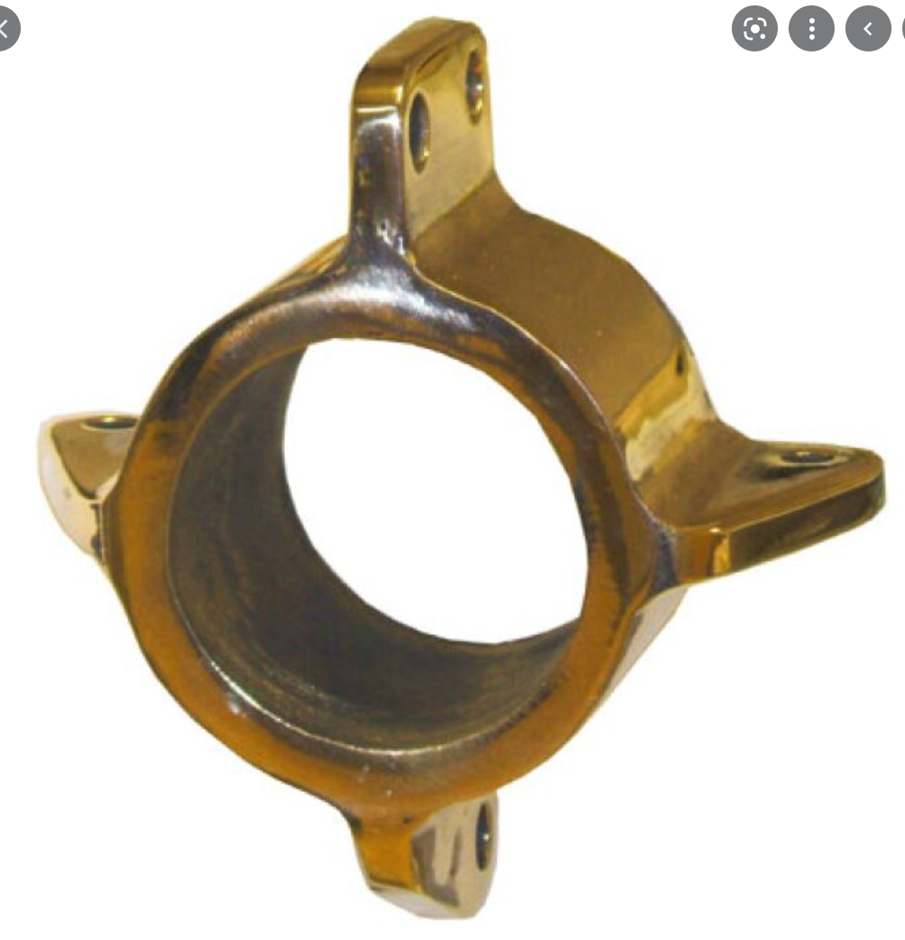

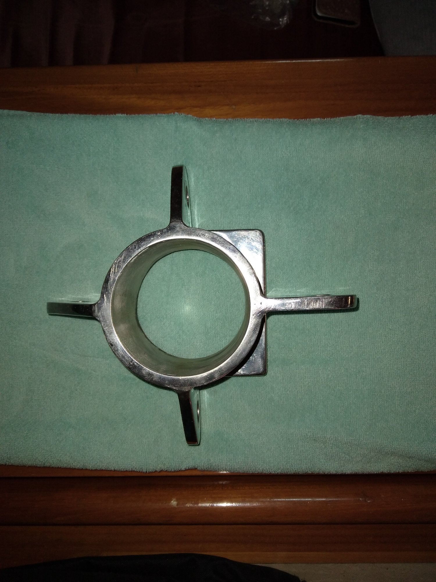

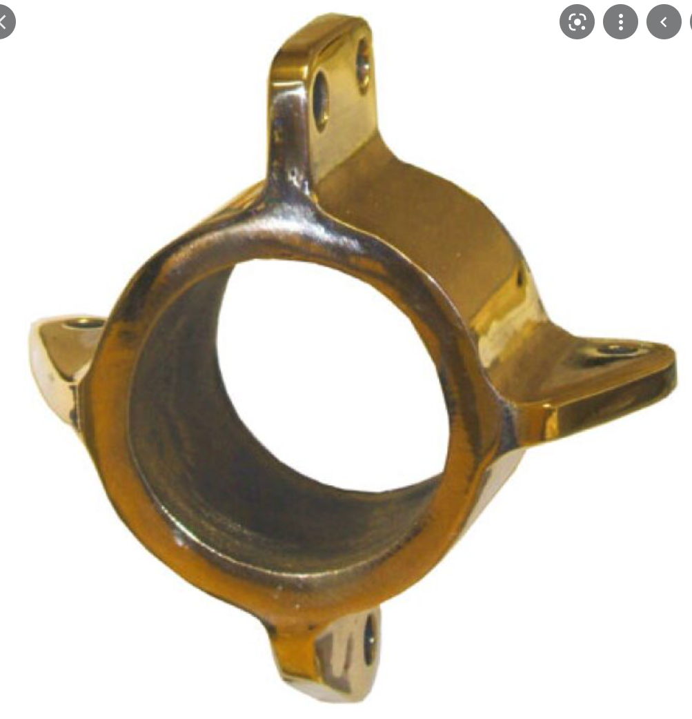

Does your canse iron essentially look like this?

Almost but not quite. It has a plate on the back that fits the shape of the bowsprit. Also none of those premade bronze ones were the correct diameter.
I doubt Allied Titanium has the ability to cast titanium. So I'd guess they are trying to figure out how to make it at whatever price they quoted you. It's not very economical to hog that out of a bar of Ti6Al4V (what I'd assume they would be making it out of). So you are left with three potential fabrication methods - casting; welding; 3D printing. It's unlikely there is a 3D print facility with a large enough printer to make that part - at least on a for hire basis. So that's out. So they are left with finding a casting house set up for Ti6Al4V - the job shops I'm aware of have long lead times to get a one-off made - like months. So you are left with fabricating this part with a lot of welding being done.
If I was a betting man, I'd bet they are wishing they'd never taken this job...
Just out of curiosity, why did you go with ti on this part? Why didn't you go with a custom cast bronze replacement? Was there something wrong with the original stainless part you have pictured above?

DLj I wouldn't expect that they would be casting it from titanium. I would expect they would be fabricating it out of probably flat bar or plate and welding it up. The original stainless part had some crevice corrosion on it that I just did not trust. Honestly I chose titanium not only because of its properties but because the quote was better than having it cast in bronze.

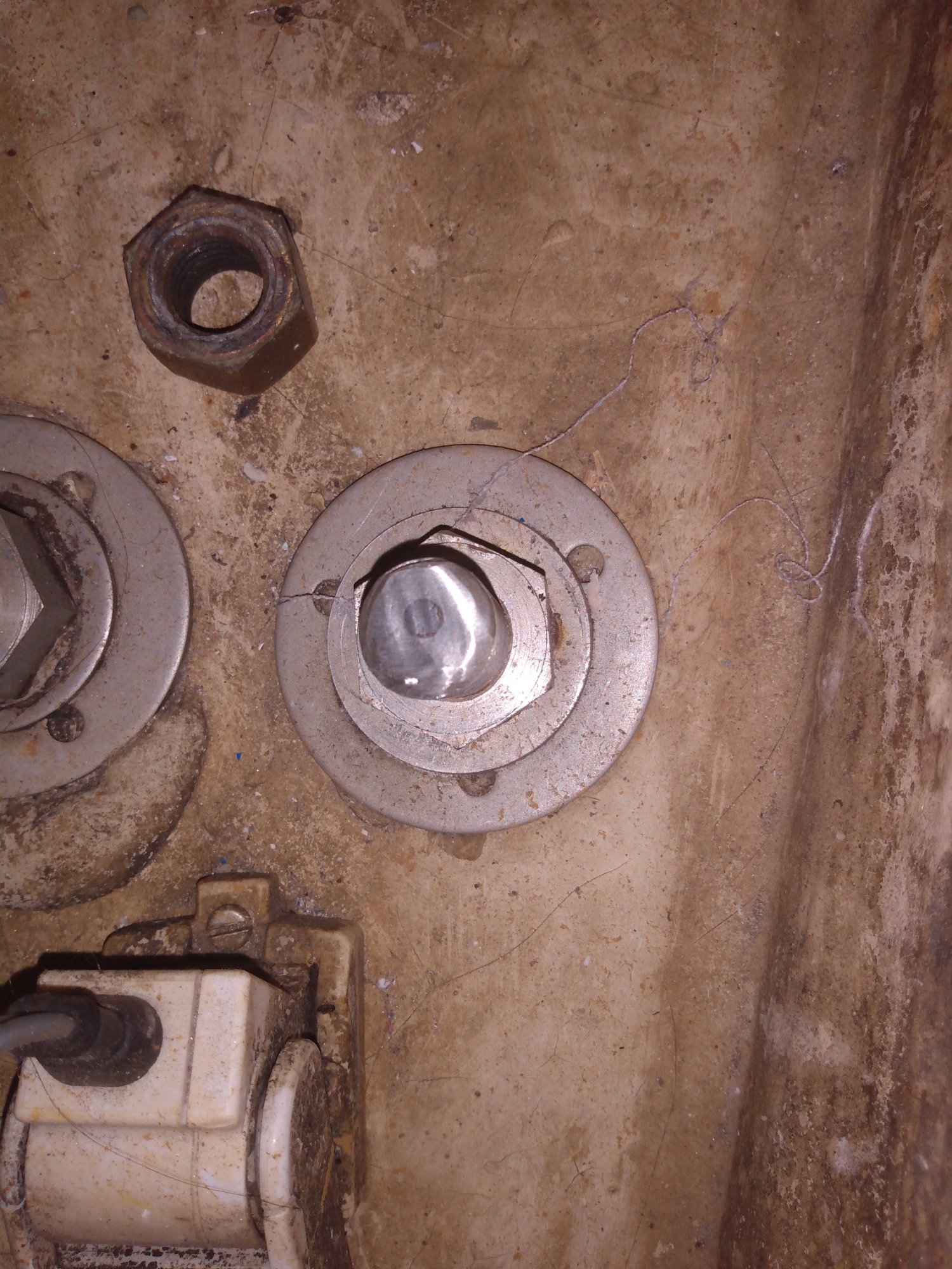

I have personally seen stainless steel that appears to have only minor signs of corrosion on the outside and attempted to sand or grind to sound metal only to find it completely corroded inside. As far as the 2 most common grades, Ti6Al4V or grade 5 should or would be the only of those grades used in a structural application. Ti6Al4V you said yourself is stronger but also it isn't prone to crevice corrosion like stainless is. I have attached 2 pictures that illustrate why I chose not to use stainless. They are both of the same keel bolt. On the outside everything looked fairly normal until the nut was taken off and it was revealed the inside of the bolt was pretty much dust. I would have been just as happy to use bronze it just so happened the titanium quote was more financially attractive.

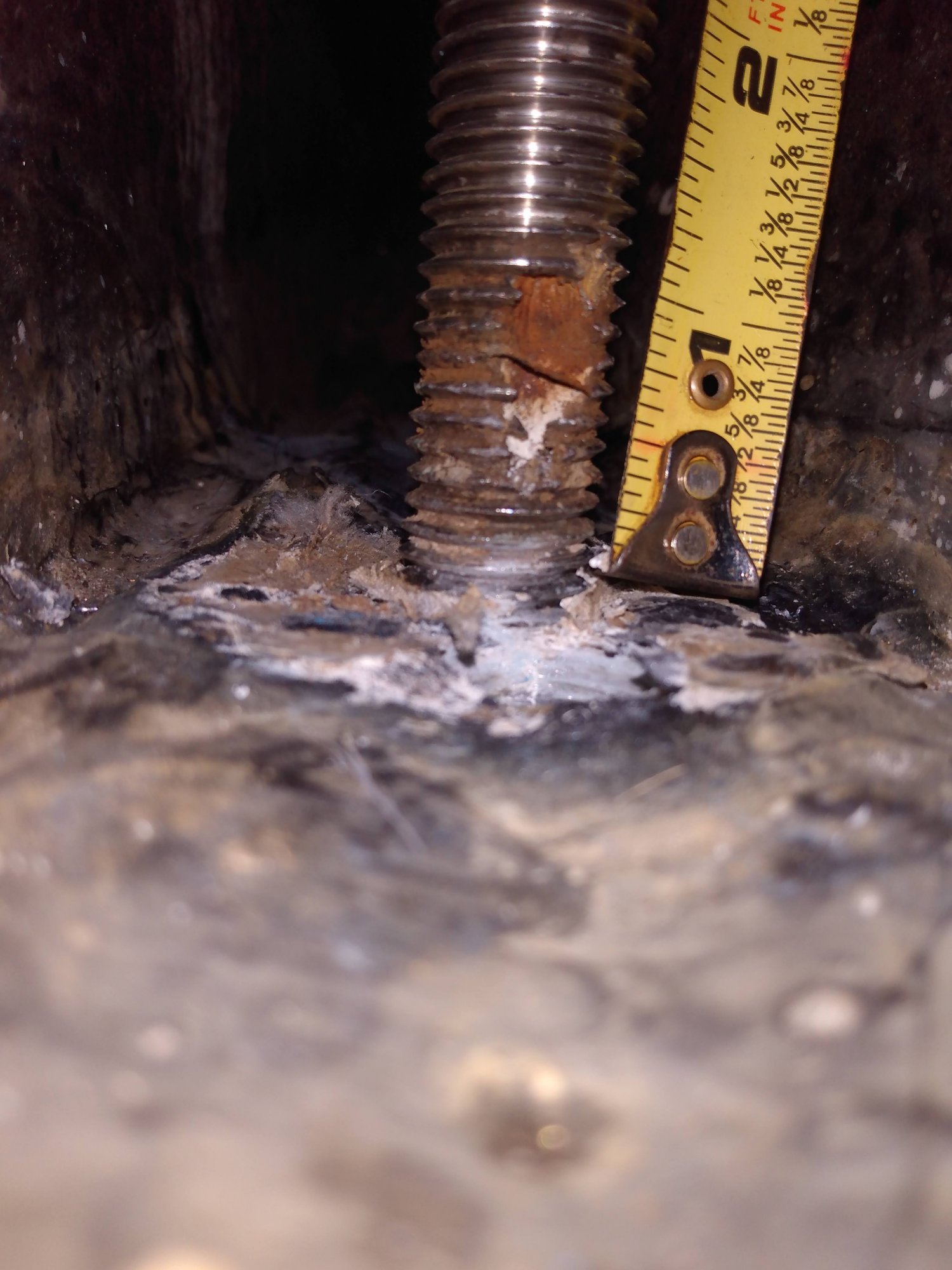

The description you give above is not an inside-out mechanism as depicted in the video I mentioned. It is an outside-in mechanism. It is an insidious mechanism and difficult to see although to the trained eye not so much. In your above to images, I'm not sure what the left hand image is, but the right hand image looks like a keel bolt with a likely SCC crack showing.
What the aerospace industry does, that we do not do in the marine environment, is frequent inspections. So in your keel bolt example above I'm sure that the nut was never taken off that bolt to inspect the bolt prior to there being a visible concern and then it was found what you've photographed - likely many years after initial service. I wonder if that same corrosion would have occurred if there had been an annual or even a bi or tri annual inspection where the nut was removed and the bolt was inspected. That process in itself likely would have eliminated that failure. The aerospace industry identifies known critical components and points of failure and then establishes an inspection method and frequency where those points are inspected at defined usage intervals. We don't do that with our sailboats. Nor do I propose we do,but I do support that alloy selection be done with greater scrutiny.

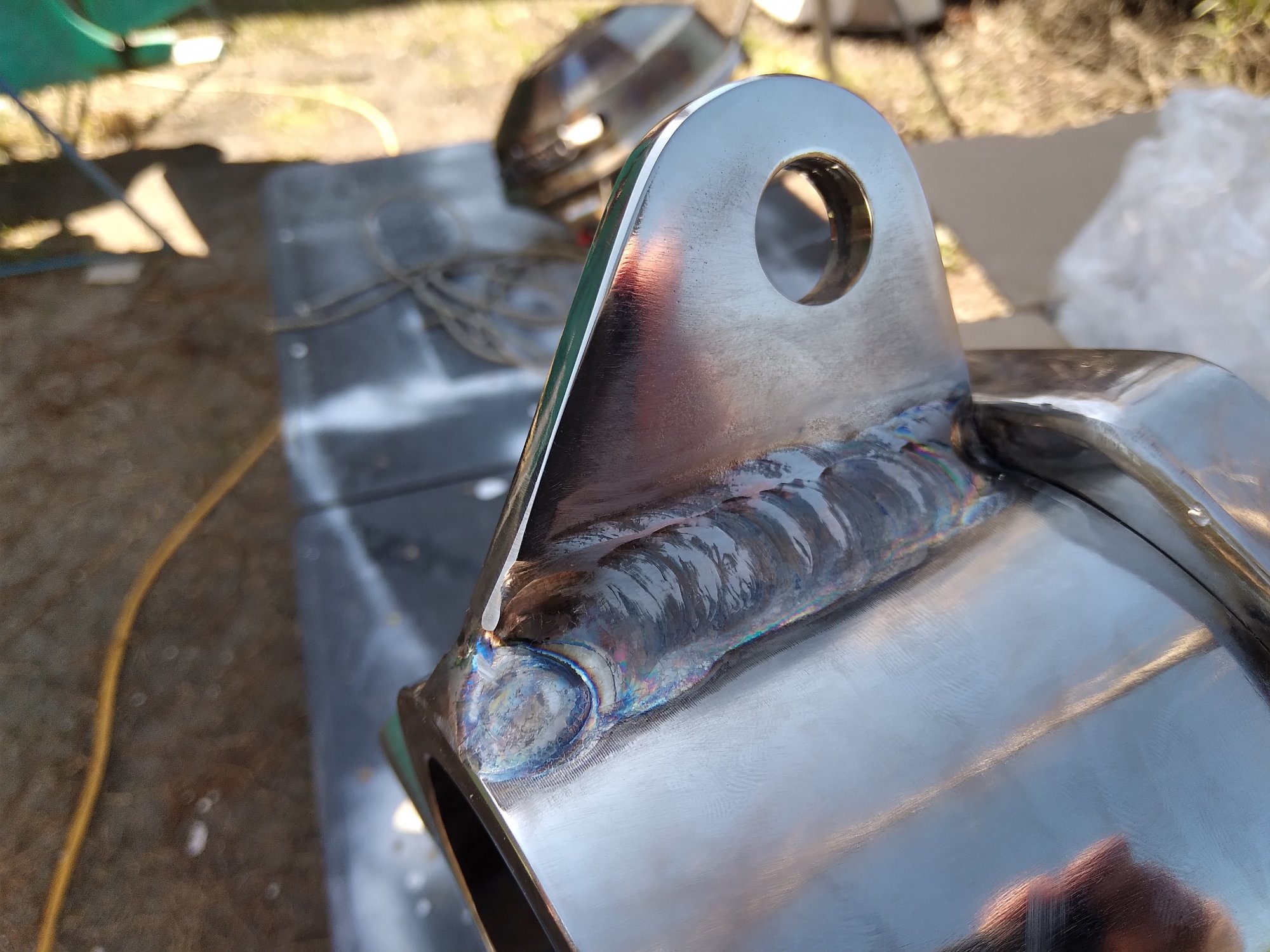

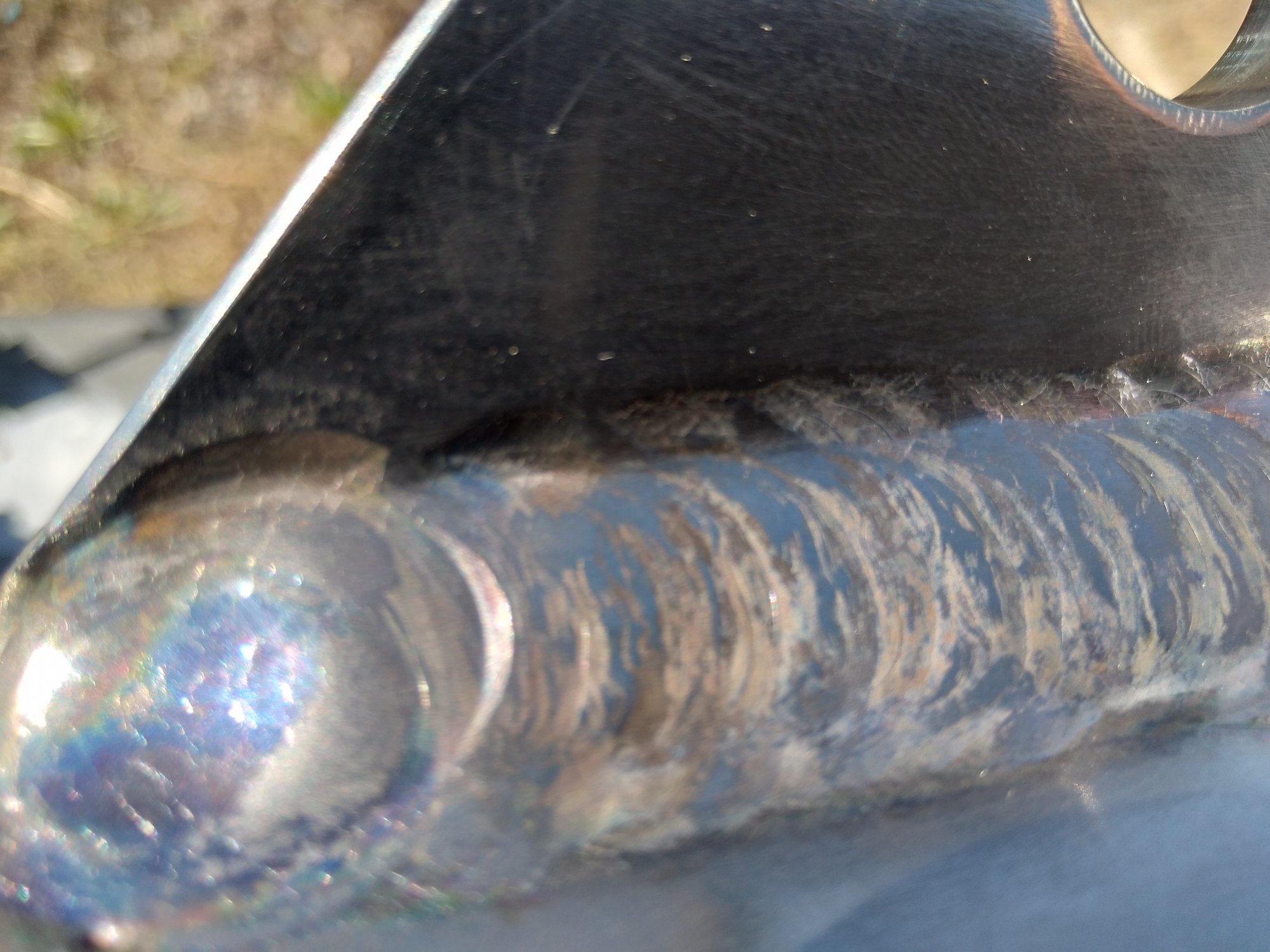

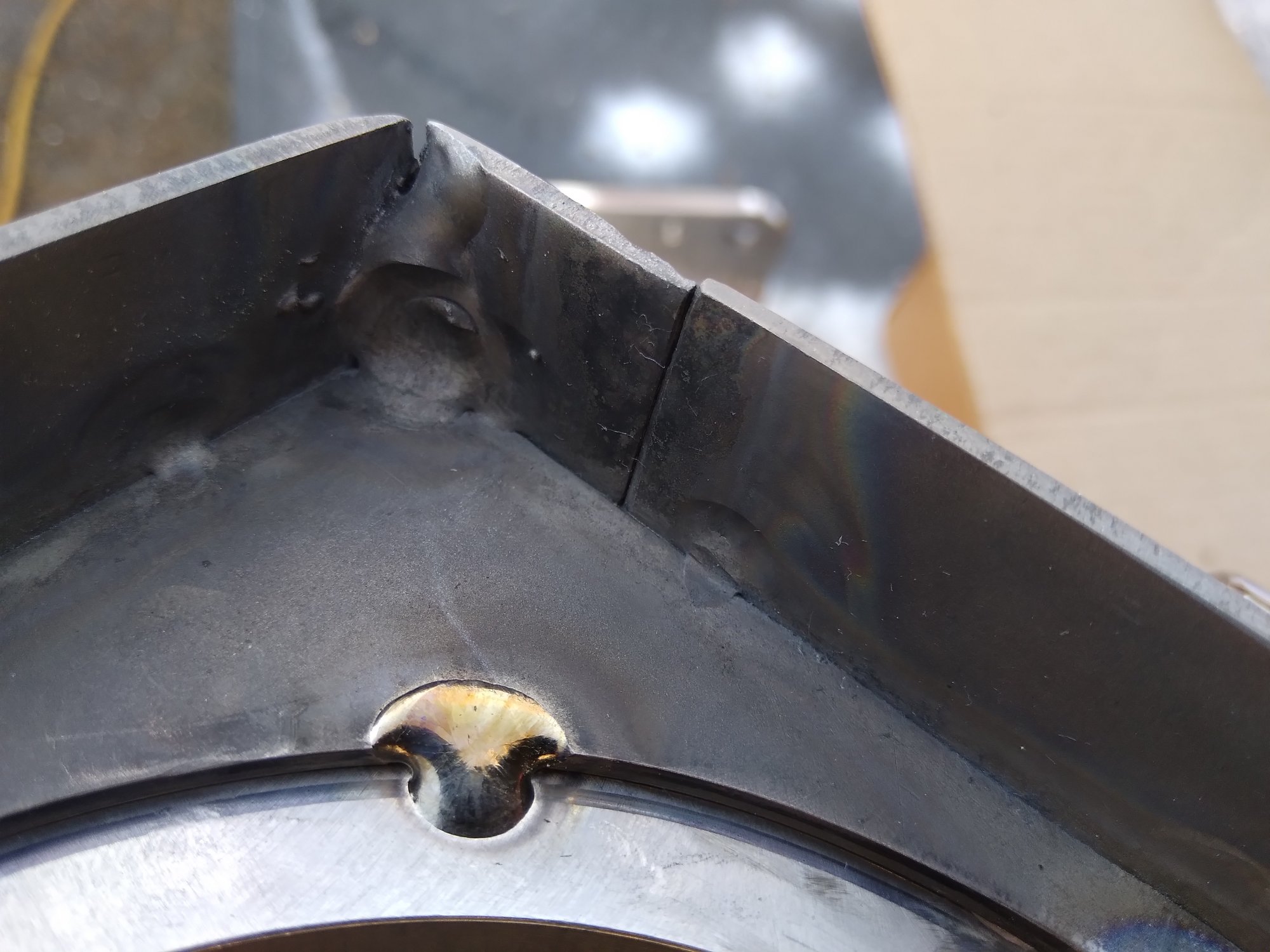

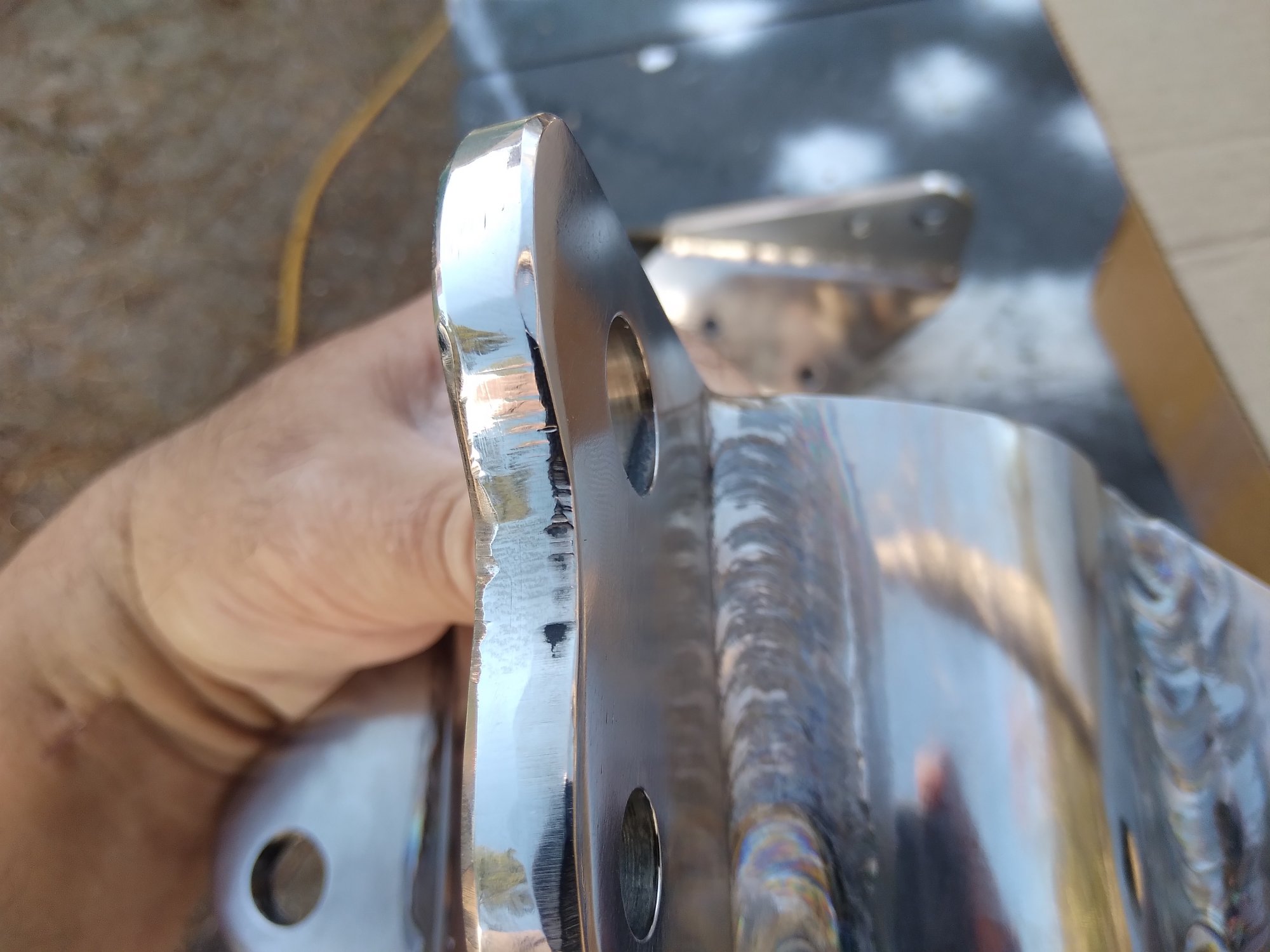

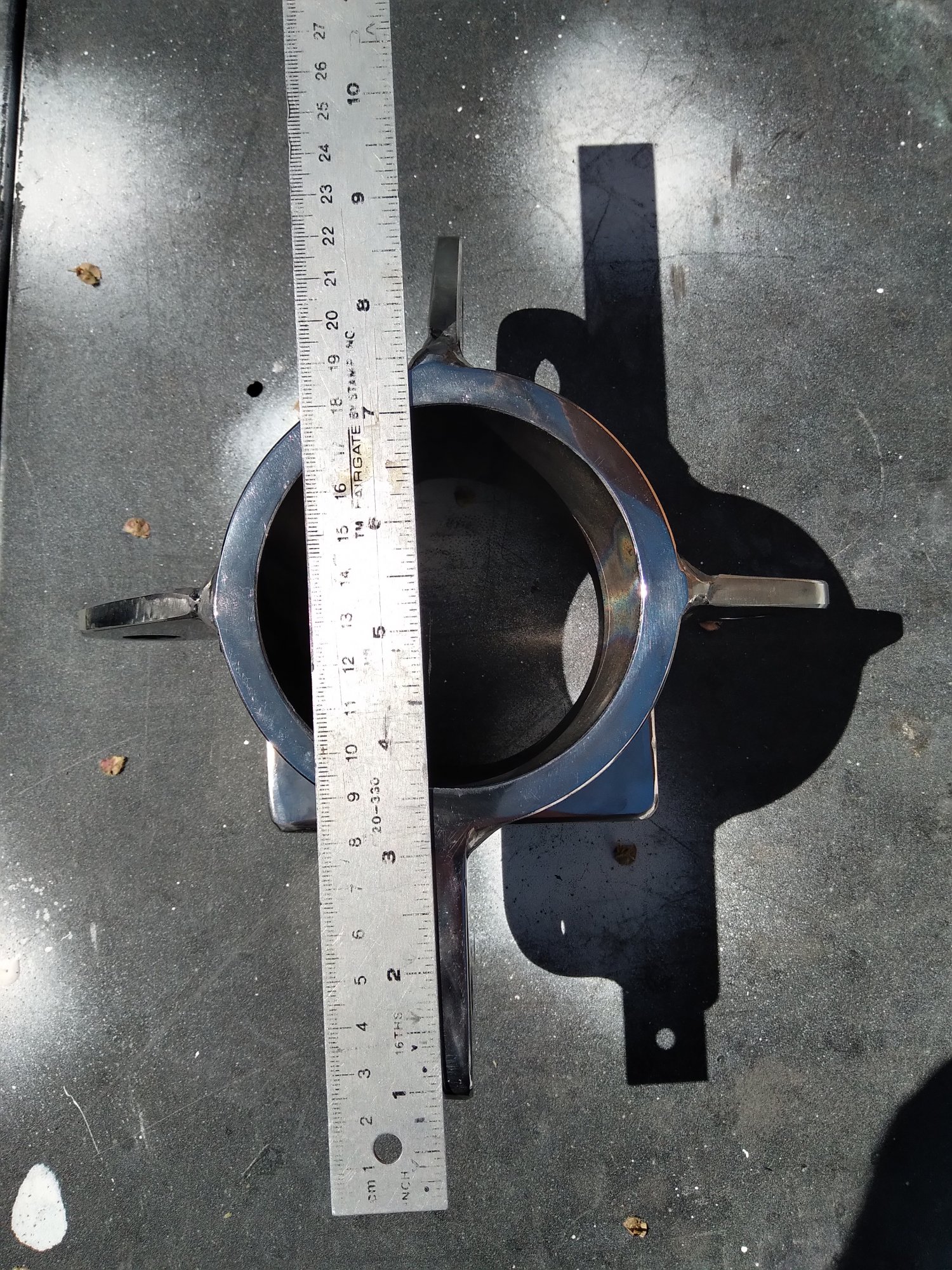

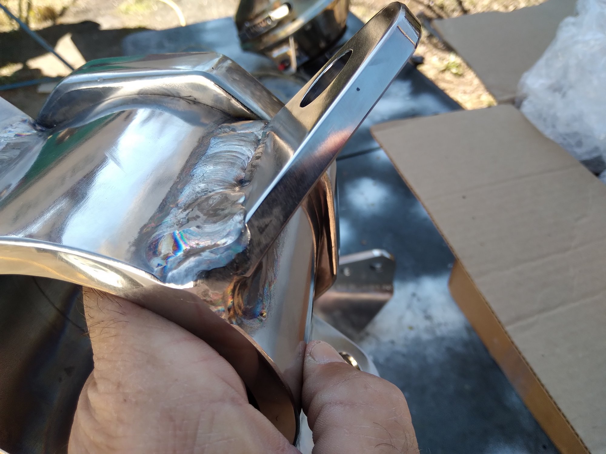

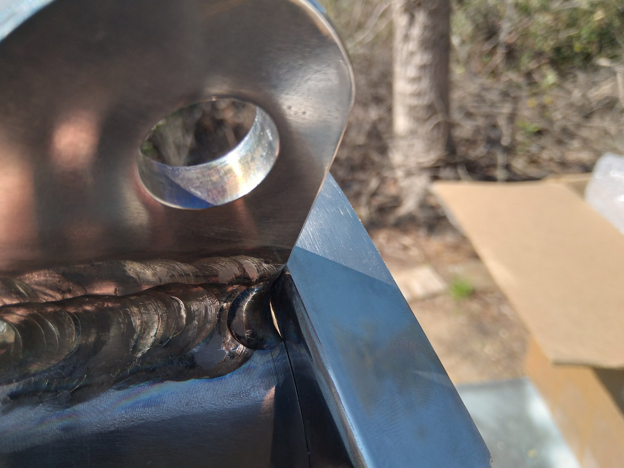

Thought I'd update the post. After waiting 8 weeks the parts came. Allied Titanium's work was absolute garbage. It was all sent back.
