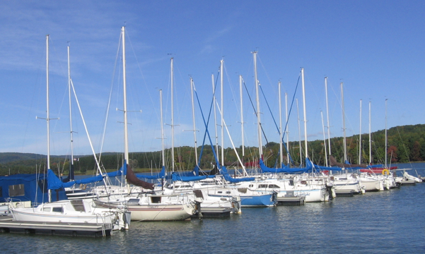

Over the years I have helped launch and recover each one of these boats in the attached picture.
