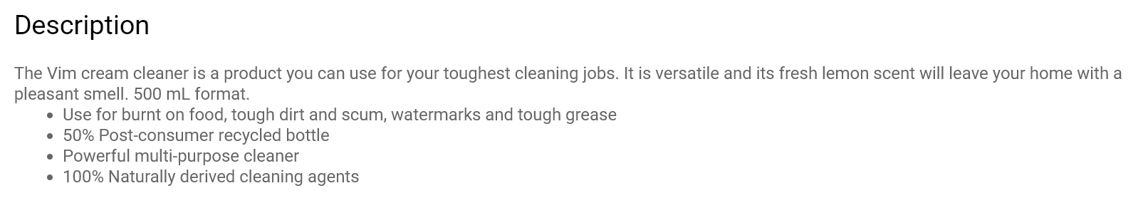

Recently, I have been finding bloody awful layers of algae, mold, and God knows what all covering the non-slip of the boat once the cover comes off. Something I discovered years ago, which really has the ability to get into the crevices and remove everything is a cleaning product called VIM :
Mind you, "100% naturally derived cleaning agents" is pretty questionable when it comes to cleaning products. Probably not much worse than most others but it does smell nice.
I've found that if you lightly scrub it in and then wait a few minutes, and then scrub again, it will remove anything organic.
It may be less harmful to your teak, maybe not. Only time will tell.

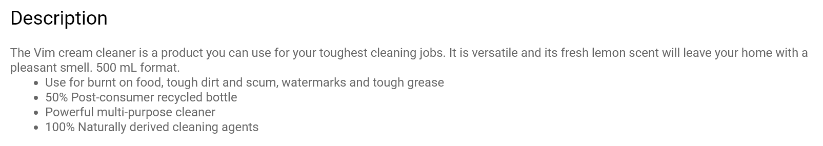

Perhaps you may be able to back up a step and find something less aggressive to use on the non-slip rather than bleach.
Interesting, thanks. Maybe i can find out what the general ingredients are. Sounds maybe like a citrus based product?
