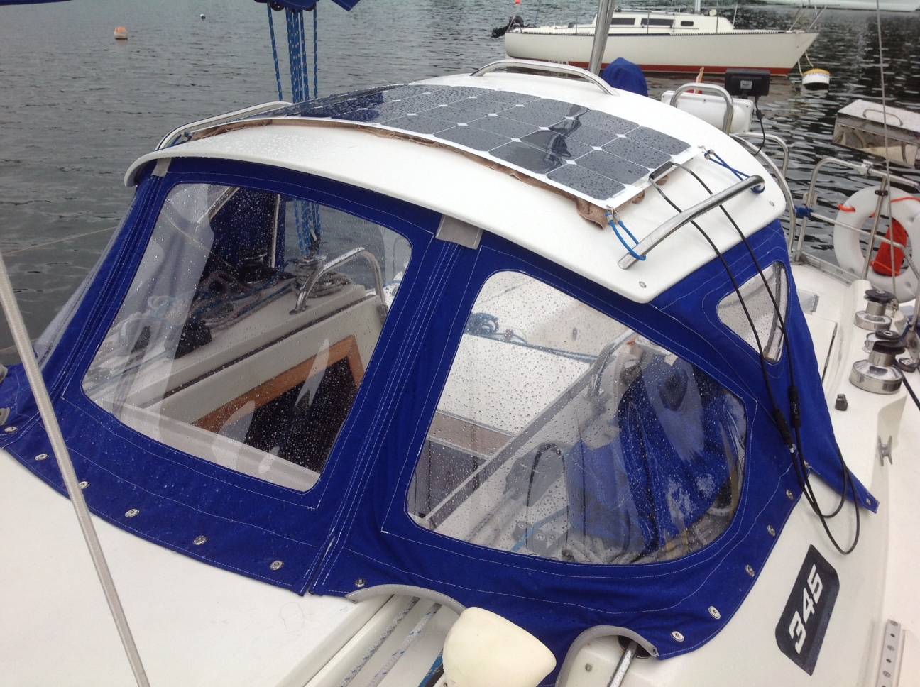

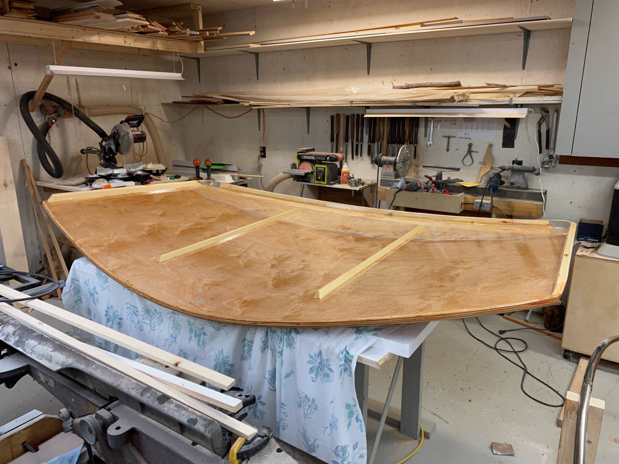

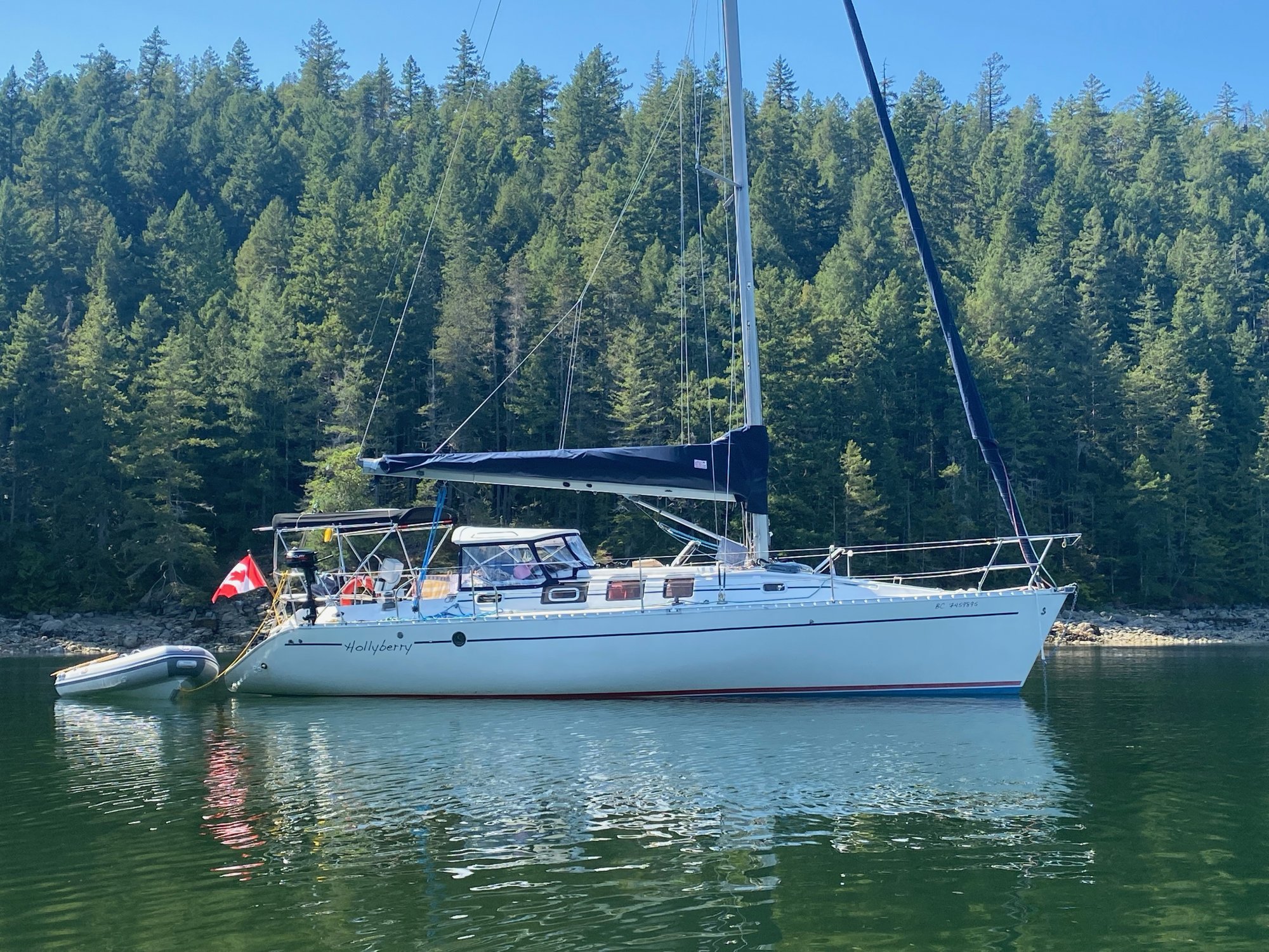

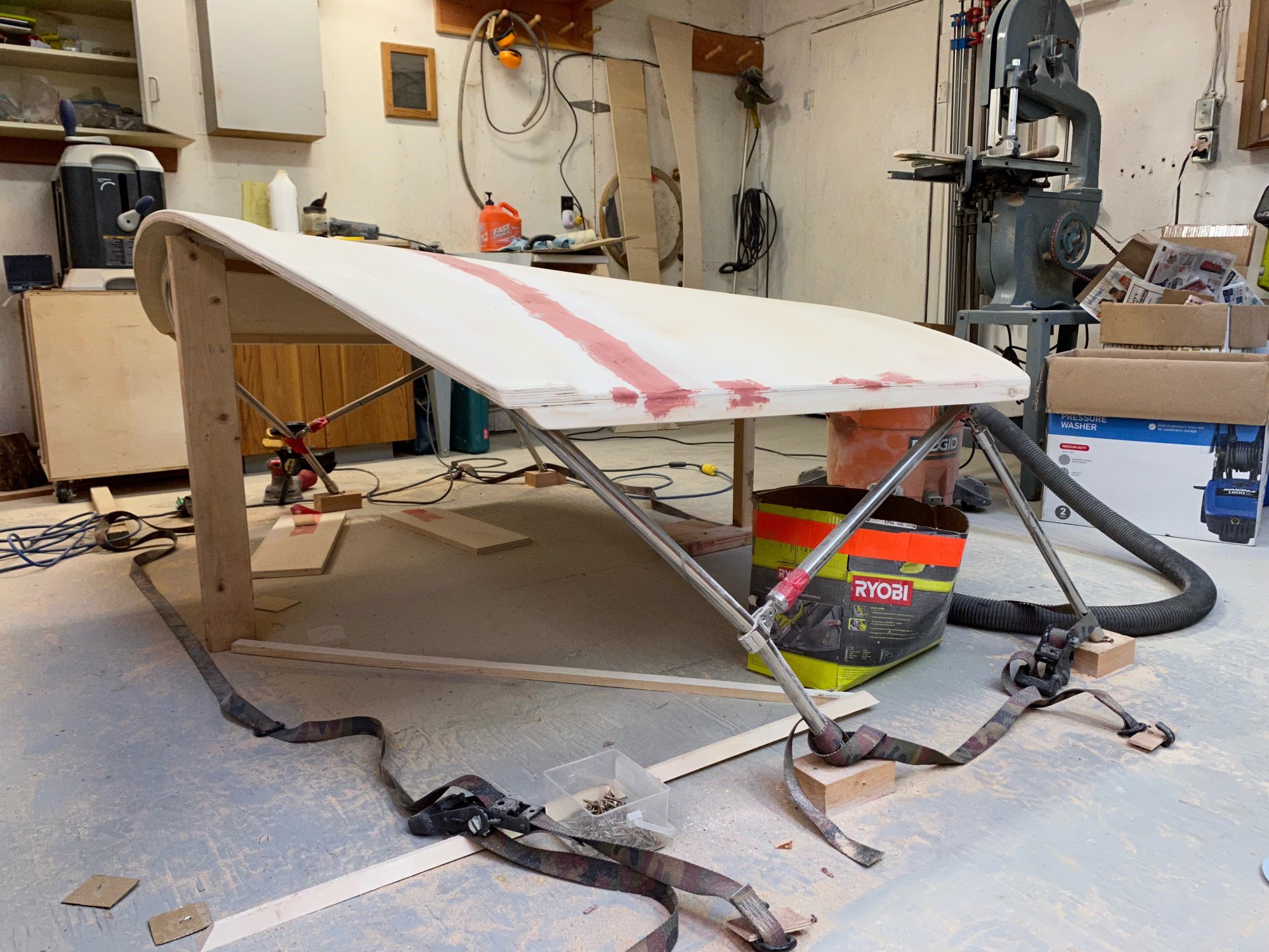

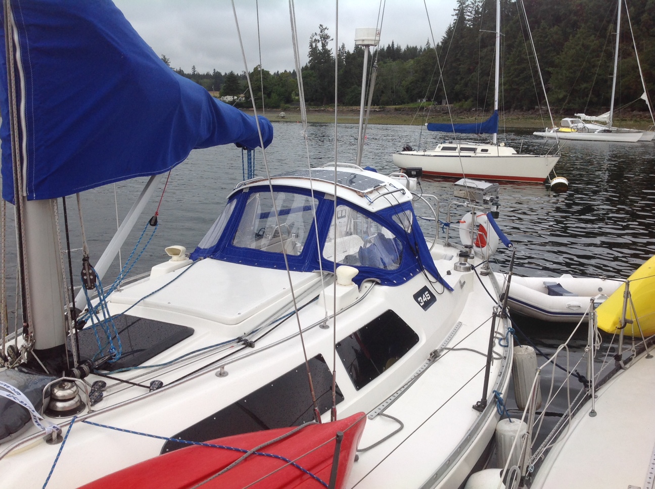

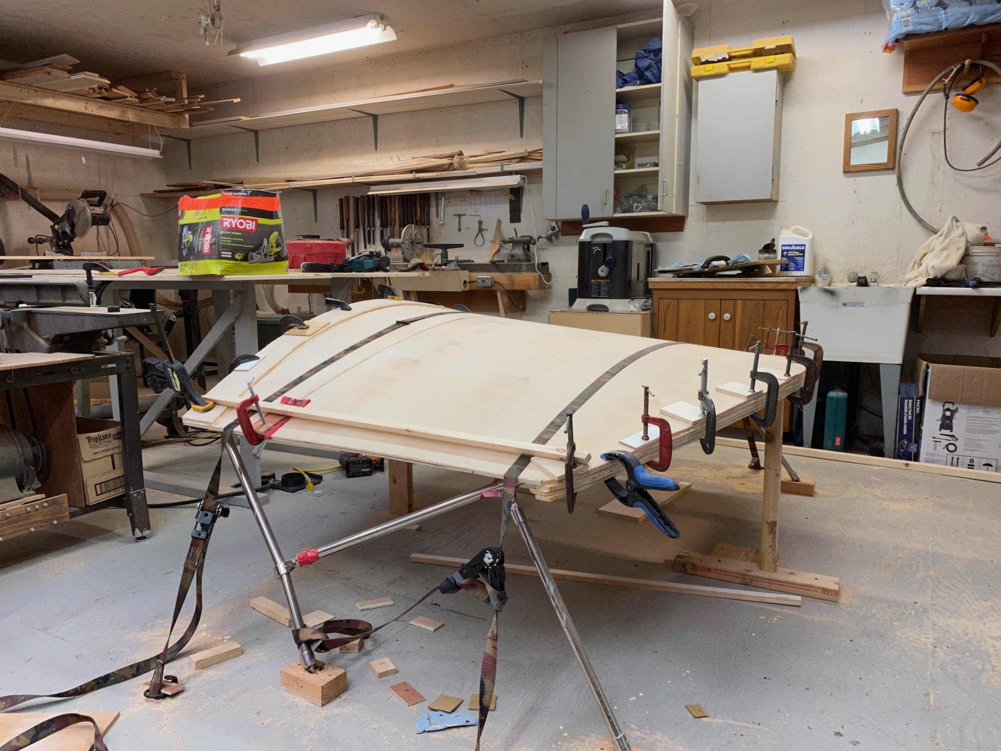

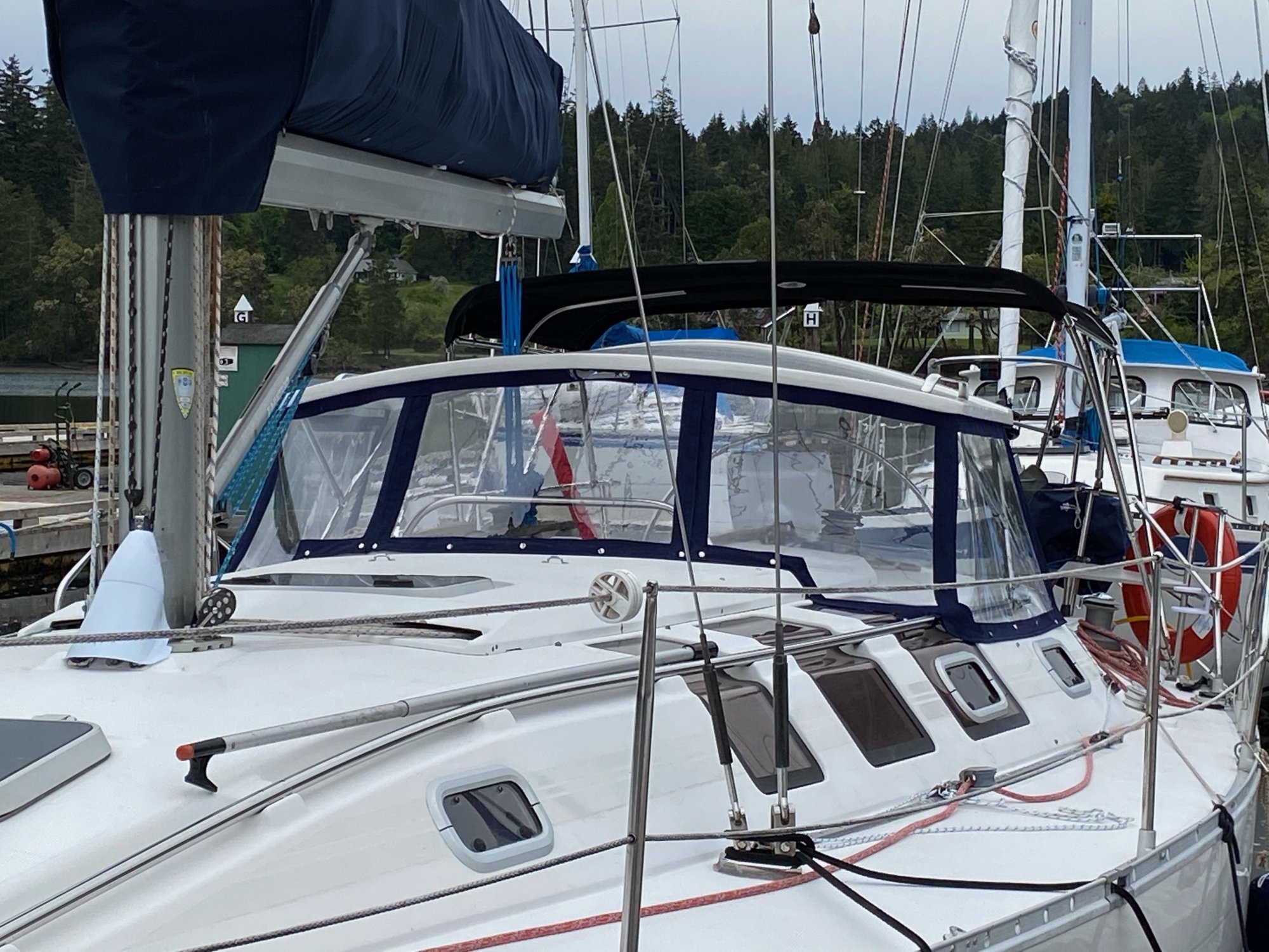

After many years of canvas dodgers that ultimately eventually leak, on our last two boats we build hardtops that attached to the original dodger frames. Plywood layers, epoxy sealed and painted to match the boat's gelcoat. An unexpected benefit of this is, when painted a light/white colour the amount of light below is greatly enhanced. We continued with the canvas/vinyl/lexan etc 'windscreen'..
.IMG_1267.JPGIMG_1268.JPGIMG_0478D.JPGIMG_0480D.JPGIMG_0484D.JPGIMG_0603.JPGIMG_0817.JPG

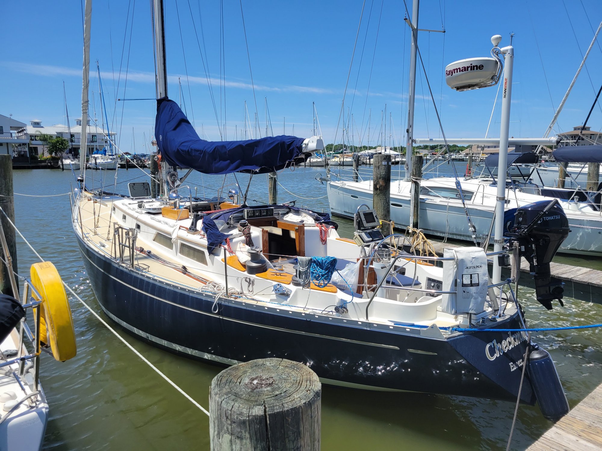

Thanks for the reply. You're right, I didn't really show a good photo. The Alden 44 has a very unique transom, which is why I asking for input. Here's a much better pic.
I will continue to race casually. As I do longer races, such as Newport/Bermuda, I would take the canvas off for that trip. In casual races, it will keep my beer out of the sun!

Jon, I really like your hardtop. What thickness of plywood did you use and how many sheets/layers did it take. I do like the idea of a hard top eventually, but in the short term I'll likely do one more canvas.

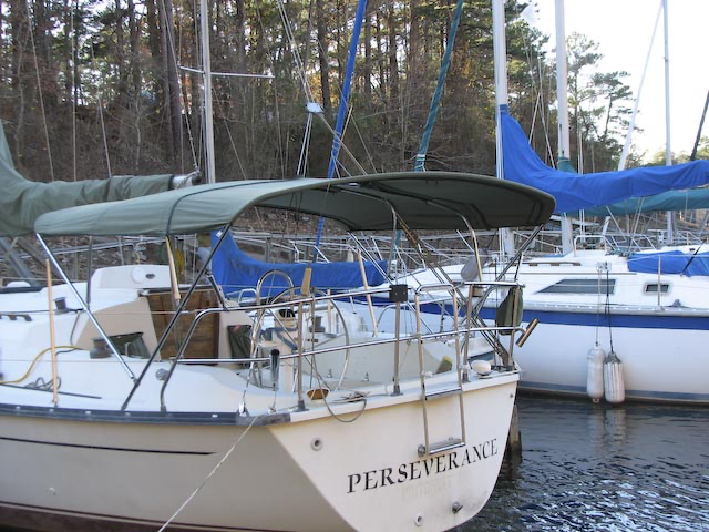

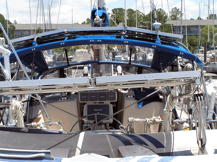

Nice looking boat Tim.. There are a variety of Bimini's and connecting cloth options to give you a roof on your Cockpit. Often the designs are multi level to give you room toe stand up.
This one gives you a cover from the end of the boom to the stern.

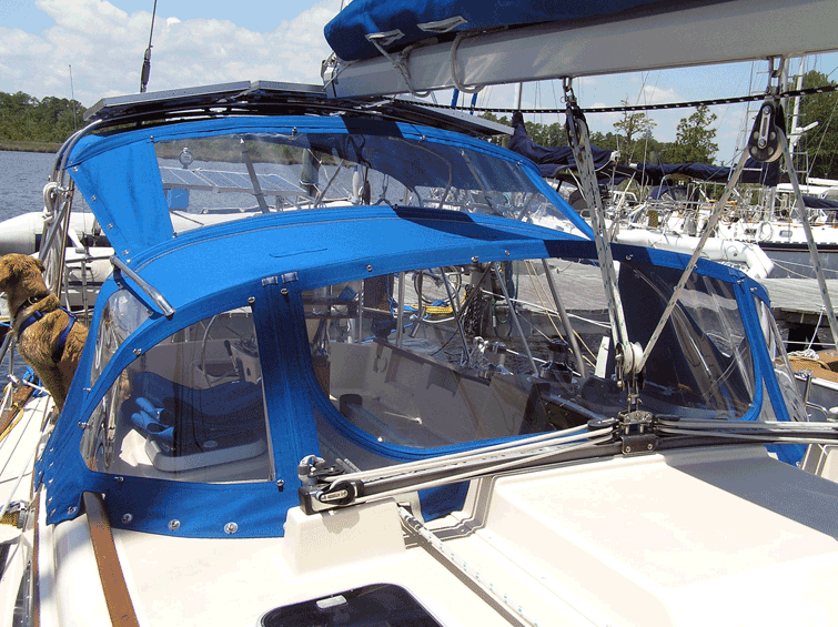

Here is a 2 level connected by a center piece. Note the use of clear vinyl to give you vision of the sail trim while hiding beneath canvas.
You also get visibility to the foredeck and over the bow.
The options are endless. Often side curtains are used to give the owner and crew a comfy outdoor inside heated space.
