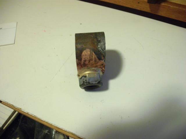

Hermit, Brazing is very similar to soft soldering but with alloys that melt at higher temps and are in the 35,000 to 45,000 psi strength class. Do be afraid of learning it. You will find a whole new world opening to you. Google All Fuel hose you will get several hit , Goodyear, Trident and others.
Ross
Jun 15, 2004
14,693
Hermit this picture is for you. Just an example of what can be done with brazing. Steel nut and copper pipe.

That is impressive. I may end up soldering the pieces together. I didn't make it to the harware store today to see if I could just thread it all together.

The brazing alloy is called blockade by Harris needs a silver soldering flux but it is a charm to use. Look to the welding supply shop.
