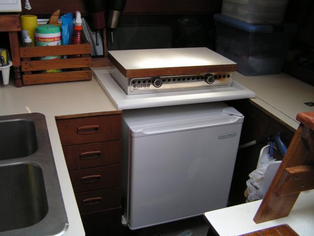

here's a conversion to think about. Origo 6000 removed, stovetop (essentially a 4000) taken off it and reused in a custom mounting platform. Small 1.5 cube dorm-type fridge set in the space below...
