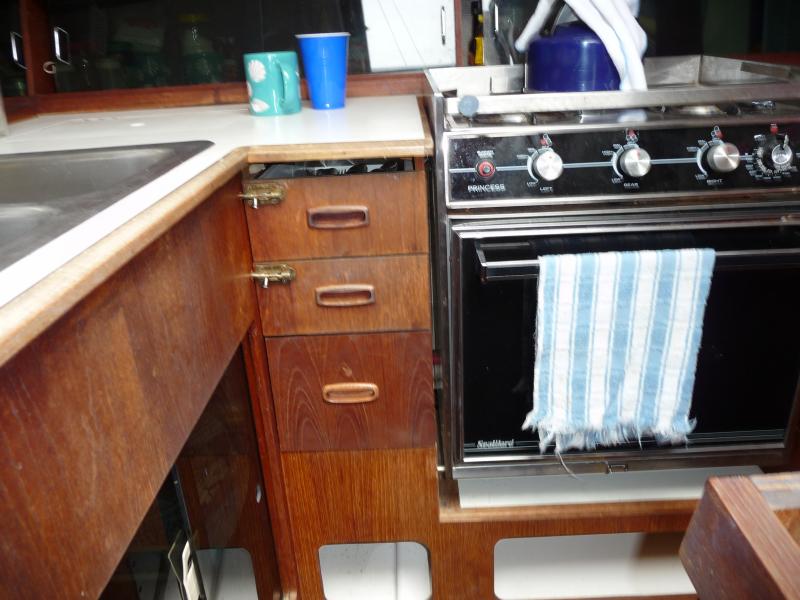

I will chime in here - we had the same propane stove/oven as Claude in the picture (Seaward princess 3 buner + oven) on my Ticon-30, and we have a force-10 propane stove/oven unit on our H36, and I really like them.
Even though we are not liveaboards, having the oven with decent thermostatic heat control opens up a huge amount of options for cooking - even on weekends.
When everyone else is having BBQ for the 200th time, we can chow down on a nice baked Lasagne, roast chicken, or other tasty option because of the oven capabilities. Freshly baked croissants (taken frozen from home) with jam and Brie with your coffee will go down very nicely with that morning coffee......or baked quiche !
It really depends on how you use the boat - but if it is your cottage, you might want to give it some hard thought - for us, having the propane oven is a big deal !
