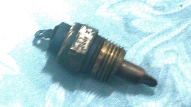

This is the temp sensor I think is the problem. I could replace it if I knew corresponding part numbers. Advanced auto is nearby and they have no way to cross reference a perkins 4.154. Btw, there are 2 on the engine, one for the guage and one for the alarm. The guage sensor is at the other end of the head, mounted to the thermostat housing and indicates 180 degrees.
Anyone know a generic part number? This one has 200f (temp) and 363-f.
Outside of threads measures about 3/4" perkins says they are 1/2" pipe thread.

Here's another update:
Put the temp sensor back in. Ran the boat for about an hour & finally did get an alarm. The alarm sensor was reading 188 degrees with my heat gun when I pulled the wire and stopped the buzzing. The guage temp sensor mounted to the thermostat housing was reading 179 and the thermostat housing itself was at 181. The alarm sensor is at the other end of the head, at the rear of the engine (4 cylinder perkins 4.154 62 hp diesel).
The temp sensor has 200f stamped on it. I assume that is the temp when it triggers. Looks like the sensor is defective. Am I missing anything?
I'll order a new sensor in a week or so when I'm parked somewhere.

You could just test the switch, It is normally open below the set temp (200 F in this case) and closes above that temp.
Just put it in a pot of water with a thermometer on the stove and heat while measuring the resistance. When the resistance drops dramatically to almost nothing that is the temp.
