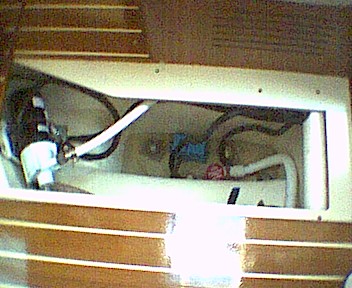

Hi all, Appreciate any assistance. Aircon issue on Hunter 33 2004 although I suspect same unit used in most similar age models. Noticed only fan operating, not cooling, no discharge overboard. Traced incoming line from sea cock strainer to pump under floor in saloon outside head. Suspect pump not operating. Has anyone had same issue?

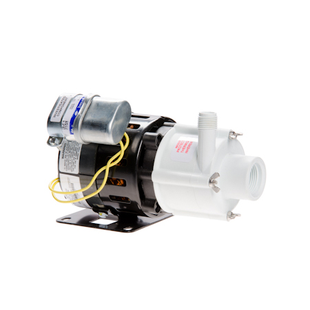

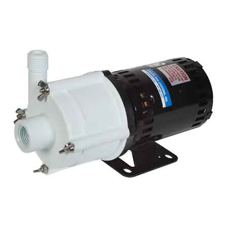

In the past Marine depot was one of my sources and another time I found one on ebay...... The original pump I believe is a 4-something?... it came original on boat 12 years ago. Here are couple pictures of what my pumps look like. I have included a few links so you can shop around and pick out the best deal for you. I do not know if the SBO store here carries them here, but you can check and see. Try to go with at least a 3-m????.. Breaking news...Just checked an old email correspondence from quite awhile back with Marine Depot and this is one of the models I bought from them LG2145 LITTLE GIANT - 4-MDQX-SC INLINE PUMP 1 $216.99
Shipping: $1.05
Subtotal: $216.99
Tax: $0.00
Grand Total: $218.04LG2145 LITTLE GIANT - 4-MDQX-SC INLINE PUMP..... I think the 4 series is a better choice. Just make sure its a 120 volt model. They are very popular for salt water aquariums and designed to run 24/7 ....
The models I have are not rated to be submersible.... But I have not had a problem. I did have an incident last year were I was in the back of the boat flushing and cleaning while letting the hose run water to the bilge. I happened to climb out of the rear lazzerette and ran down below to get something and noticed soap bubbles coming out of the bilge boards figure holes.:eek: All three pumps were 1/2 submerged and still running the pump motors air cooling fans were blowing soap bubbles. I flipped the breakers right away and then I gave the main bilge pump an ass whooping...:cussing:... Once bilge was emptied they started right back up like nothing ever happened....... Only one pump is showing any signs of rust on its casing and its the newest one with the external capacitor .
