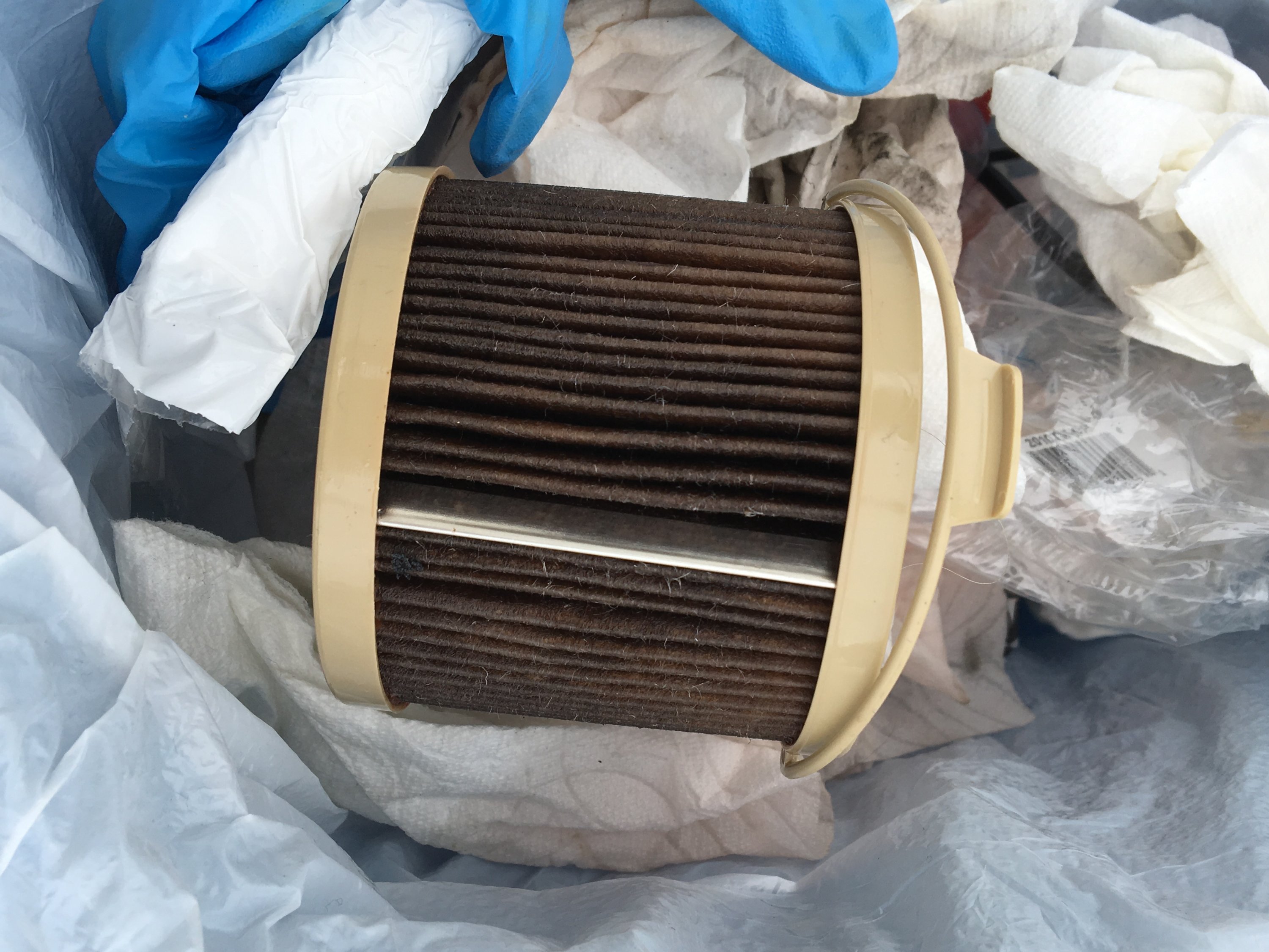

Oh And here is what a dirty filter looks like.
This is the 30 Micron filter from my Racor 500. The vacuum gauge was indicating that fuel was not getting to the engine. The engine had been running smoothly for over 6 hours. Suddenly RPM's changed, surged. Shut engine down. Changed filter. Started back up. Ran 4 more hours into port. Sat down and enjoyed a glass of Willamette Valley Vineyard Pinot with friends.
