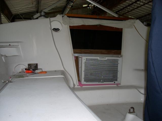

I use the very smallest 110v window unit($89) I could find and simply set it into the companionway with three carefully fitted slats on the top and sides to fill the gaps of the bottom two hatch boards. I screwed a small aluminum bar across the top to catch the ac on each side of the companion way so it just drops into place. It's 3y/o and still going strong.
I use a swim noodle under it and two rubber stoppers on the cross bar to deaden the vibration noise and tilt the ac aft so moisture drains into the cockpit. It makes hot summer nights bearable(frosty) and I then just leave it on the dock when we go out for the day.

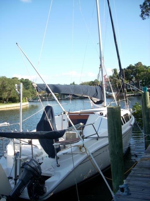

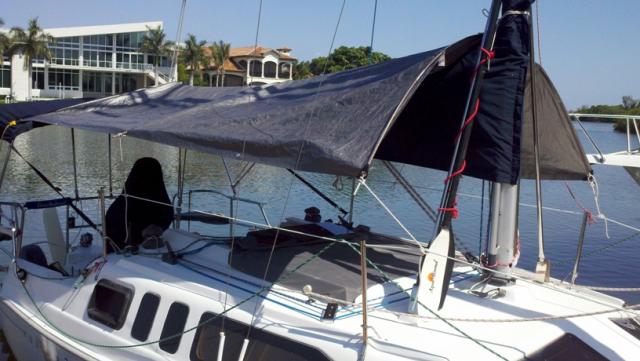

It's also a big help to try and shade the deck during the heat of the day so your AC dosent kill itself trying to keep up.

I use a window unit in an older 30. I mounted mine in the rear bulkhead of the quarter berth. I then set a fan at he front of the berth and one at the entrance of the v berth. It also helps if you have been out for the day and plan to tie up and run the AC to open the forward hatch and put up the awning prior to motoring in. This allows the forward motion to force out the hottest of the air. A hatch scoop would work better haven't got one. I also hang an awning off the boom.
On the dock I button up the cabin prop open the lazarette as wide as I can and still protect the contents and let it run. It won't do much on a day like today with triple digits but normally it drops the cabin to 70 within two hours.
