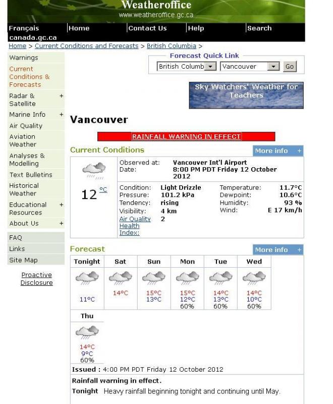

Just saw weather forecast (bottom of page) for Vancouver ................. I believe it :eek:.
