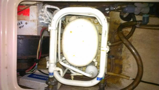

I just completed installing a Wasbasto look alike aircon on my friend's h280. Compressor located under V-berth where the hotwater tank is. Out goes the hot water tank. CW is tee off from heads intake. Discharge goes to the hull side within the compartment under V-berth. Condensate drain pipe to bilge through battery compartment. Air intake and air outlet is at two sides at base of V berth. Air outlet has a hood to direct air away from intake.
You do know that God invented the venturi effect so you do not have to have a wet bilge from the Condensate drain do you not?.:D
Yes I do :D I looked into one once, read feedback that it breaks easily ...oops! But if I found an SS one, will consider it. Dry bilge do smells a lot lot better. :dance:
