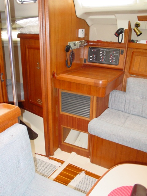

Our install has a duct above the return vent but there doesn't seem to be any short cycling. I've had this unit for 12-13 years. See the attached thumbnail pic.

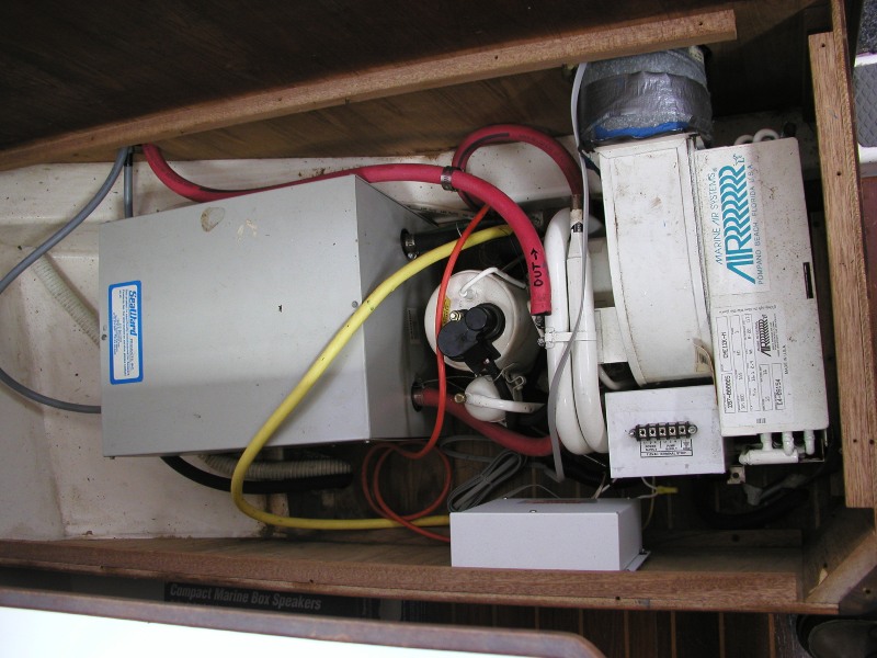

I installed a Webasto FCF 12,000 A/C reverse heat unit in my O'day 322 last summer. Since I did not want to give up either water tank, and both my settees have water tanks under, that left me with the aft hanging locker as the best spot (see picture). I ducted 90% of the supply flow forward through the bulkhead into the main cabin and 10% of the flow aft through a 4" round vent into the aft berth. Since I have almost no duct run, the blower airflow is very strong. I find the 12K is adequate cooling in the day for NJ for my 32 footer. Of course if I had canvas over the boat in the heat of the day, it would be even more effective but without shade it still makes it comfortable. At night the cooling capacity is way in excess of what is needed, and cycles very briefly to cool. The heat mode is amazing at 115 degrees at the supply port, very comfortable in October nights. I find my Westabo quieter than the Mermaid 9000k I had in the 27' I had previously. The prior comment on the temp sensor being a copper tube in the return flow is correct for the FCF models The digital control is just to set the mode and temp and fan speed (3 speeds + auto speed), not to sense temperature, so it can really be placed anywhere convenient. So far after one year, I am happy with the Webasto FCF. I put my out-water through hull about 2 feet high off the waterline due to not wanting to drill through the inner hull liner, but I am sorry I did not put it lower to the water line. It is quite inside for me, but a bit noisy for the neighbor on that side. It took me 20 hours over four days to install the whole thing: shelf, plumbing, strainer, electric, through hull, sawing duct holes, duct work, and about four trips to the store, plus three mail-order A/C suppliers for the various pieces-parts. It was a very tight fit in the cabinet. I enjoy projects like this. Not everyone would. Saves about $2000 installation costs.
