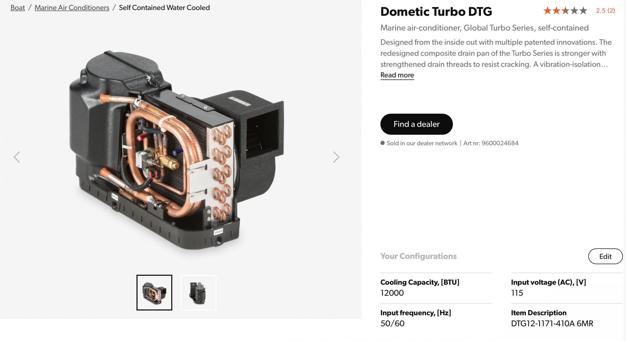

The Dometic 12,000 BTU AC unit that came with our Beneteau 31 Oceanis was always problematic
The new ones are great.
The key is the Space available.
Found on Dometic site, one key all made in USA.
Jim...
