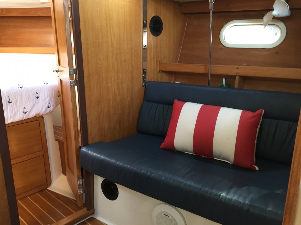

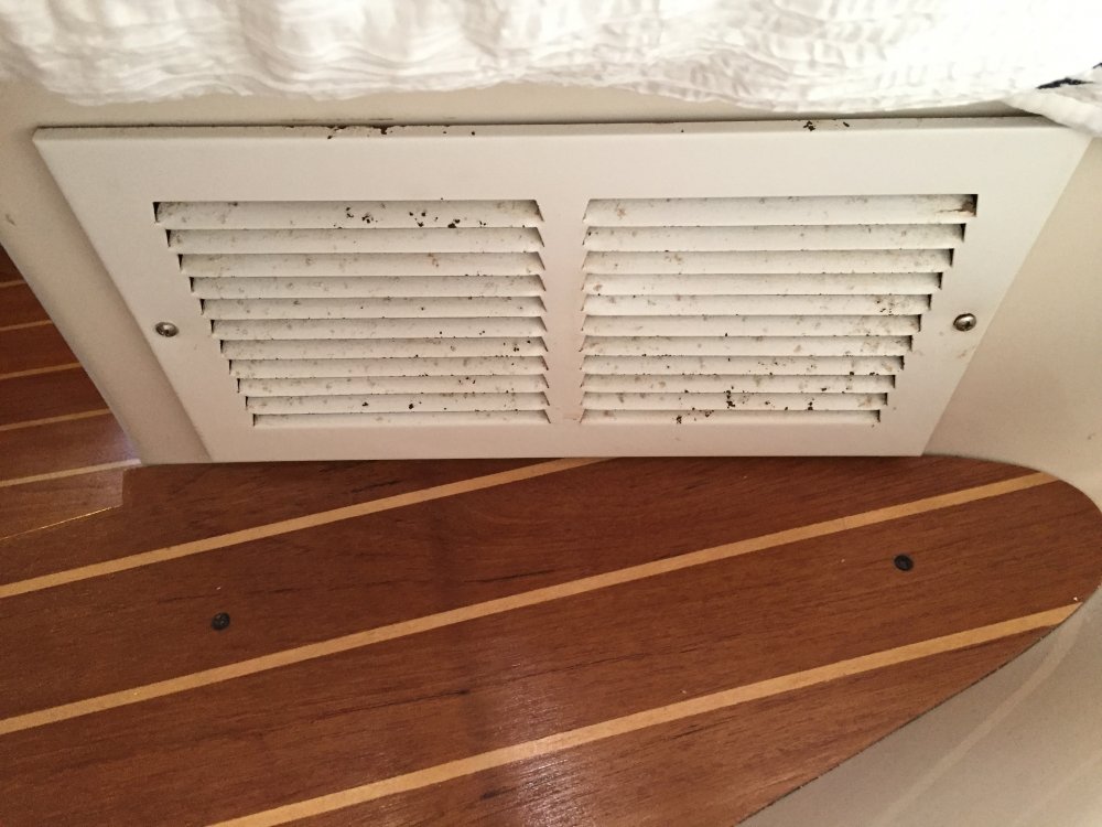

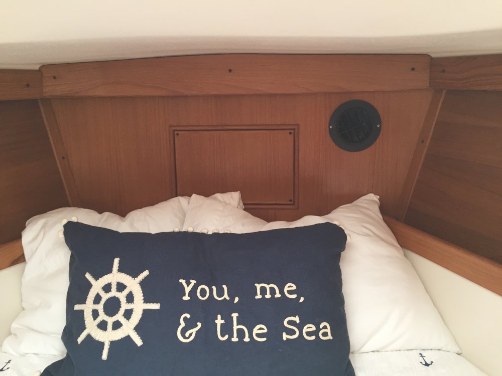

So, the thread is called air conditioner location 2, but if I am reading right it is your only unit? My A/C is under the forward berth forward of the water tank. Good access panel there and lots of room. As far as return air grill size, you can have two smaller ones instead of one large one. I have one on each side of the forward berth. I can take pics next time I’m out if you need them.

SV At last, you are right. I called the thread "...location 2" but it was only because the other thread didn't address some of the questions I had. At the moment I'm considering installing the unit in the port locker. The mainsheet article and "u0958901" seem to have done ok with the setup. Now, if you have pics of your unit, the base for it under the vberth, the two return grilles, the vents/registers and the ductwork; I could consider placing it there. Where are your thru hull for the raw water intake, ac water outlet and condensation lines? Pics would be great! Thanks!

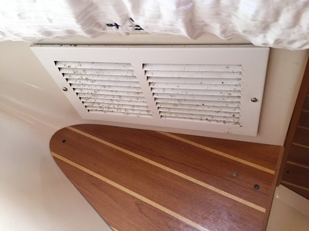

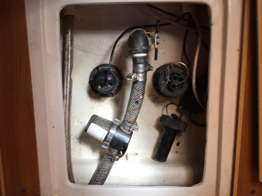

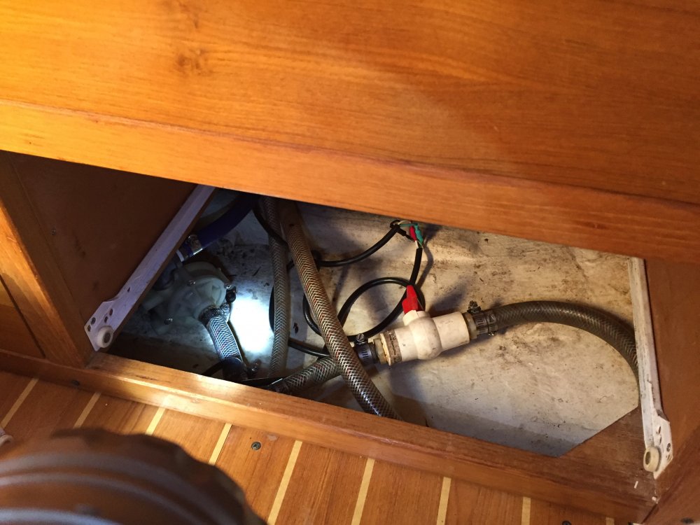

Ok, sorry for the delay. I don't have a schedule like normal humans. Got out to the boat today and of course had to sail. Here are the port and starboard return air grills. Getting a bit shabby need to be repainted. They are on the aft angles of the forward berth. The through hull for the raw water intake is located under the access panel aft of the berth and forward of the compression post. The raw water pump is under the drawers of the forward berth.

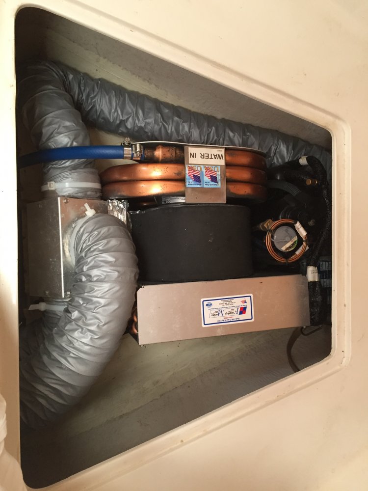

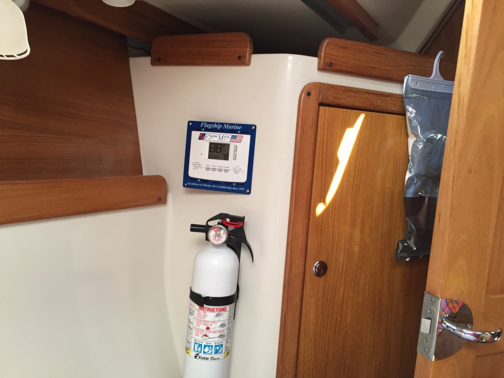

The actual A/C unit is located under the forward berth forward of the freshwater tank. My unit has three 4 inch ducts. One in the forward berth area and two in the salon. The thermostat is located in the forward berth in the hanging locker.

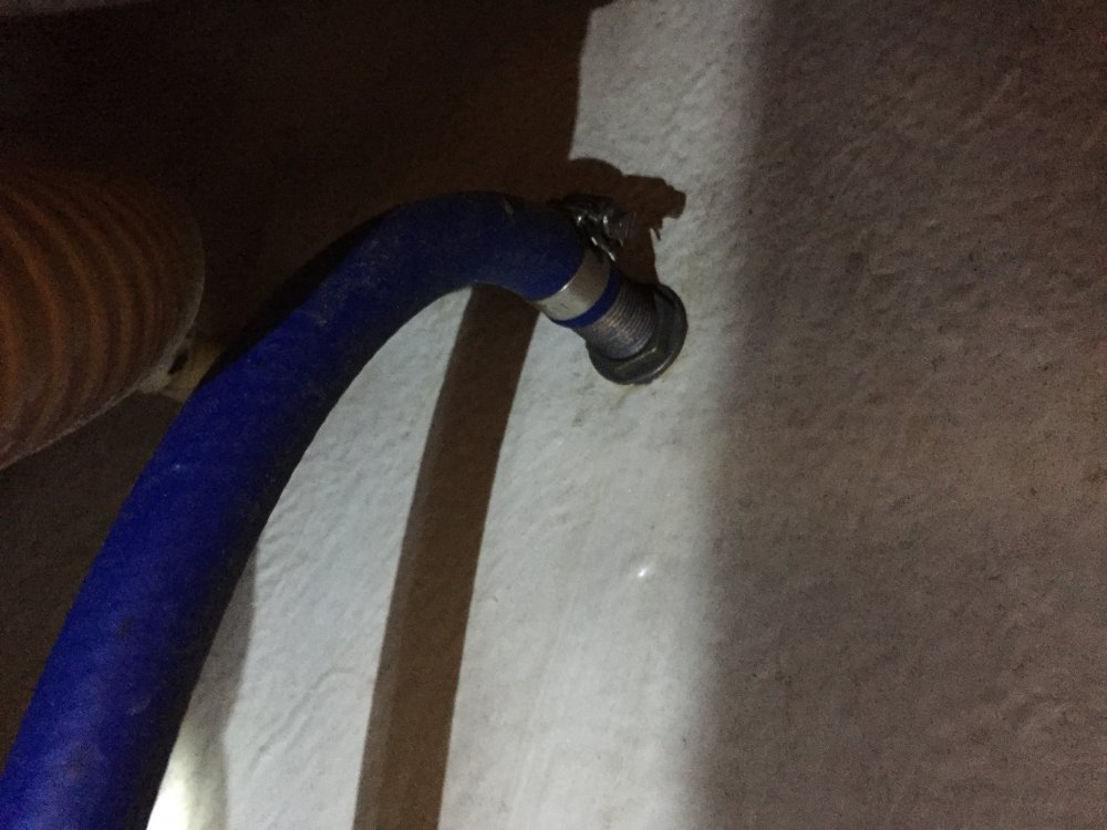

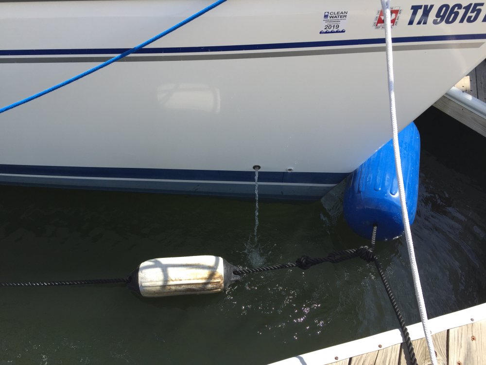

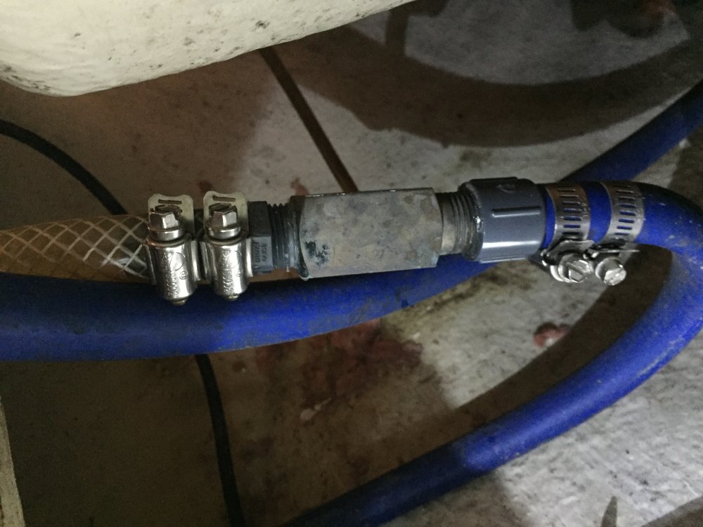

The raw water out is located next the the anchor locker drain. The condensate drain is connected to a Dometic condensate remover (check valve) that exits with the raw water at the bow. The picture didn't turn out very good. Sorry. Plumbing from the raw water pump to the A/C is under the forward berth drawers and fresh water tank. This was all previous owners work. Hope it helps.

My A/C sits on and is mounted to a glassed in plywood platform. Kind of hard to see in the picture.
