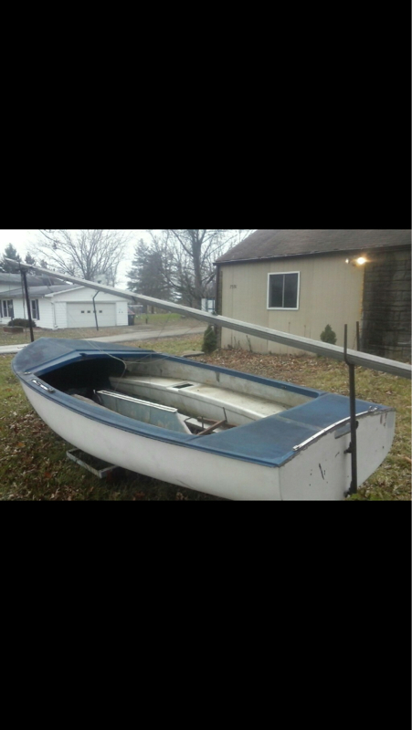

On the sailboat, look for the hull number and that should tell you. Could be any for four lmanufactures to include for the age, American, Capri, possibly precision. Who knows. Is there a registration on it and what are the state numbers on the bow and that should help
