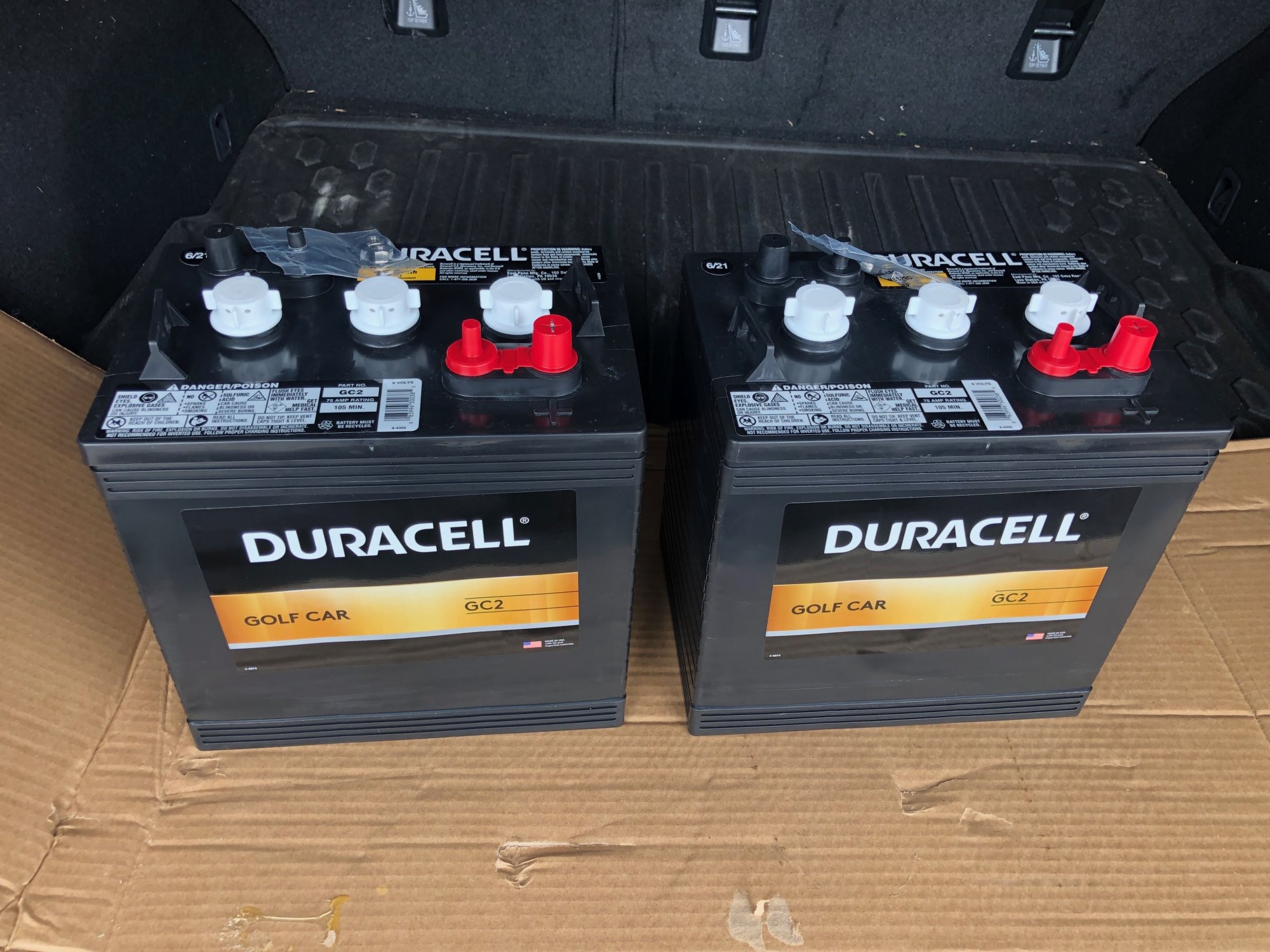

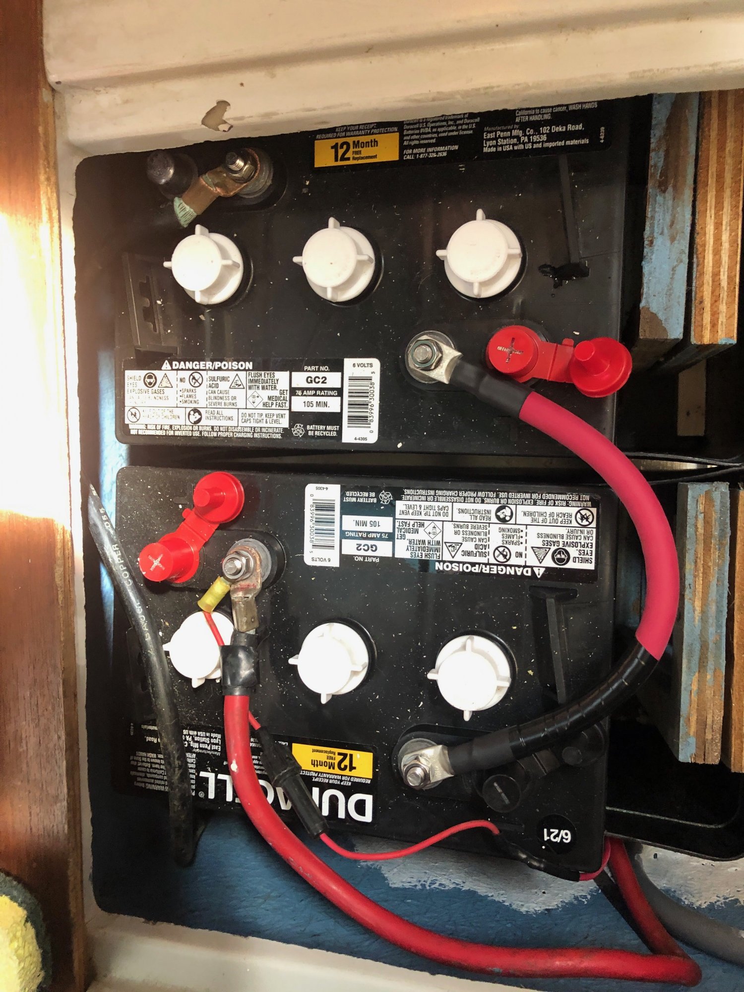

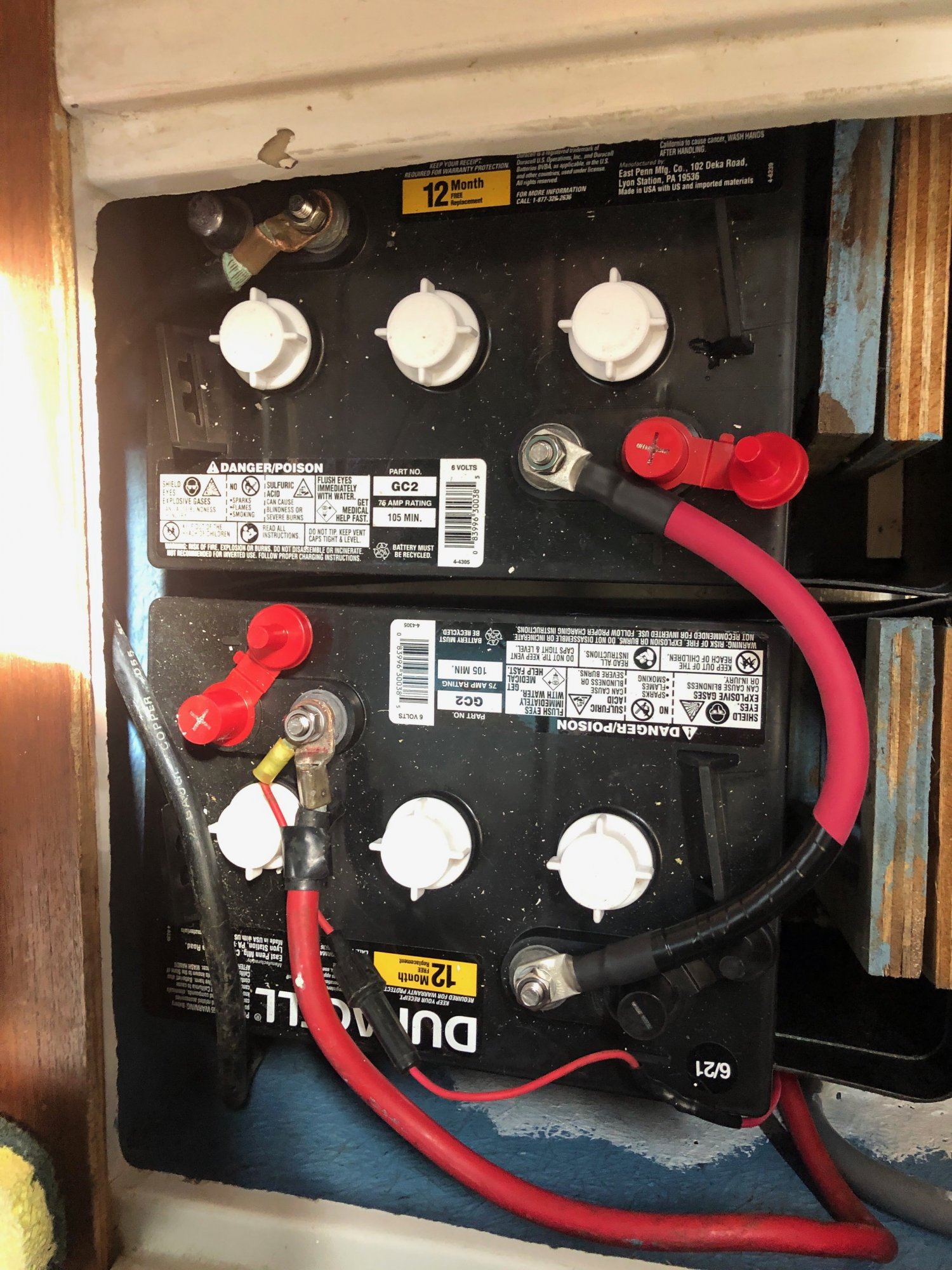

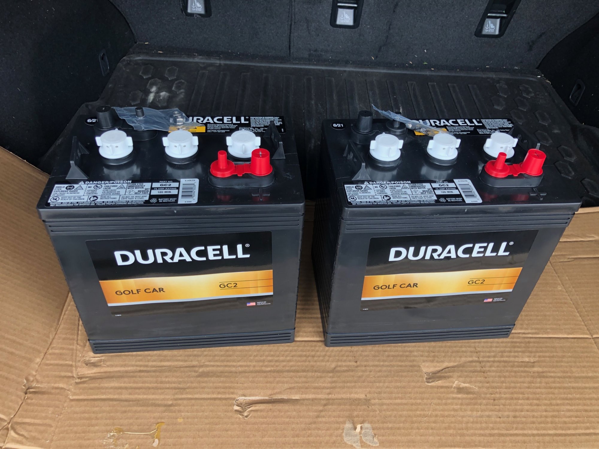

You AGMs have served you well. If you really want to go cheaper, I bought 2 6-volt 215 AH Duracell GC batts from Sams Club… ~$100 each IIRC.
Seem to work great so far…and cost effective.
