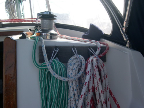

Here's a photo that may help
Attached photo was taken to prepare for fabricating a new board for hanging the lines on the bulkhead. Hope this explains it better. The four lines are, left to right, first reef line, main sheet, main halyard and traveler. (All but the traveler go thru rope clutches.)
