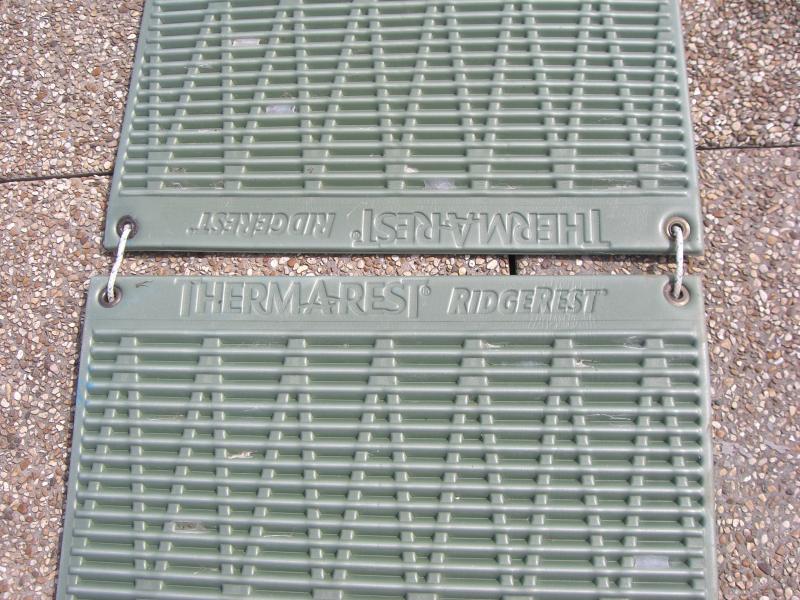

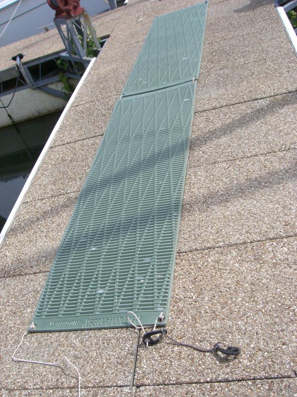

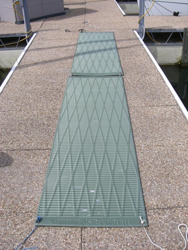

Under the search heading, you will find this text:I fabricated a "slap damper" for our H356 out of two closed-cell sleeping pads from Cabela's/Bass Pro Shops. I installed brass-coated grommets in all four corners of both pads, connected the two pads long-wise using these grommeted corners thereby creating one long rectangular pad and then fitted this elongated pad to the boat, snugging it up against the rudder post, with cords attached to the to the four remaining corners and tied to the stanchions. Works like magic!
Good luck.
