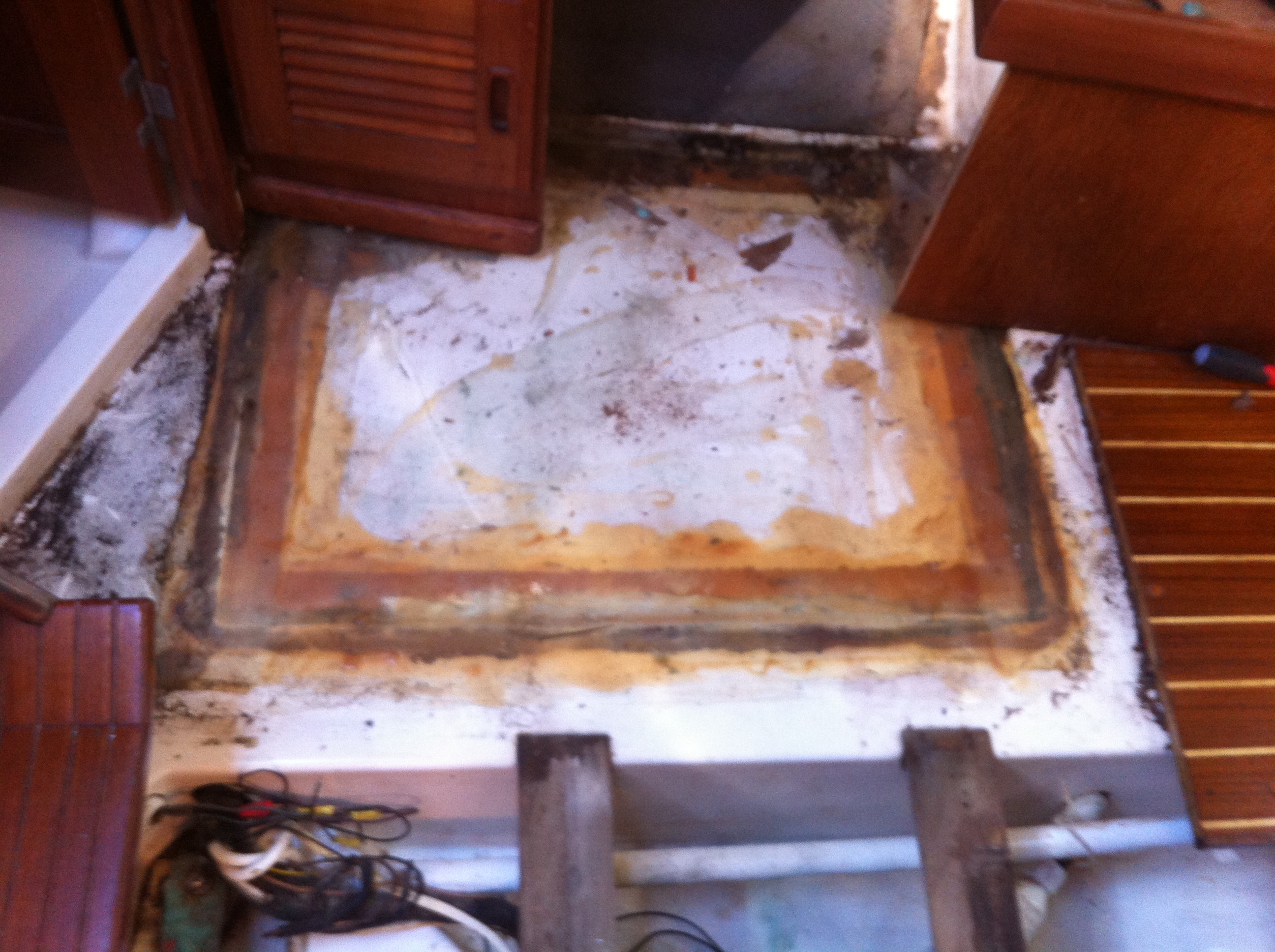

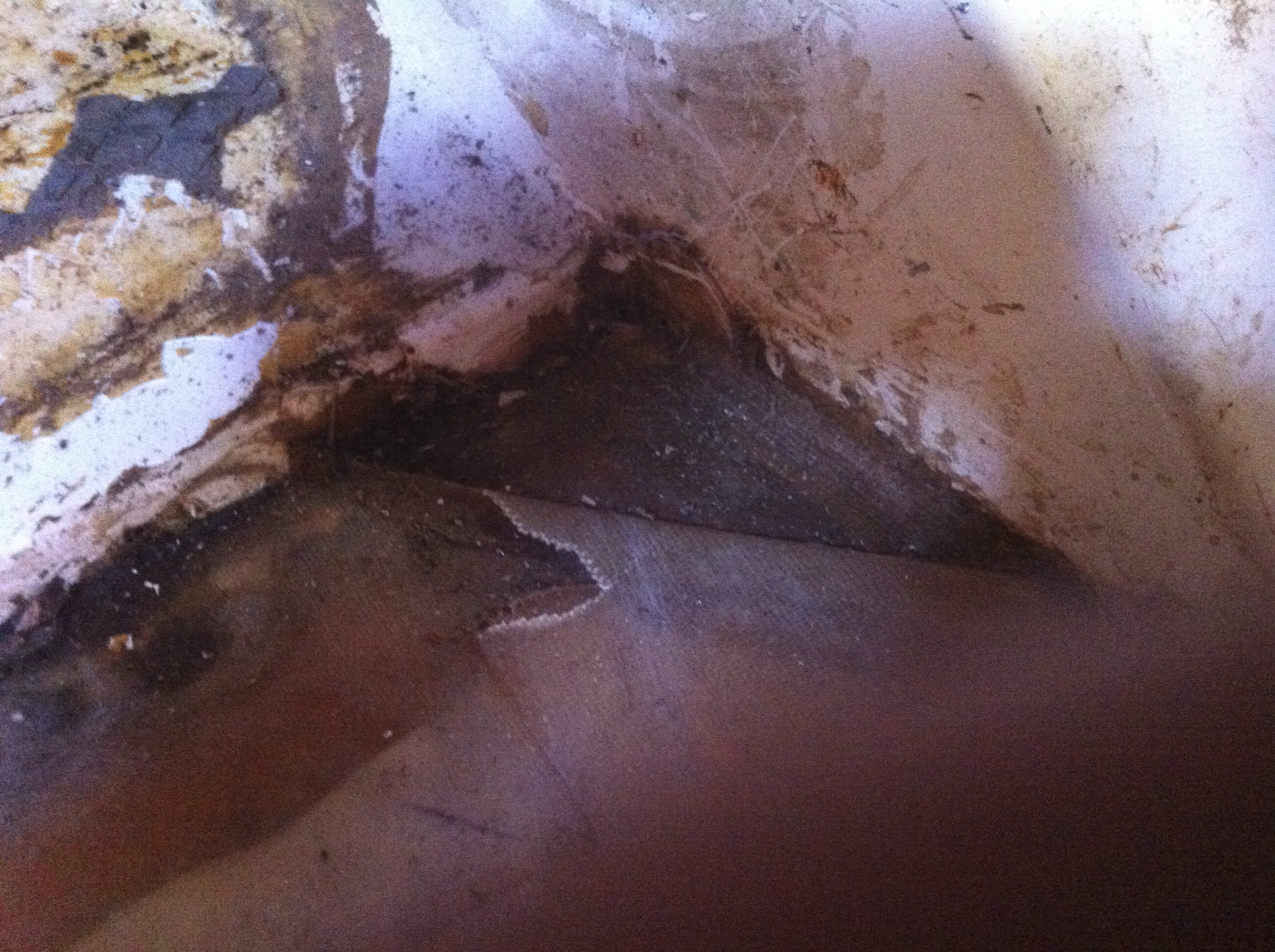

Hi Jo Anne, I have repaired my aft holding tank , 1986 Hunter 40. The tank is a built in fibreglass housing with a 'glassed on top. To effect a reliable repair you must remove the sole in front of the chart table/aft head to gain access to the top of the tank and the sides of the seat and cupboard under the chart table (see image #1). If you look closely you may find areas of fibreglass holding the tank top on have let go allowing smells to escape. In my case a corner of the 'glassing for the tank top had not been attached and was folded back (see image #2)! I ground and cut out these areas and re-glassed the top of the tank…. no more smells! Replace the sole and and other panels and away you go.
