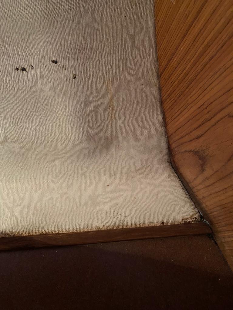

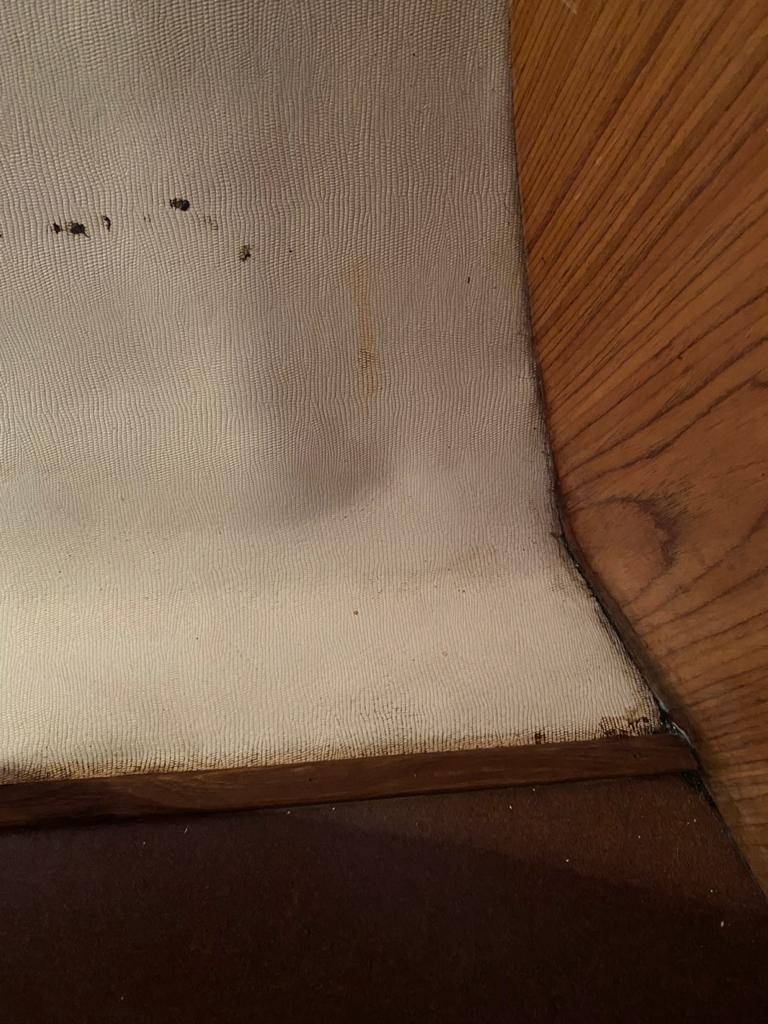

Hi all,
Our 2000 Hunter 460 aft cabin that we just purchased appears to have a leak that I noted while changing the sheets on the aft starboard cabin in the corner aft where the wall meets the bed. The sheets and under the bed were damp. We did have a recent hard rain but looking at the damage it does appear to have been going for some time. Thoughts?

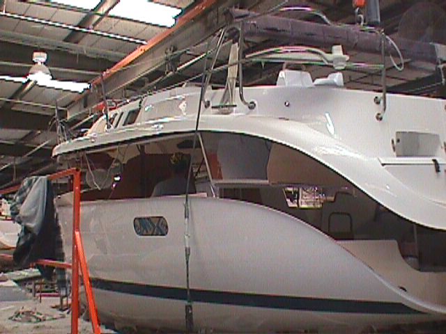

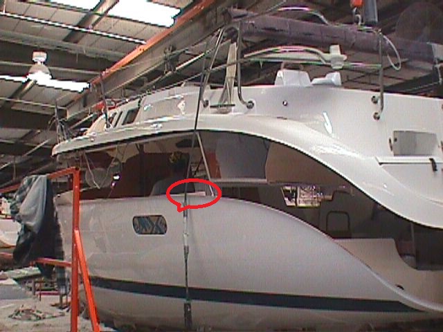

Check your rub rail along the area. On my 2000 340 we had the same leak, same wall covering, same area.
That wall covering goes right up to the edge of the hull/deck seam and acts like a sponge.
I had to cut my wall covering away from the seam and applied a bead of clear sealer under the rub rail to eliminate the leak.
Could be something else, fix window seal etc. But check as high up as you can. From your picture, the area and look are the same as ours was.
You are showing only the bottom area, but is there an access panel above on that wall with about 20 screws in it. If there is, remove the panel and that’s where you will see the deck/hull seam.
My guess, had to be the same guy on the job back in 2000. It’s too identical.
