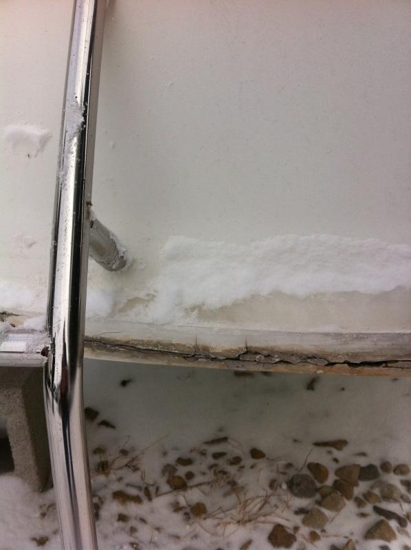

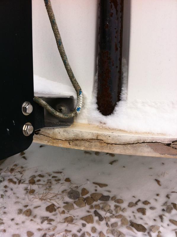

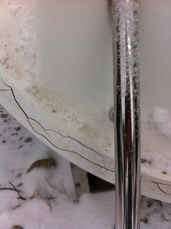

My '93 had the same crack and was repaired about 10 years ago. It wasn't as big as yours, but i presume the repair would be the same. It was gouged with a dremel as deep as the crack went, which was about 1/4 inch in my case, and filled with resin. No issues at all since. The hull isn't cored, so there shouldn't be any hidden, more serious damage, but now you have a bargaining point.
