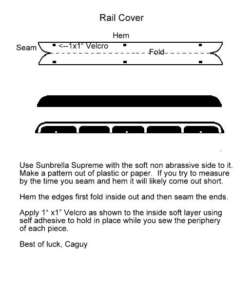

I like the clear gloss Cetol even if it doesn't have the UV protectants. I don't like the yellow tinge of the the Cetol with UV protection. I made some Sunbrella covers for mine to protect them from the sun. I made them with a special Sunbrella call Supreme. It has a very soft texture on one side and the Sunbrella canvass on the other. I used 1"x1" Velcro to secure them between every other rail support. they are easily removed with just a tug, or secure enough to leave them on when I sail. I also extended the a cover that was on the cabin roof to include the slider rails. It also drops down into the cockpit to cover the companion way teak rails and hatch. It's been a year since I varnished them and they still look like new.

Here is a Drawing of the Rail Covers
I am posting this because it seems like such a logical and simple way to protect rails. I have not seen them on any other boat in my limited experience. They are easy to make and will save you hours to sanding and refinishing your rails.

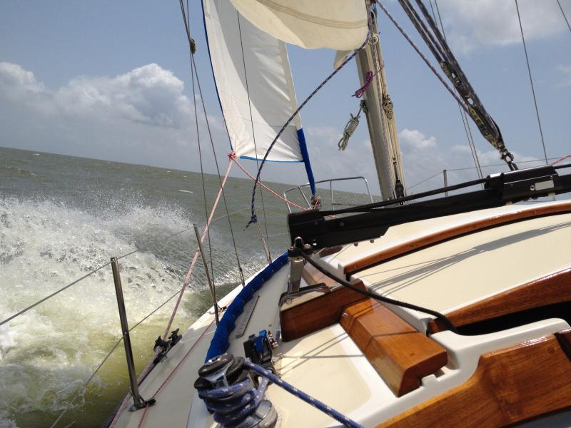

Personally, I like the Cetol Natural Teak look with a few coats of Cetol gloss over the top. This photo is not long after I did this years maintenance coat which is just scuffing it up with a Scotch Brite pad and putting on another coat or two of Cetol Gloss about once a year. I started with bare teak about three years before this photo was taken.
Specifically, though, in the picture you'll see that there are Sunbrella covers over the grab rails. I find that they are so difficult to keep looking good (because of all the curves that are hard to keep looking good without removing them from the boat) that I just made up the covers for them and I rarely ever take them off. The reality of the way I use the boat is that really I just lock my foot against those "grab" rails when I'm on deck reefing (or just passing through) and I haven't found that having the opening blocked by the Sunbrella to be a problem at all.
