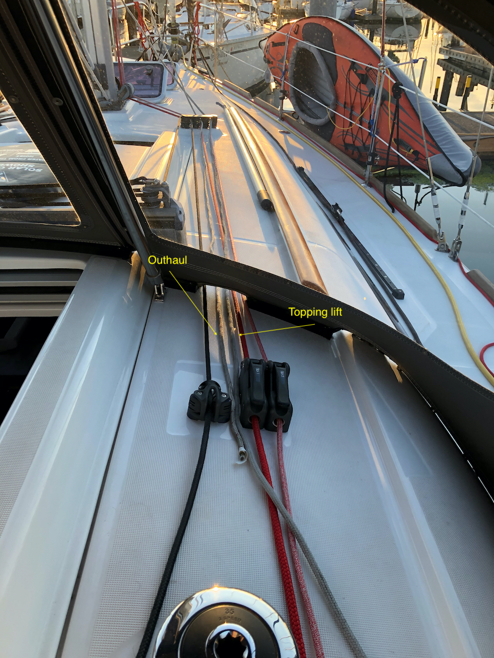

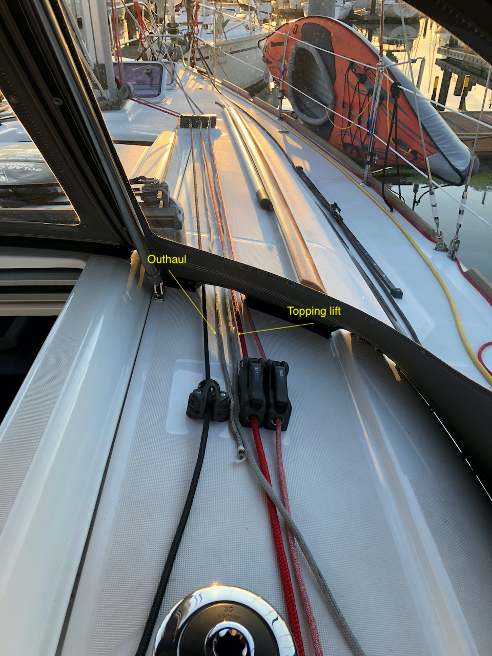

On the models with roller furling mains the outhaul is brought back to the cockpit and secured with a clutch there. There’s probably already a solid glass section of deck in front of the cockpit to make installation of clutches easier.
This is the starboard side; our outhaul is on port, but same idea -
Likes: sail sfbay

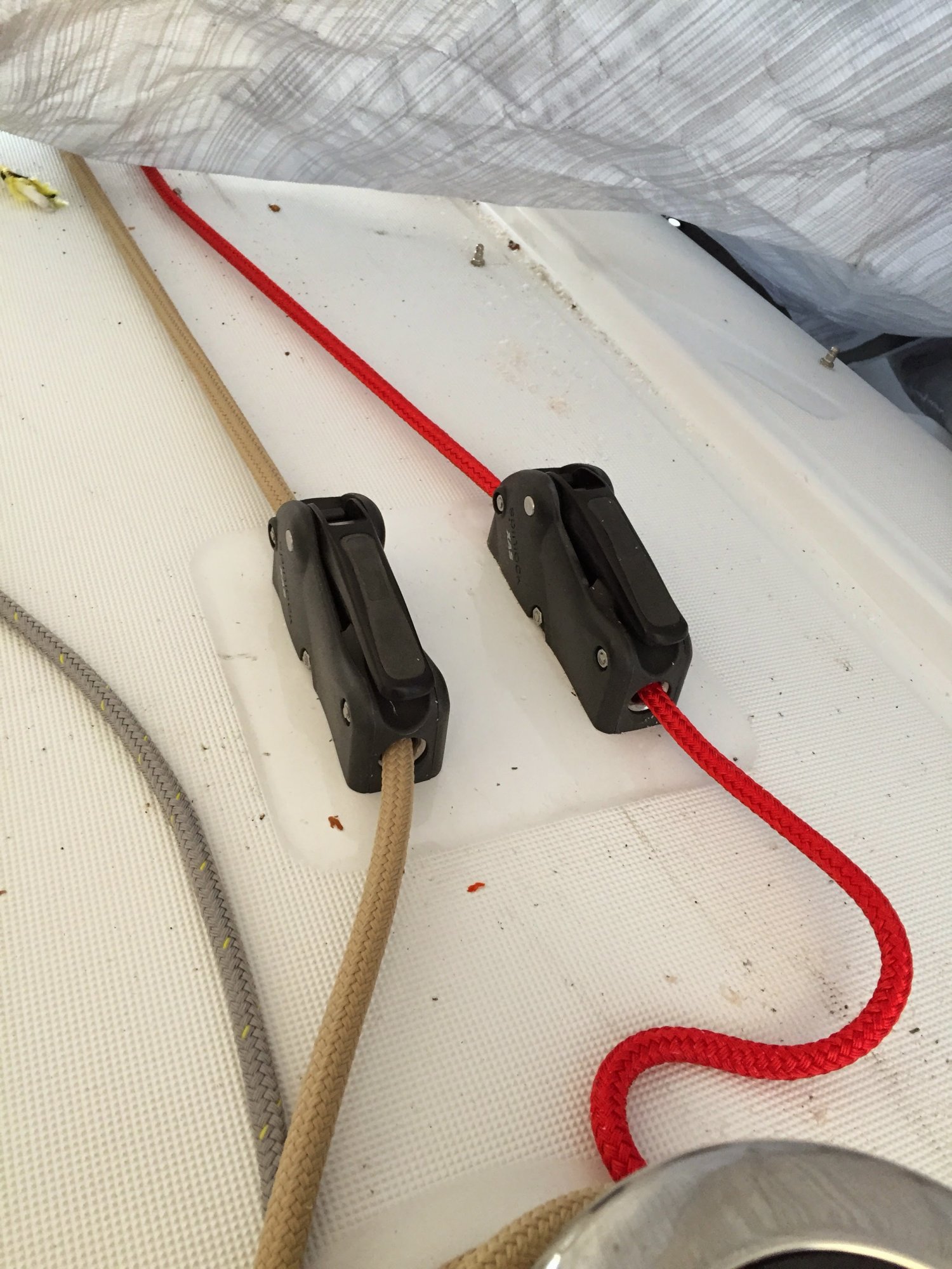

I have a conventional main, with a bit of a strange arrangement for the traveller, which occupies one spot in the area on the cabin top. I'm not opposed to replacing the cam cleat that is being used for the traveller line, but if there is a smaller pair of cleats that could handle my two additional lines, then I'd prefer to go that route. One obvious partial solution is to move the spinnaker halyard to the mast, but I'm really trying to move lines off of the mast, not just swap one for another.
(Topping lift is the grey line, the role of the outhaul in this photo is being played by one of my lazy jack lines.)

On mine the cams for the traveler lines are integrated into the ends of the traveler itself. Downside is that to control the traveler you need to stand in the conpanionway and keep the dodger zippers open a few inches. But it does free up the space where you have that extra cam.
My spinnaker halyard is led back too, but I think I would actually prefer that one to just end at the mast. My spinnaker has a sock, so usually I hoist the sock first and need to be standing on the foredeck to see when it’s all the way up. Also when we’re not sailing we store the halyard on the bow pulpit, and bring it back by the mast only when we go out, to keep it out of the way. Each time we move it we need to walk back and forth to the cockpit. So having the clutch for that one in the cockpit is more out of the way than anything. Depends on how you run things though.
