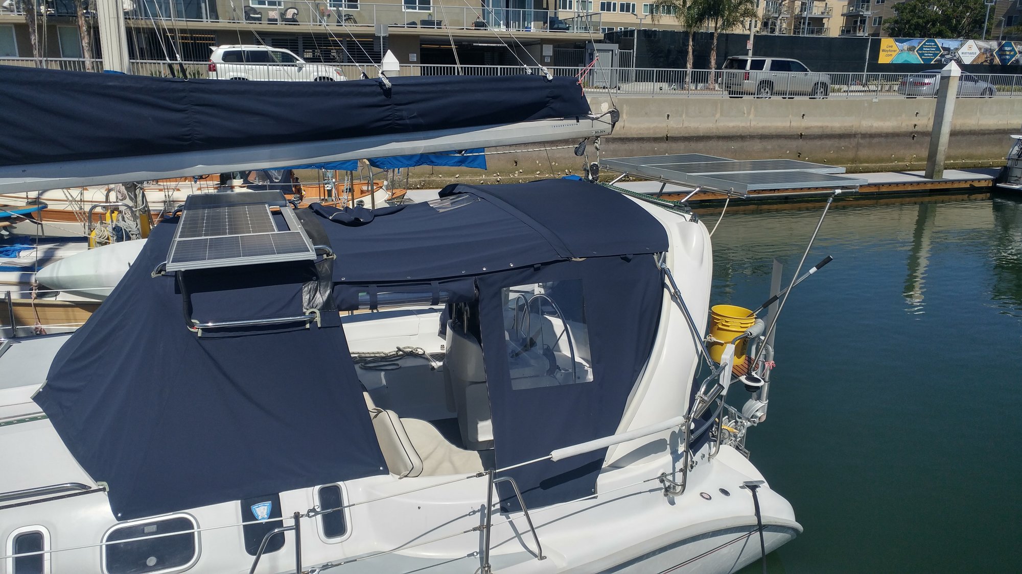

My 99 410 has panels (hard) behind the arch 380w and another 200w on the dodger. Each with it's
own controller.
My dodger wiring runs inside the dodger, then under the deck where the little start (50w with controller now) panel is. Once under there it goes through the conduit to the nav station along with the start panel.
Then they go down under nav seat to the batteries.
You can see on the left corner where I tucked them into the dodger.

My 99 410 has panels (hard) behind the arch 380w and another 200w on the dodger. Each with it's View attachment 199762own controller.

At anchor, move the boom accordingly, sailing, its hit and miss as you can guess, it can change depending on course and sun angle through the day.
But, they're always putting out something,
If you have enough panels up I wouldn't worry about it. 580w total usually puts me at float by noon or 2pm.
Even with some shading, my 200w on dodger will easily put 3 to 6. Amps out, covers my use and sure is better than having nothing on the dodger. If you look at the photo, you can see only 1 50w panel is shaded at the dock, the other 150w are clear.
