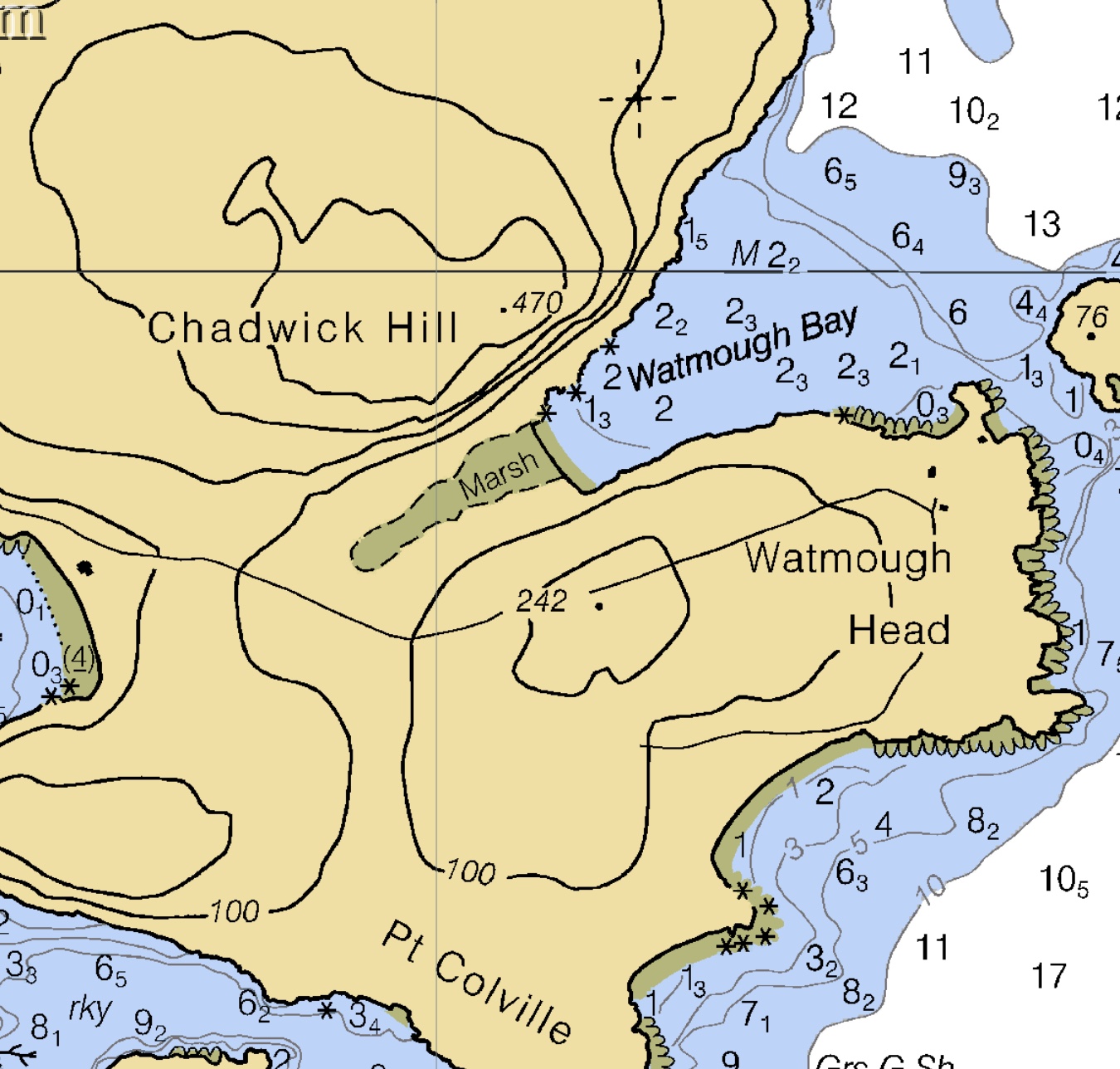

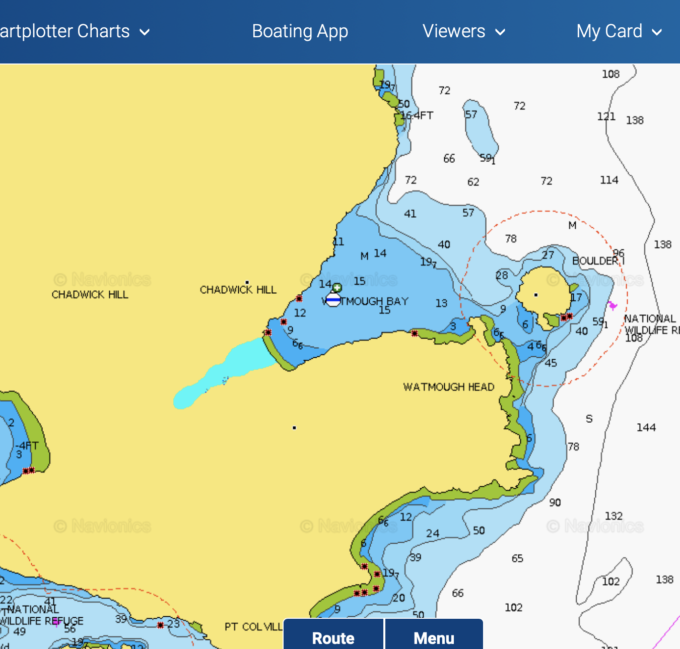

I like the Raster charts too, for the reasons you mentioned, John. From Cabo San Lucas to Alaska, the coastline of western North American presents chiefly a rocky shore, with intermittent exposed beaches and a few large estuaries. The offshore islands are rocky as well as are many potential shelters north of Pt. Conception, and especially north of Bodega Bay. So going in someplace to anchor, particularly if remote, typically means nearing a rocky shore to gain shallow depths where there could be surge. In some examples you may be only a couple of boat lengths out. So DETAIL is very important; as much as can be had!! Very different than anchoring inshore of sandy barrier islands in quiet and roomy estuarine settings, as in southwestern FL.
23,143
The difference is significant if your examine the charts.
ENC.
Shows depth and contours of the area (in this case Watmough Bay on the SouthEast end of Lopez Island).
Is this a good anchroage when the Coast Guard weather reports a SouthWesterly storm forecast to blow in at 02:00?
With out local knowledge the chart is not very descriptive.
Here is the Raster chart of the same bay.
The raster chart suggest you could be in trouble. The hills to the SW of the anchorage would funnel winds over the island down the valley between the 2 hill contours shown on the raster map and directly into the anchorage.
This information is why I prefer Raster charts when sailing into areas of new discovery.
