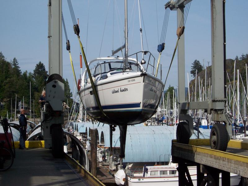

And, for everyone's sake,(including your wallet & sanity), make SURE the aft lifting strap is clear of your propeller shaft BEFORE lifting.............................from experience.
Good Luck

In addition, mark your lift points with temporary black crosses of electrical tape which can be seen from above. You should see (if they haven't been removed by now) small labels on the hull (just under the rub rail) labelled either lift, sling, or something similar.

I like what FFT & Ralph say about bent shafts & proper lifting locations, It happened on my first ever haulout. I now keep a C30 lifting point diagram on my boat to show the yard what lifting locations to NOT use. I also use tape markings to cut down on mistakes. I stand at the stern to make sure the strap is forward the shaft log.

My C30 has only 10" approx. from the rear keel edge to where the shaft exits the hull. This means the strap has to be held against the keel and the strap top cable has to be moved forward. So the strap is at a 15° angle, so it doesn't slide back onto my shaft. So my configuration does not allow much room for proper lifting. Hopefully, your configuration is better.
